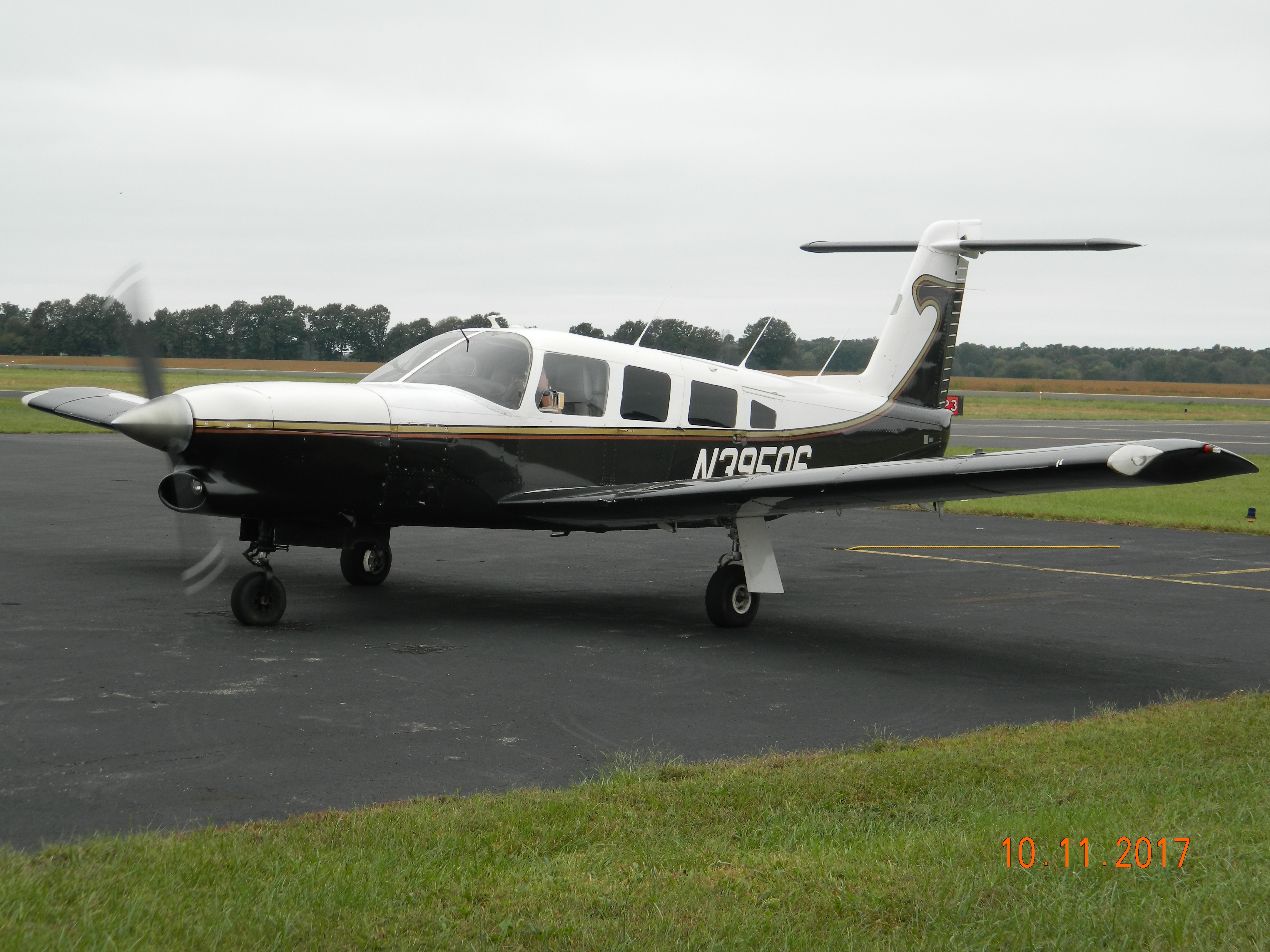

My new/old Lance II
I started with a PA28-235 and loved her for 12-years but always wanted a Lance...and got N39506 about a month ago...getting to know her is amazing.
  • That is one beautiful airplane. Nice paint, great photo! May you have thousands of fun hours flying this bird around the country! :)
