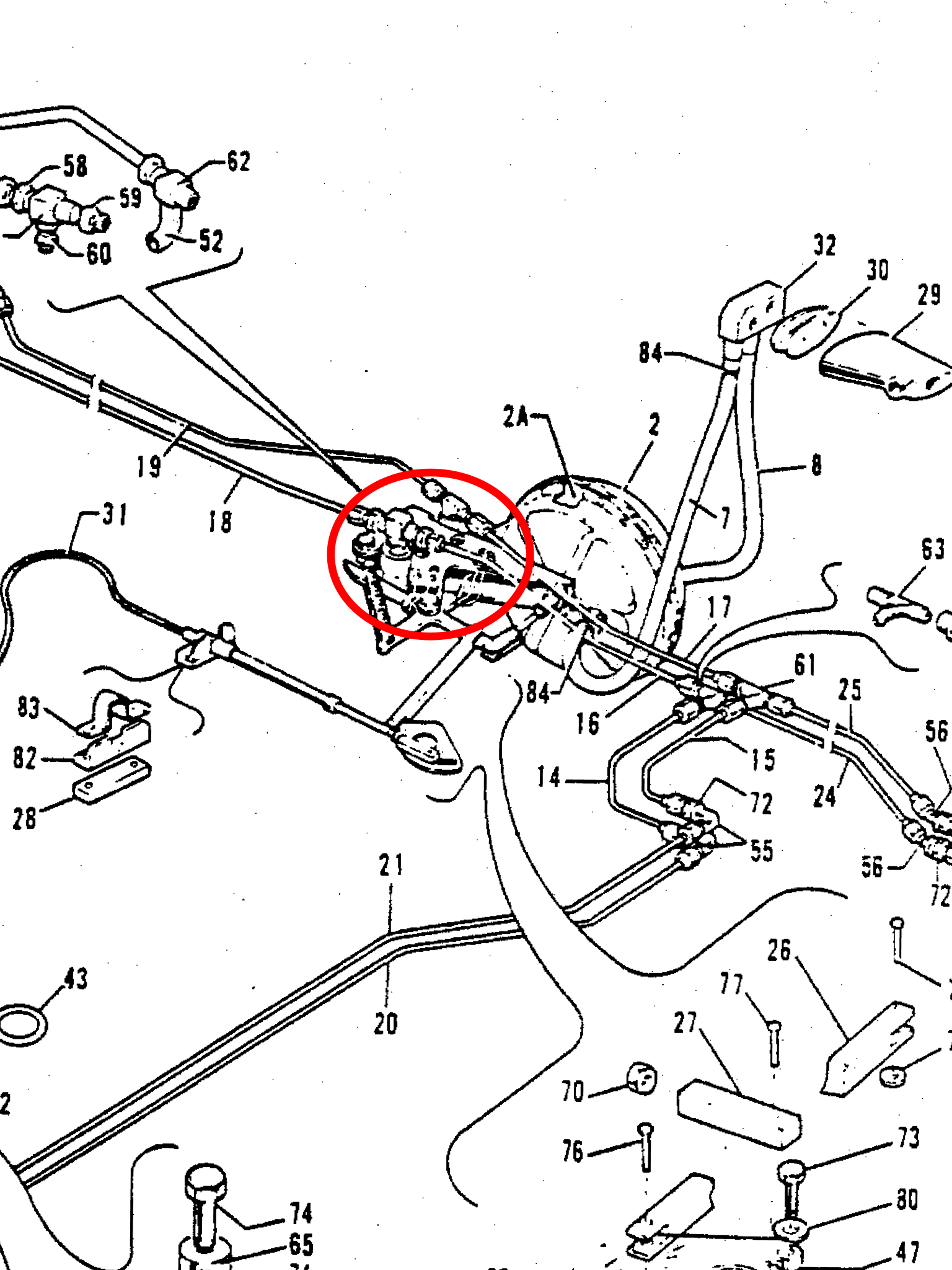

  • davelance thank you for the info. Is the "hoof valve" where all the landing gear hydraulic lines connect in the back up landing gear extender?
    Shawn Gehres
    s.gehres64@gmail.com
  • Yes, I believe that is it in the diagram.
    It is hooked up to #2 that pulls it in and out depending on the airspeed.
    The hoof valve is no longer available (it is named hoof as the was the name of the company that made it) They are no longer in business I understand.
    You will not find a parts break down for it as piper sold it as a unit and claimed non repairable.
    It was very difficult to get those part numbers as piper did not want to give them out.
    They are very easy to replace though I am told by my shop who did it once I got them these numbers
    Good luck
