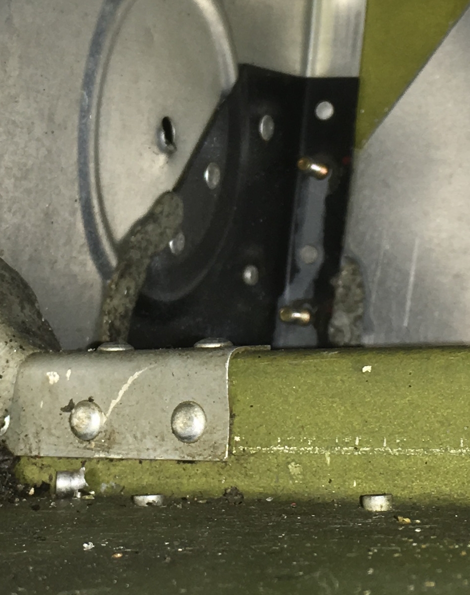

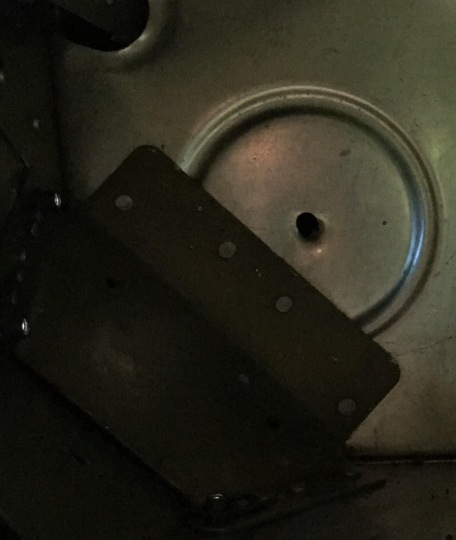

    You should not have to go all the way in the tail cone. I was able to reach it from just behind the access hole. I had to remove the battery and battery box then you can stick your elbow, forearm and hand down between the control cables. Once you reach below the cables rotate your arm toward the step attach points until you feel a lateral bulkhead. The two bolts on the back of the step are behind this bulkhead and the other two bolts are forward of the bulkhead. Here is a picture, Look closely at the black triangle plate. I had pushed two bolts through the holes so I could tell where I needed to try and reach. You should see two Goldish colored bolts without nuts on them:

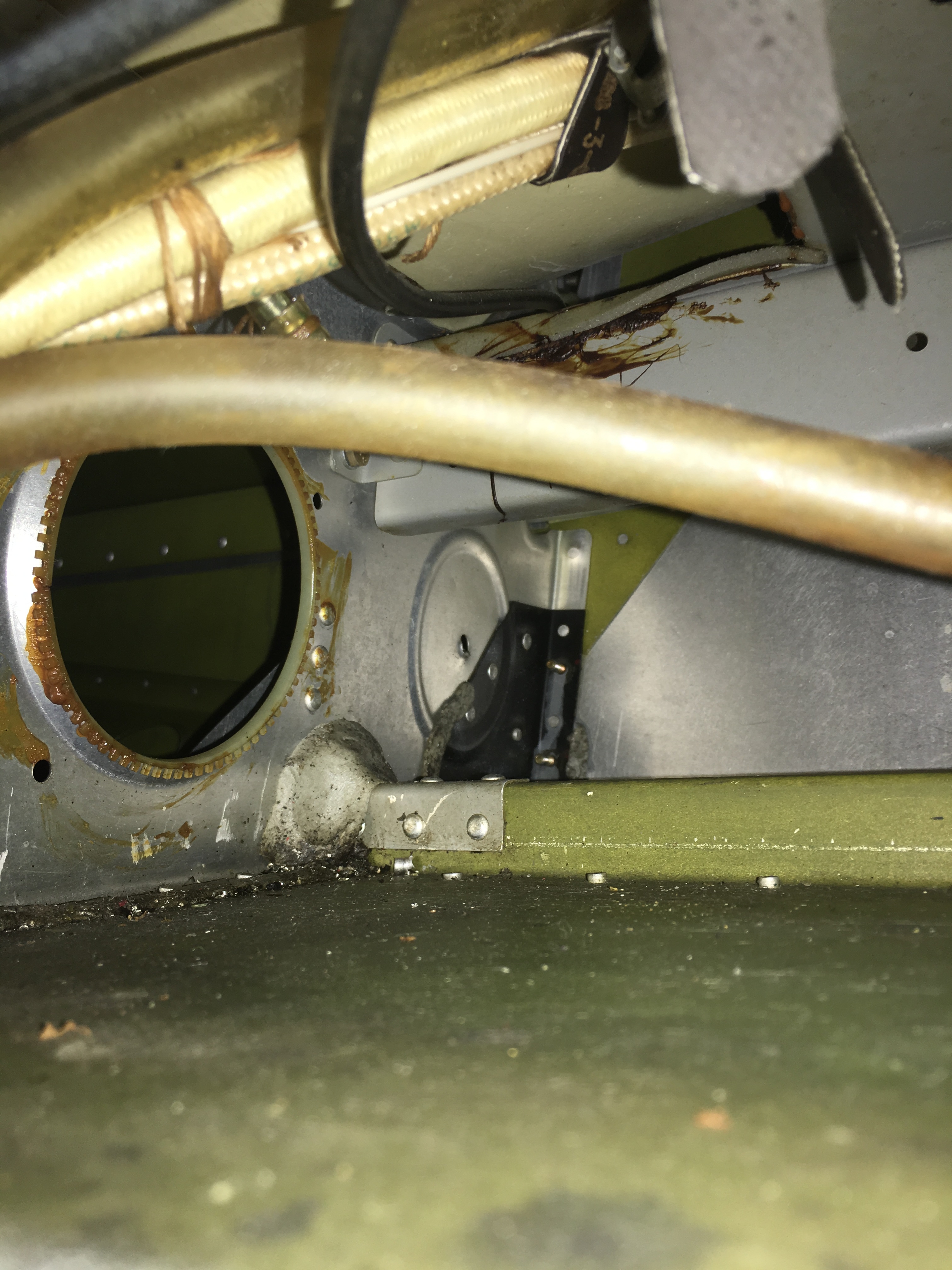

    Here the two forward bolt holes show up as the white spots on the left. This is the forward side of the bulkhead, accessed through an access hole in the floor of thebaggage compartment:

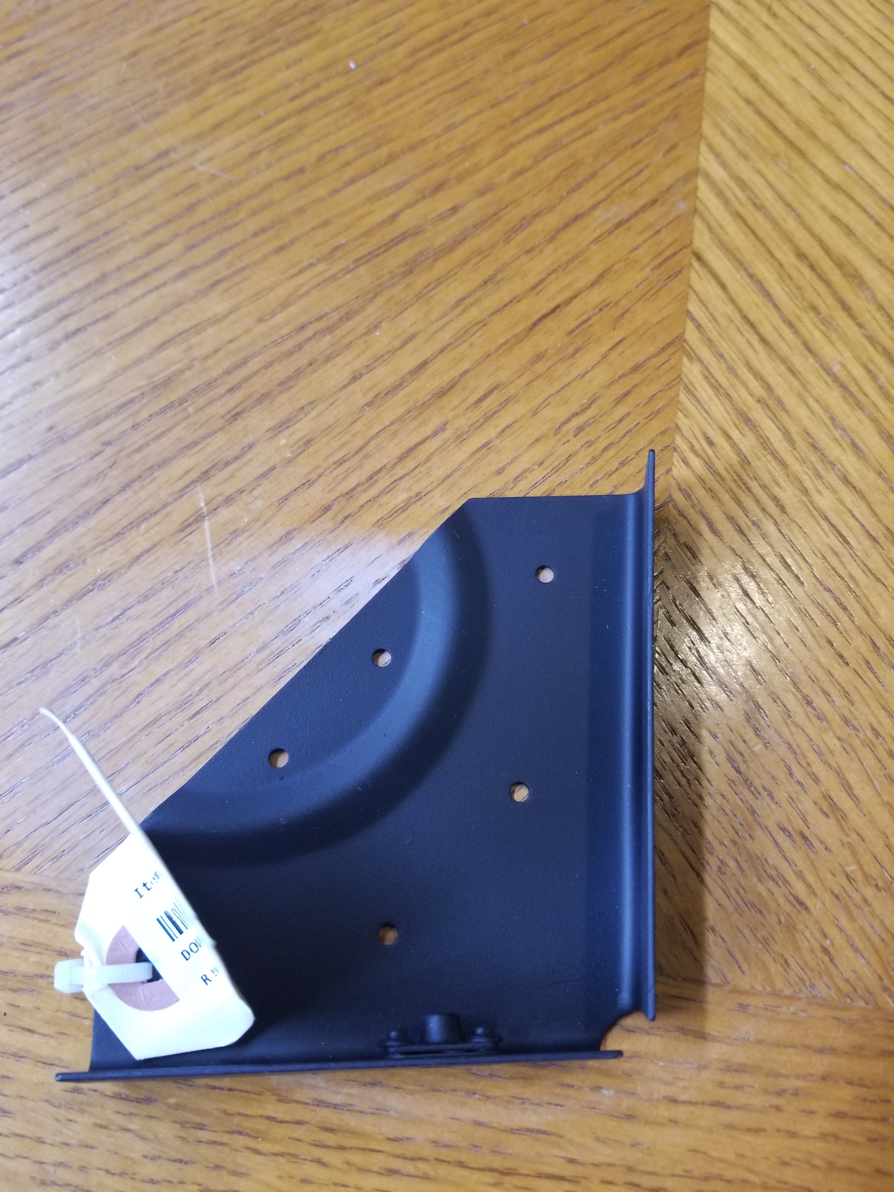

  • Hello all, I'm new here, but I'm restoring a 69' Cherokee. I would suggest that if you're doing step maintenance always look at the supporting bracket. I had to replace mine due to a crack and corrosion. I don't believe that's looked at on an annual. The junction between the aluminum and steel should always be primed (at least), and maybe use an aviation approved sealant such as PRC 870 B 1/2 ,as well (to reduce any chance of galvanic corrosion). The part number for the bracket wasn't in the IPC, either (I don't know the p/n off hand- if you need it I can find it). I'd imagine it's probably the same for most Pipers.
