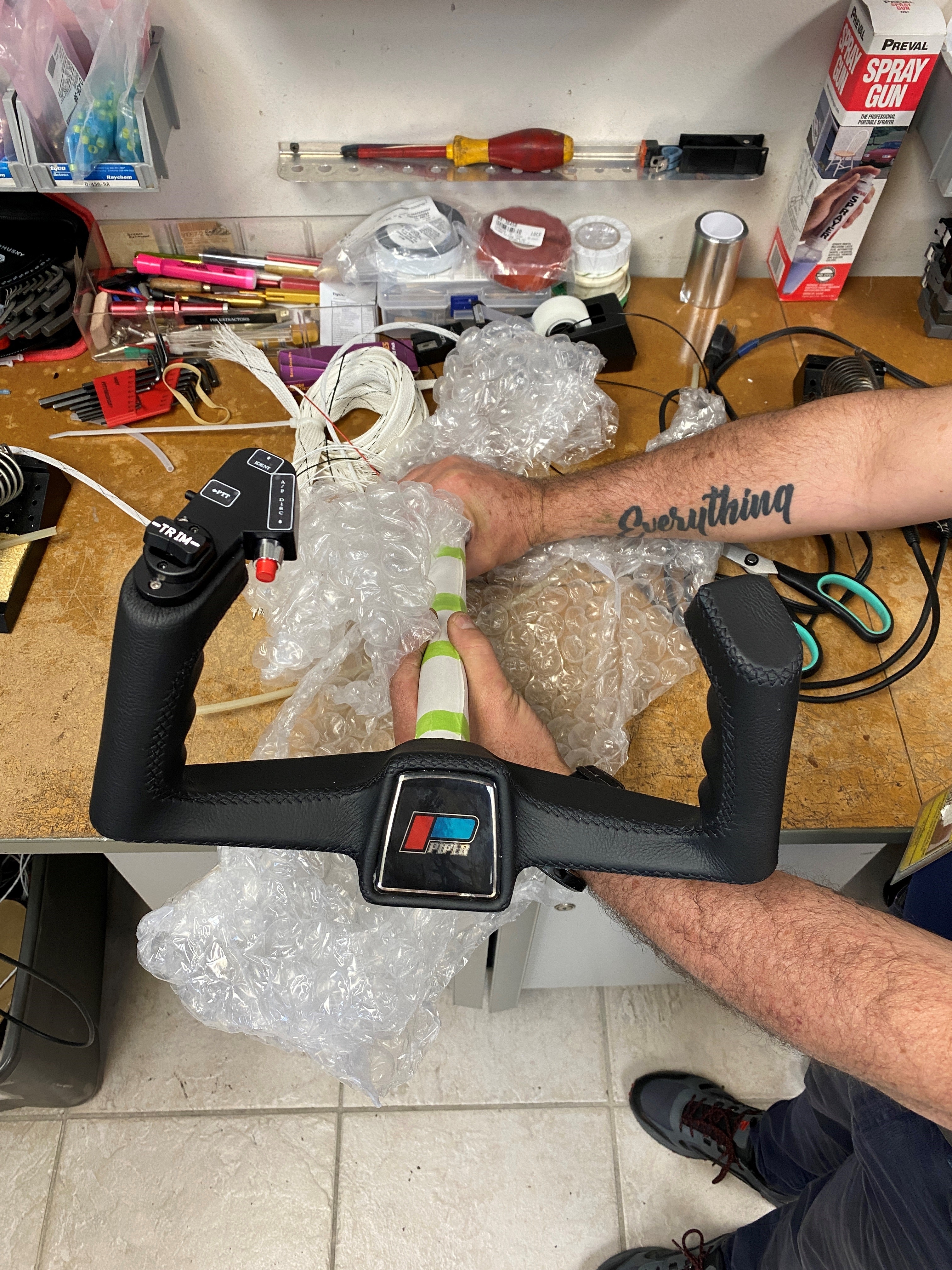

  • Just got my yokes back from yokes up (thanks Scott for the recommendation) and love them
    . (picture has old piper center emblem)
  • edited April 11
    They're amazing. I'm getting comments constantly on mine, too. I'm glad you like yours!
  • edited April 11
    Question about the Piper logos. Scott's are embroidered and lkstarcher's are OEM like.
    are both removable like OEM (AKA glued on)?
    Seems like they need to be removed to run the wiring?
  • When they arrive they are not on the yoke. You put them on with a drop of adhesive on each side. Easy as pie.
  • That's easy enough... My pilot side had to come off when the Pitch trim switch needed to come out for a minor repair and it was noticed that the wiring was not correctly routed and could be easily damaged.
    My piper logos are looking a bit shabby so the leather embroidered logos would be a major improvement.
    Scott, did you send the logo plate in with the yoke to be covered with the embroidered logo, or did they supply a correct shaped plate?
    My annual is due the last week this month so I plan on pulling the yokes just before the annual starts, which seems to take my IA about a week or so to do... should work out well, consolidating downtime.
    I think I'll Cerakote the cover and switch plates that week also. All this will really clean up my cockpit. I'll add my pics when it's all done.
  • My yokes came with the same Piper center pieces. They are leather with stitching. Yokes Up buys them in quantity.
  • Yes, same here.
  • What do/did you both do with all the cables that route through the yoke column? My pilot-side yoke has a 10 conductor cable (autopilot, trim, PTT, etc).

  • Hi Jim,
    Next time I go see my plane I'll find out for you. Stand by.
  • All the cables are in one sheath running under the left part of the yoke to the shaft of the yoke. Will post a picture tomorrow after I go by the plane (still under construction).

  • picture of the wiring.
  • Ok, thanks. In my Arrow all the wiring for both yokes is internal to the column and exits through a hole in the column just ahead of the "U" joint where the columns meet the control "Y" . Hence my stifled ability to have the control columns re-chromed :(

  • That bundle goes through the column, correct? Is there a BIG in-line connector under the panel where the wiring bundle is split out into the various places it needs to go?
    Jim Torley
    CFI-A/I/G
    1969 Arrow 200
  • Yes the bundle goes into the column then the wires go where they need to go.
