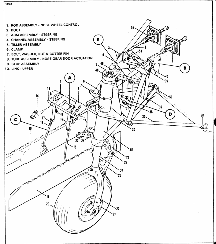

  • The nose gear door links don't look correct. I think it is supposed to flare out at the door to give clearance. I think is is hanging up on this during retract and extension.

  • Help me understand this illustration please. It seems that this is showing in the up position. If this is in the up position then I see where the door links are curved and the curve is facing forward. Is this correct? Also I’ve looked up on YouTube of Seneca gear swings and almost all of them have that same nose gear turn right at the end..Why it would do that, I have no idea. I found it to be odd, like it’s a Piper Seneca thing. Other piper models don’t do that. If those door links are suppose to be facing forward, its looks to me that they are. I’ll be back at the plane on Monday afternoon to see if they are but yes it looks as if it is rubbing on the right side link.

  • Here is a better view of all the parts.

  • Ok I have an answer for the nose gear turning just as it’s going inside the nose. So after I watched this gear work back and forth, I followed the ball that goes down the track and at the bottom of the track it makes a little crook in the last four inches of that track and it is suppose to do the little twist at the end. So the bottom of the track is #37 on this illustration. The ball is at the top of the strut right around the #4 on this illustration. You can actually see at #37 how the track makes a little jog. I am still troubleshooting the shuttering problem. Tomorrow we are removing the hyc5005 prestolite hydraulic pump and doing a bench test on it. If it’s good then we will do our best to purge the lines. If the pump is bad then I will purchase a brand new pump as an owner supplied part and install it under 21.9.
