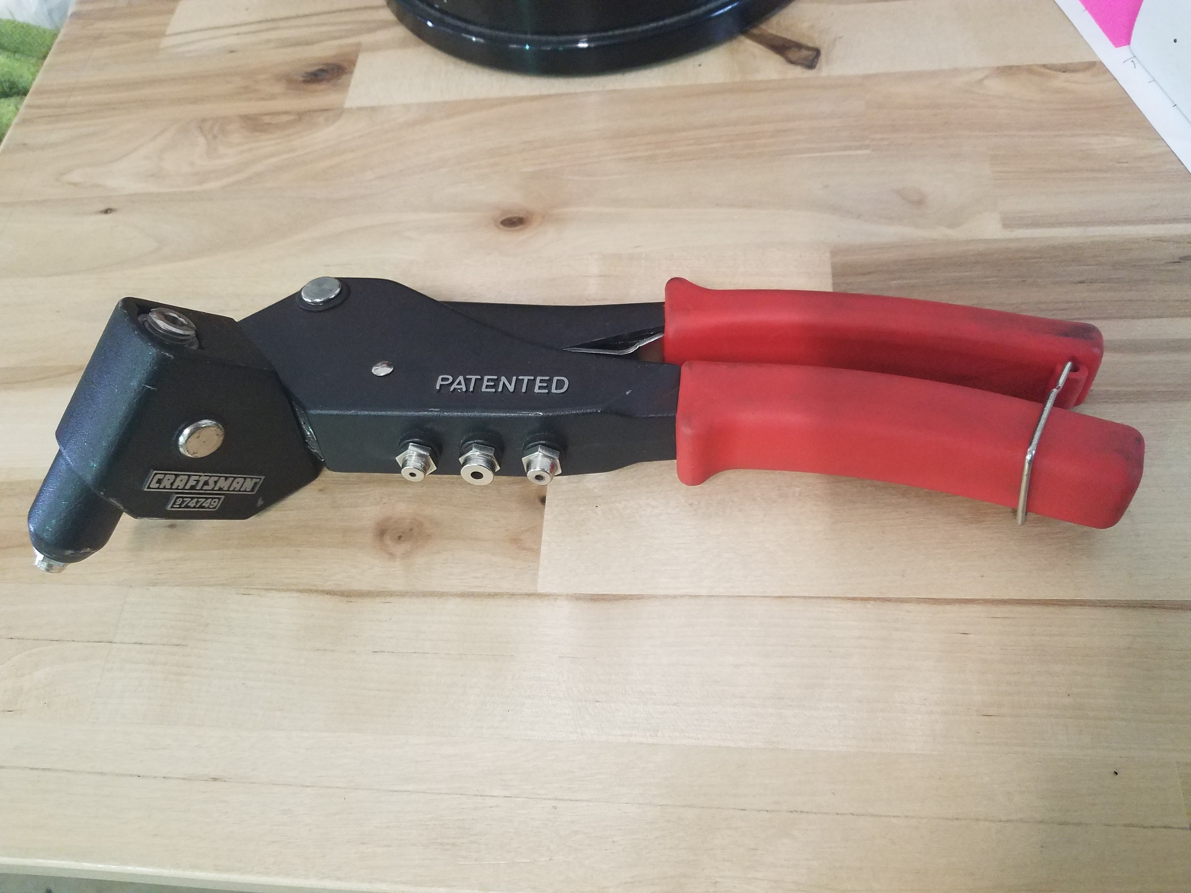

    Hi, here's a response from our A&P, Erich Rempert. See attached.
    I assume you mean Cherry brand pulled rivets.
    If so, I have used this Craftsman swivel head pulled for years with good results.
    See the attached picture.
    ~Erich Rempert, A&P Consultant
  • Harbourfreight.com has the identical riveter for. $10.99

  • Thank you all for the suggestions. I was able to use a similar puller to the Craftsman shown by Erich Rempert successfully (although Cherry publishes notes, cautions, and warnings that you may have to rework them if they do not install and inspect OK). Used Cherry-Max for the high strength ratings. Cherry has other series (N series?) that are weaker so they are limited in their application. Tough problem was finding supplier that would sell less that 100 packs on the long grip sizes. I was able to obtain from Spencer. The sizes I needed were longer than those routinely shown on-line by suppliers such as Spruce.
