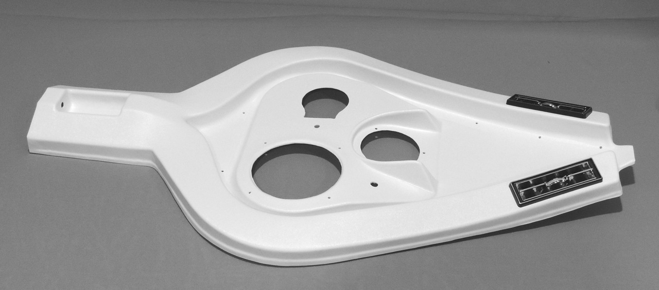

The overhead console in my Arrow is cracked in several places, and I found a replacement at Knots 2U. I am going to assume that I can replace this myself, as I believe it falls under the following owner-allowed maintenance...Correct me if I'm mistaken.
"Repairing upholstery and decorative furnishings of the cabin, cockpit, or balloon basket interior when the repairing does not require disassembly of any primary structure or operating system or interfere with an operating system or affect the primary structure of the aircraft."

  • You are good to replace any interior pieces on your own.
    Paul
    1963 Cherokee 180 B.
  • I repurposed/repainted my overhead console. Only consideration I discovered with a replacement, holes for the retainer screws may need to be drilled.
  • Yes, you can replace it yourself. I've done many and you will probably need to trim it a little. When it's done it's really nice. I'm going to visit Knots2U tomorrow. Great company and products.

  • My wife helped me install this today. If any of you are contemplating doing this, here's some good advice...Open the holes with a 3/16" drill in the plastic that they have already drilled, or else you will never get it mounted!!! I could get the screws on one side started, but couldn't get the screws on the other side to start, because I didn't have enough "slop" to move the console to get the holes lined up. Took the console down again and drilled the holes bigger, and then it was relatively easy to get screws in and tightened down. The new console looks much better than the old, yellowed, brittle console. Since we had it down, we replaced the speaker as well. The old one was in bad shape!
