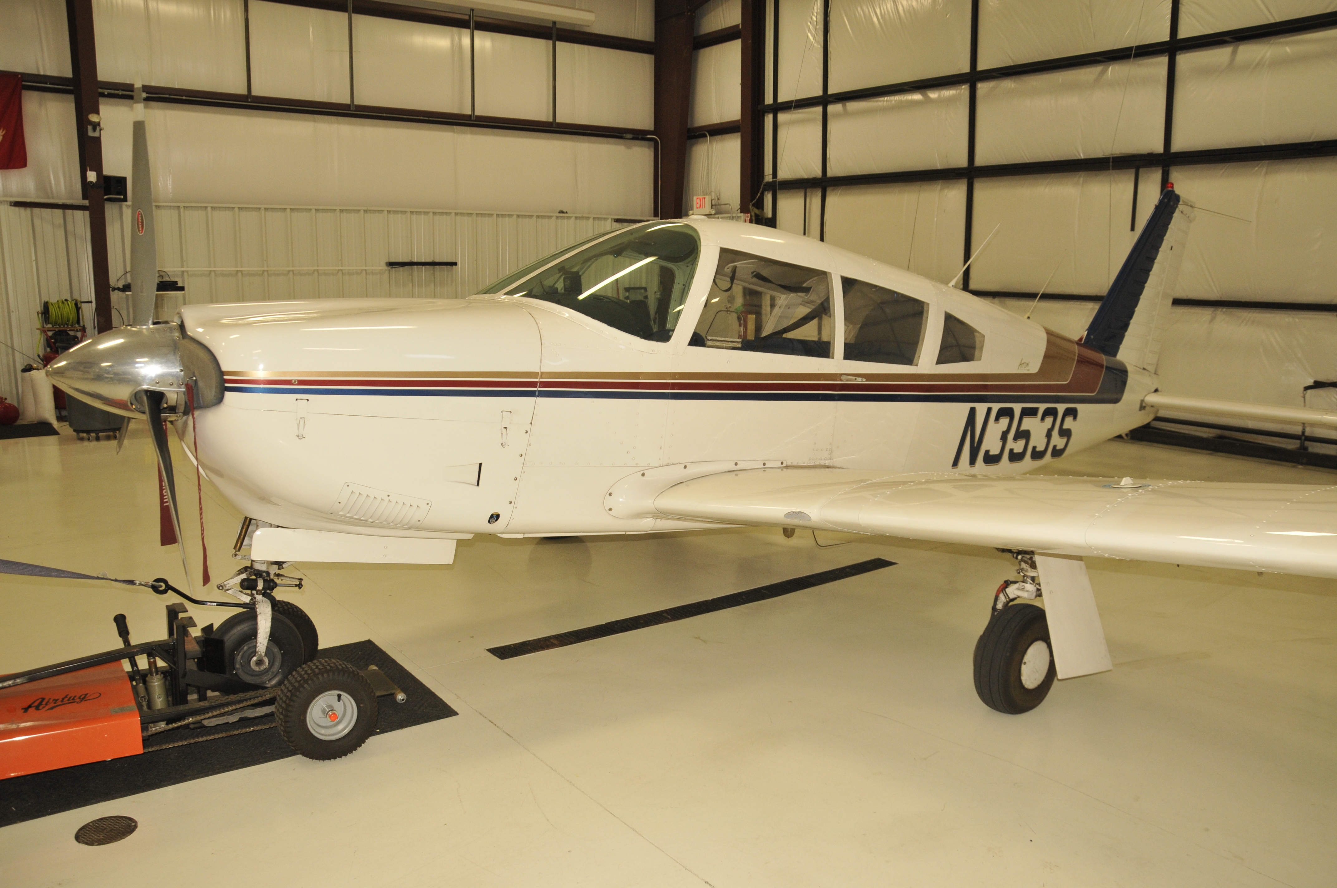

  • Hi Jim,
    In the hangar across from me is an Arrow 200 with a three blade prop. I can put you in touch with the owner, Bob, if you want to talk to him about it. Here's a picture.
