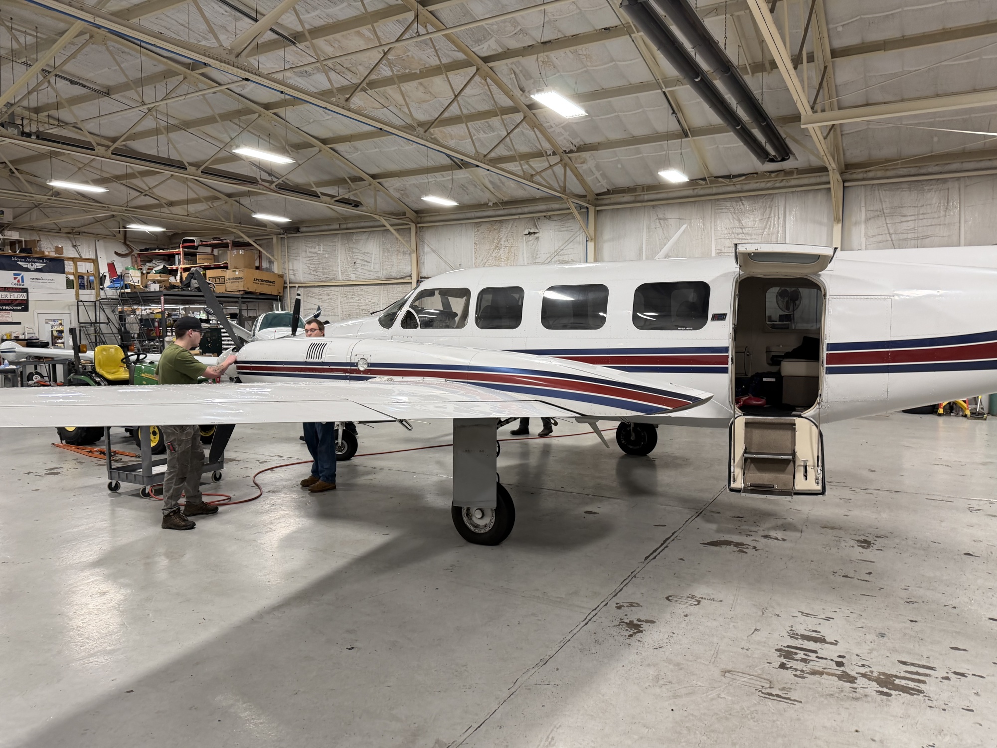

    I bought a Chieftain and put in with a management company. It just seemed like the best way for me to handle the ownership. The plane is at MPO and the people seem very helpful and friendly.
    Lets see how things go.
