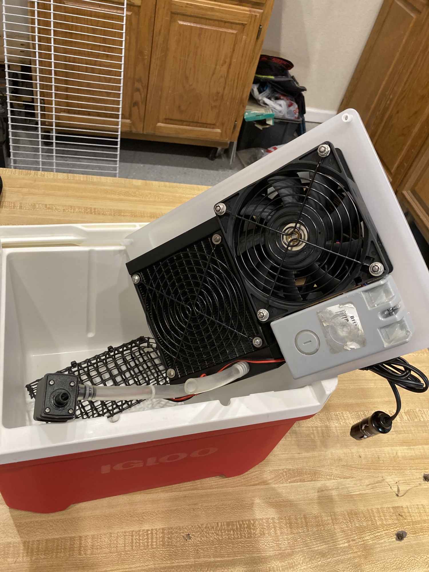

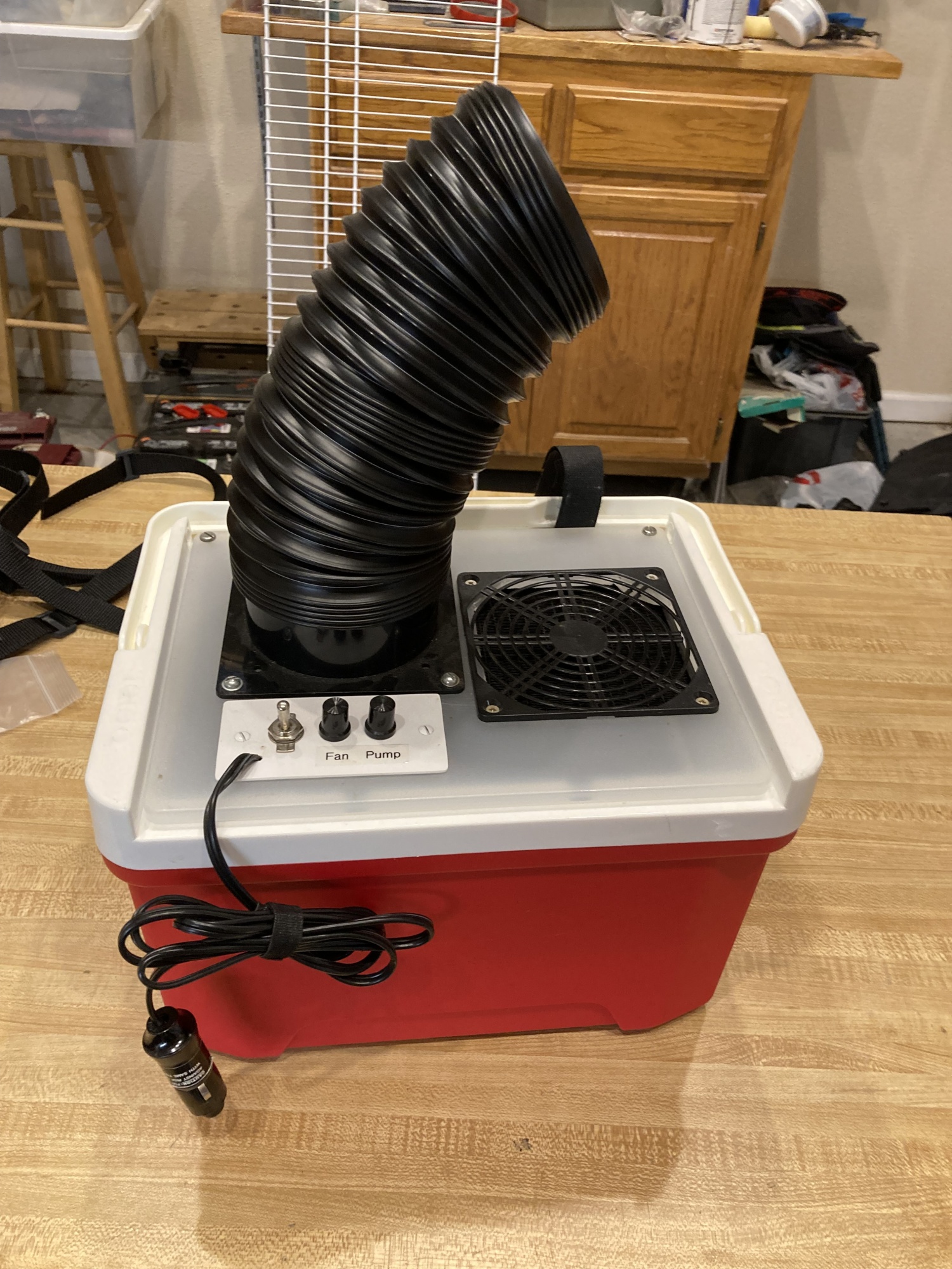

  • These aren’t difficult or expensive to make and, surprisingly, the interest in crypto mining has actually created more options. There are small radiators, water pumps, and ducting from that world plus more usable fans.
    I made one from a $10 (at the time) Igloo cooler and a Walmart cutting board that fits it perfectly. I used PWM rotary switches to control fan speed and pump flow: no matter how much ice you have, the cooling ability is constrained by the calories it can absorb so the warmer you keep the air coming out (via pump flow) the longer it’ll last.
    Making the lid out of a cutting board gives two advantages: first, it’s easy to remove it and reinstall the ice chest one at the other end of your trip, to use it as an regular ice chest. Second, the pump/fan unit is modular and easy to drop into a bigger cutting board (or two next to each other) with a cutout, for a bigger ice chest for more cooling capacity.
    A regular 4” muffin fan won’t cut it: if the fan doesn’t draw at least 2A (12v), it won’t have the volume you need. Bilge fans are actually a great option but a bit more expensive.
    Between a trip to WM for the ice chest and cutting board plus some time on Amazon, I was in for around $80, as I recall (prices from a few years ago).
    From Amazon (some are “twofers”, so two people building them could save more):
    https://a.co/d/bswXsfY
    https://a.co/d/4tuXbCT

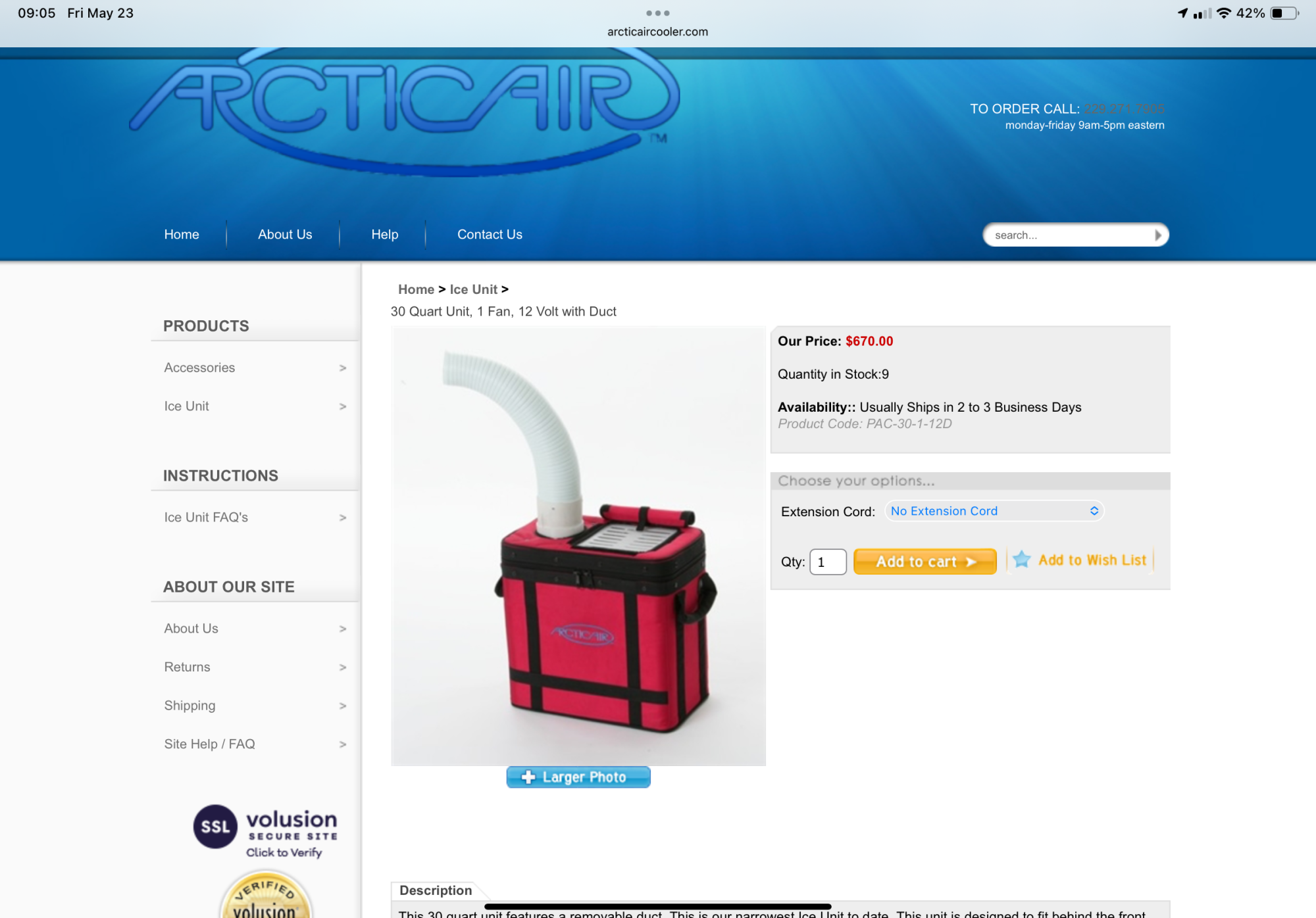

  • Hi All,
    On the subject of Ice Coolers, I purchased an Arctic Air Cooler a few years ago and have been satisfied with it!
    • its well made, sturdy
    • holds 1 large bag and 1 small bag of ice
    • fits well in the Aft Baggage Area of a Seneca
    • will pre-cool the airplane
    • last for about 2-3 hours
    • runs off a battery
    It’s a bit pricey at $600, but it does help. Mine, a few years ago was in the $400’s.
    Looks like it’ll fit in most Piper Baggage Area’s and I just slide it in full and pull it out to dump the water. I like to use Yeti Ice Blocks when flying Local. Freeze ‘em in your Hangar ‘fridge and pop them in with a small bag of ice and it works well for a few hour Island Tour. I use a Jackery Battery Pack.
    This all works well to knock the heat down, make it more comfortable for everyone during Ground Operation and Initial Climb. Turn Off for Higher Altitude Cruise and back on for Descent, Landing and Taxi-In. Most FBO’s can help you out with a few bags of ice for the Cooler and the Galley.
    I’ve had no issues with it the past handful of years.
    Not quite as good as the 737 APU, but it’ll do! 😜
    Hope that helps!
    Stay Safe, Fly Fun!
    George
