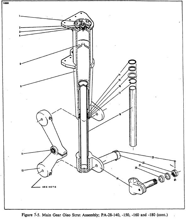

Hey planewrench, one of the main tires is wearing unevenly. The inboard side of the tire has no tread while the outboard side has about 1/4 tread left. The upper scissor dog ear on the the ldg strut is tight no room for any shims. I did notice on the annual the mid scissor bolt was sloppy. Installed new tire and tube, tighten the bolt and will start to measure the toe-in and camber.. The axle is an integral part of the lower strut (see pic). I plan on removing the wheel and lower the A/C on wooden V-Blocks the same height as the other wheel axle. Measure the axle angle relative to a waterline and to do the same procedure to the other wheel and compare the results. The other tire wears evenly.
Yeah I had a strong suspicion that was going to be your issue you were talking about. You are correct to measure the angle of the axle.
Suggest you just level the airplane on Jacks, measure left and right axles with a digital protractor will probably give you a good idea if you're wearing sid is slightly bent.
Surprisingly the maintenance manual for the PA 28 series doesn't give any information on fixed landing gear alignment. However for the PA 28R toe in is plus or minus half a degree. They use a simple procedure of a straight edge across both wheels with a carpenter square. Might be worth checking. Carl
