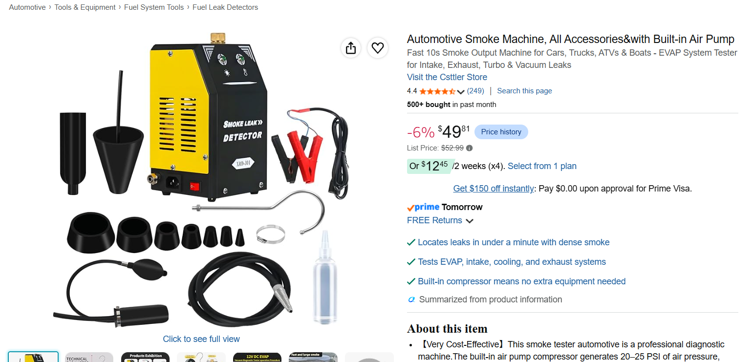

  • That is a lucky find as a full exhaust leak there would be catastrophic. Now that it is sealed did they go back and repeat the fuel pressure adjustments with the gauges?
    There are a couple intake leak checking smoke generators that also work on the exhaust side. I have found it invaluable for tracing small leaks in cars, boats and planes. It will not only generate smoke with plain mineral oil but it also pressurizes the line so it will push out of even the smallest of openings.
    The one below is the same one I have. It does need a small 12V battery to make it work. This one has the range of adapters to fit into the induction and exhaust system. You will see leaks at all the slip joints but should not have any leaks at the v-bands or exhaust manifold flanges.
    These things really shine on older automotive systems with a rats nest of aging plastic fittings and rotting vac hoses. I have struck out with ultrasonic testers where the smoke test quickly found it.

  • Thanks for the info on the smoke machine Eric!
