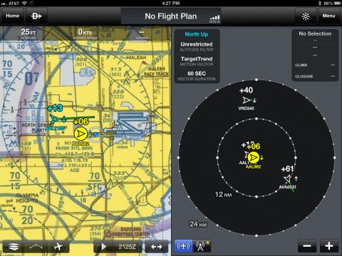

I was staying in a hotel directly below the final approach for the active runway at MIA - apparently about 500 feet below the glideslope! I was able to watch the airplanes fly overhead, and compare their position with what was shown on the screen - it was very accurate. As fun as that was, we didn't stay in THAT hotel the next night.....

On ADS-B in generally, they just turned on the ground stations in our area a couple of months ago, and both the traffic and the weather work really well. I'm a 'participating' aircraft, and I start getting both traffic and weather info before I make the crosswind turn after takeoff. The traffic has made it clear to me that my eyes are not as good a tool for traffic as I thought. Just last week we had an airplane coming in to the pattern, never made a radio call, and from the looks of it, either didn't see the other plane already in the pattern, or didn't care. I was approaching the airport, and could see both aircraft on my iPad, but couldn't see them with my eyes until I was just about into the pattern. I made a call to the other plane (I knew the pilot) that was established in the pattern regarding the traffic, and he appreciated it a lot.
The non-communicative aircraft was doing a touch and go, and I had to delay my entry to give him space. If I hadn't seen him on the iPad, I wouldn't have seen him until I was already in the pattern, and we would have been much too close for my comfort.
