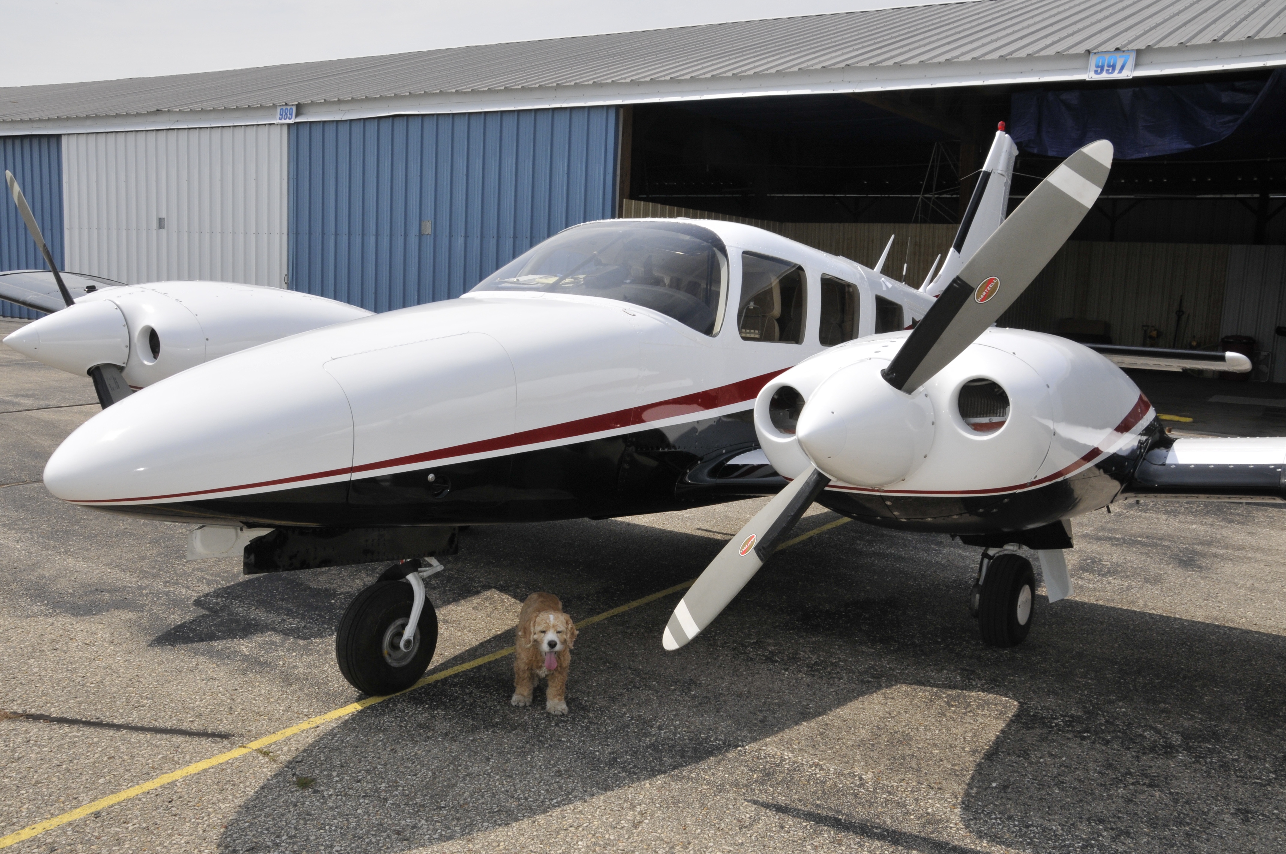

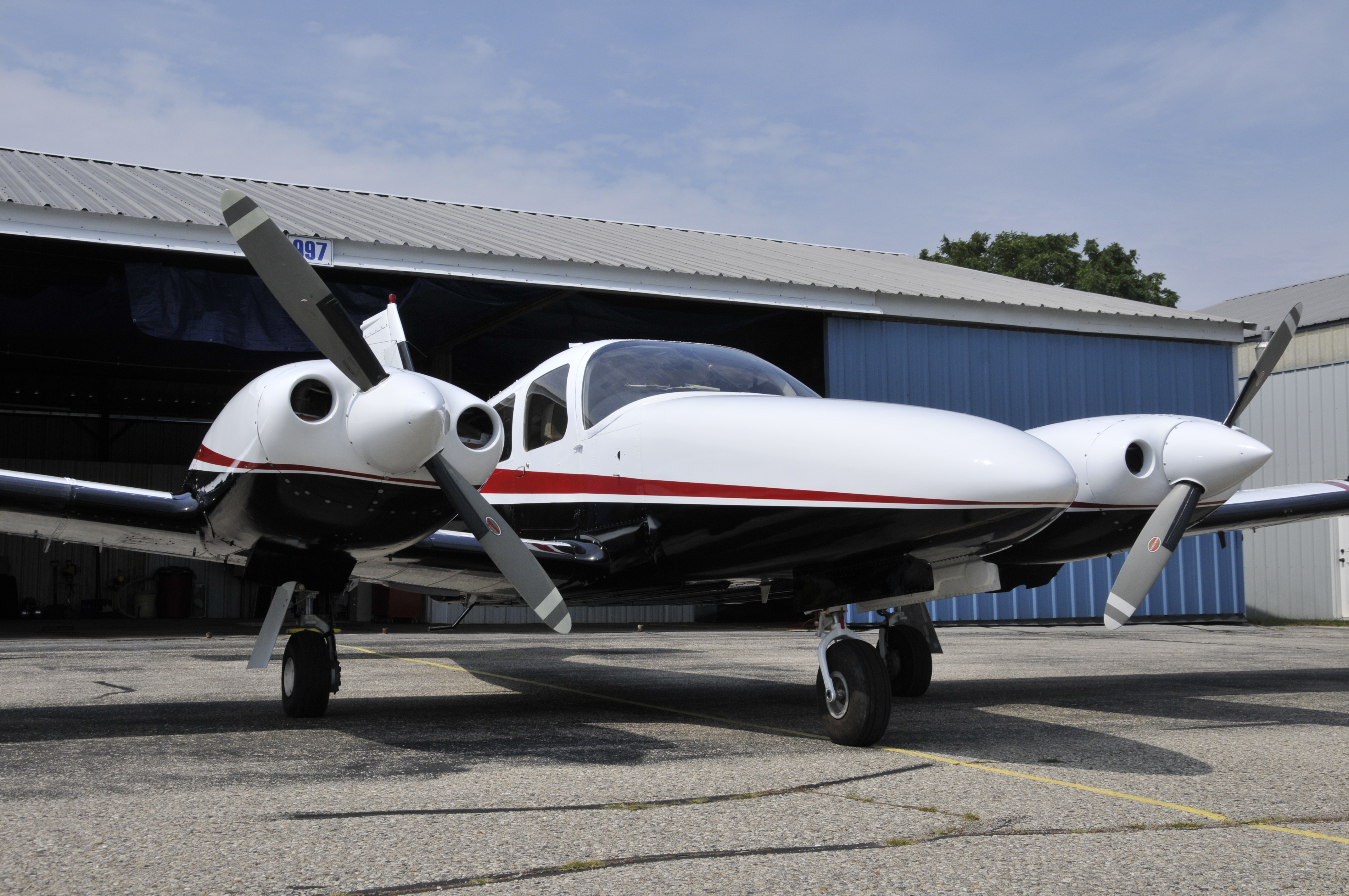

I have Seneca 2 and 3 experience and currently own a fully restored/renewed Seneca 2. I have just over 1,500 pounds useful load and do between 180 and 190 knots in the low teens. I can carry 4 adults, full fuel and 200 pounds of baggage, approximately. My Seneca has 160 gallons which puts my endurance at 6.5 hours or 1,170 nautical miles. Enough to go from Milwaukee (where I live) to Miami non-stop. Here's a pic.
Here's a pic or two. Looks just like a Seneca 5 at 1/4 the cost.
