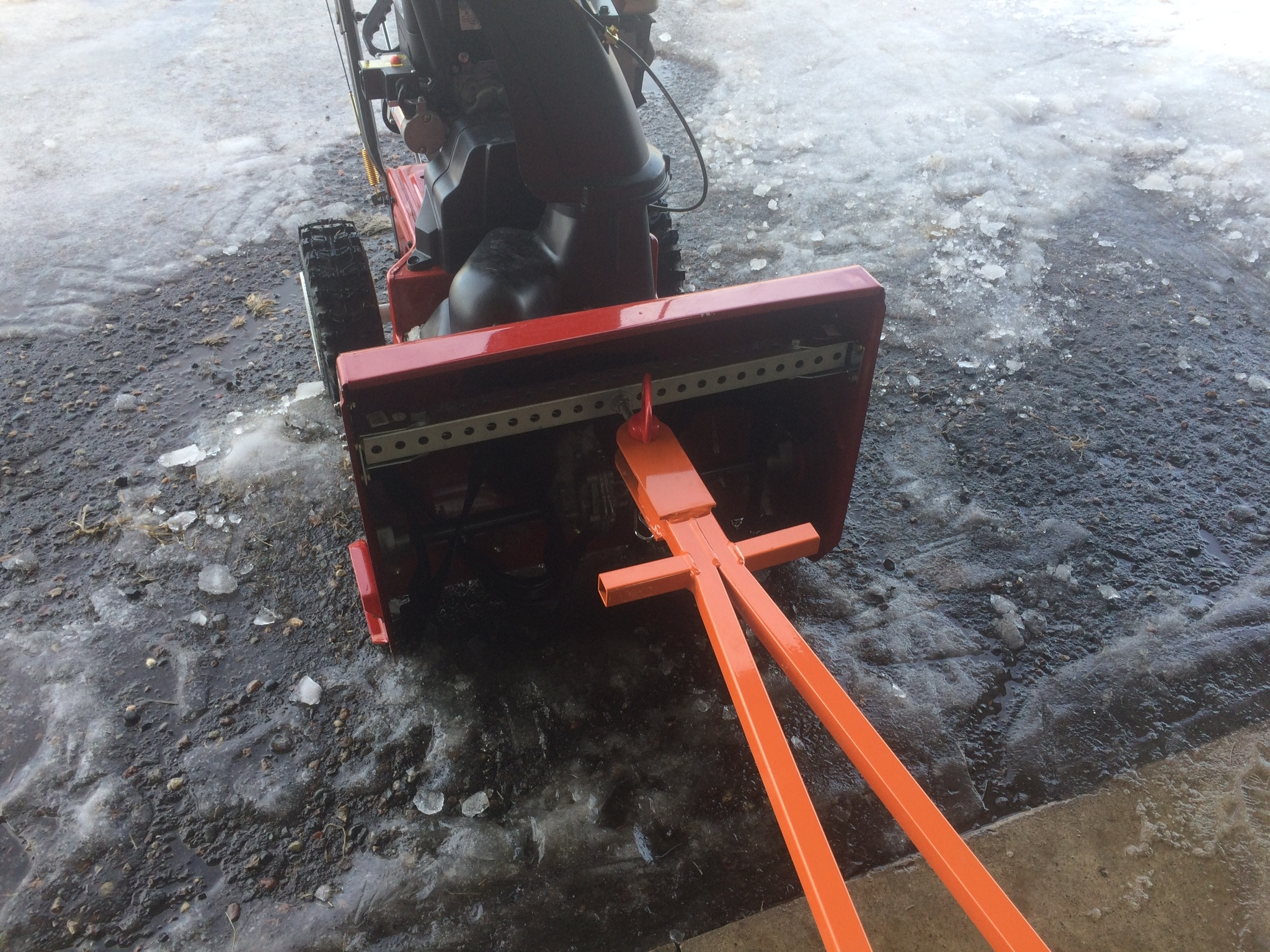

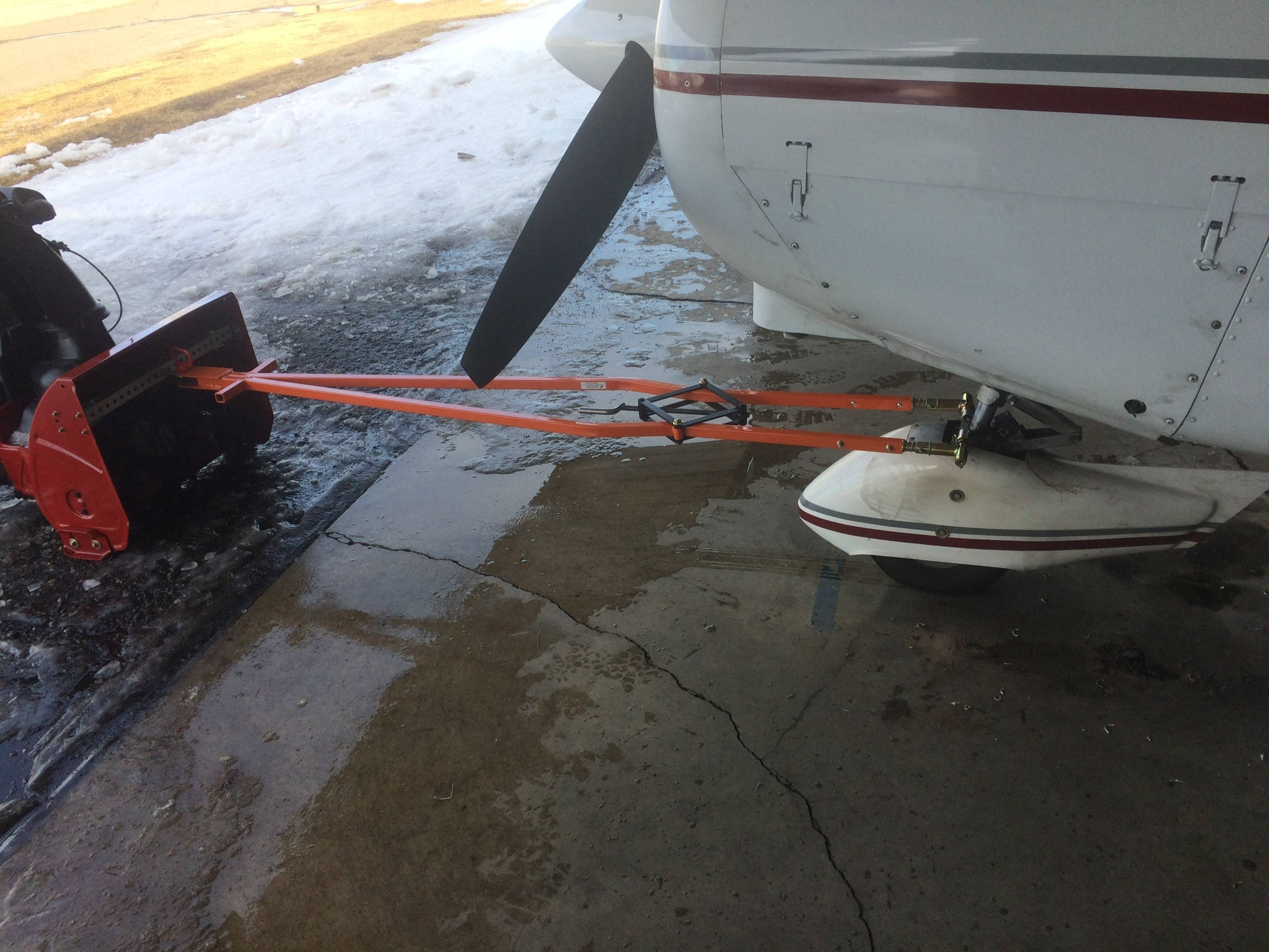

Hi Scott
Thought I would share this with you and your readers, as I had been looking for a tug To pull my warrior in and out of the hanger, but couldn't seem to manage the cost of one So I converted my snow blower into a tug as well as use it for snow blowing. I used for parts 3 inch caster wheel purchased from harbor freight pulled the wheel out Used the housing and the bolt for the 1 3/4 inch drilled square stock purchased from a local lumber company such as Home Depot. And used a 1/2 inch eyebolt with nuts and washers for the attachment for the tow bar. I purchased a 5/8 inch trailer pin to connect to the tow bar.
Berry Baremor
  • Scott, I know this is an old post, but what a great idea!
    How’s is it working after a year?
    1976 Arrow
    Wyoming
  • Heck of a good question! I hope that Barry will update the post :) If he does, I will be sure to post it.
