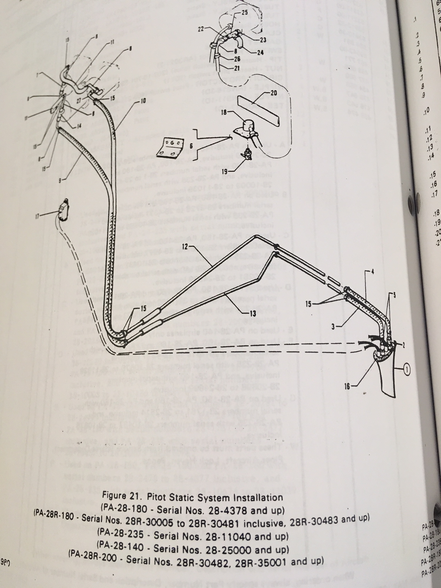

Scott,
Attached is a photo I just took of a page from my parts manual that shows there is no pitot-static drain for my s/n Arrow (SN 35316).
Jim Torley
CFI-A/I/G
1969 Arrow 200
Hi Jim,
Here's a scan of the parts manual for my Arrow including the parts list.
I see your Arrow has separate static ports (2) at the rear of the fuselage. My static port and ram air are located on the same "mast". The configuration on your drawing is quite complex and definitely not going to be incorporated in my bird!! I figure after almost 50 years it is what it is! As I mentioned above, I have not had any issues with water in the system but there must have been some reason Piper made the change. Thanks for the data!! FYI, my Arrow also had the automatic landing gear extension system which was, fortunately, removed long before I bought the plane. I have heard only bad vibes about that system.
