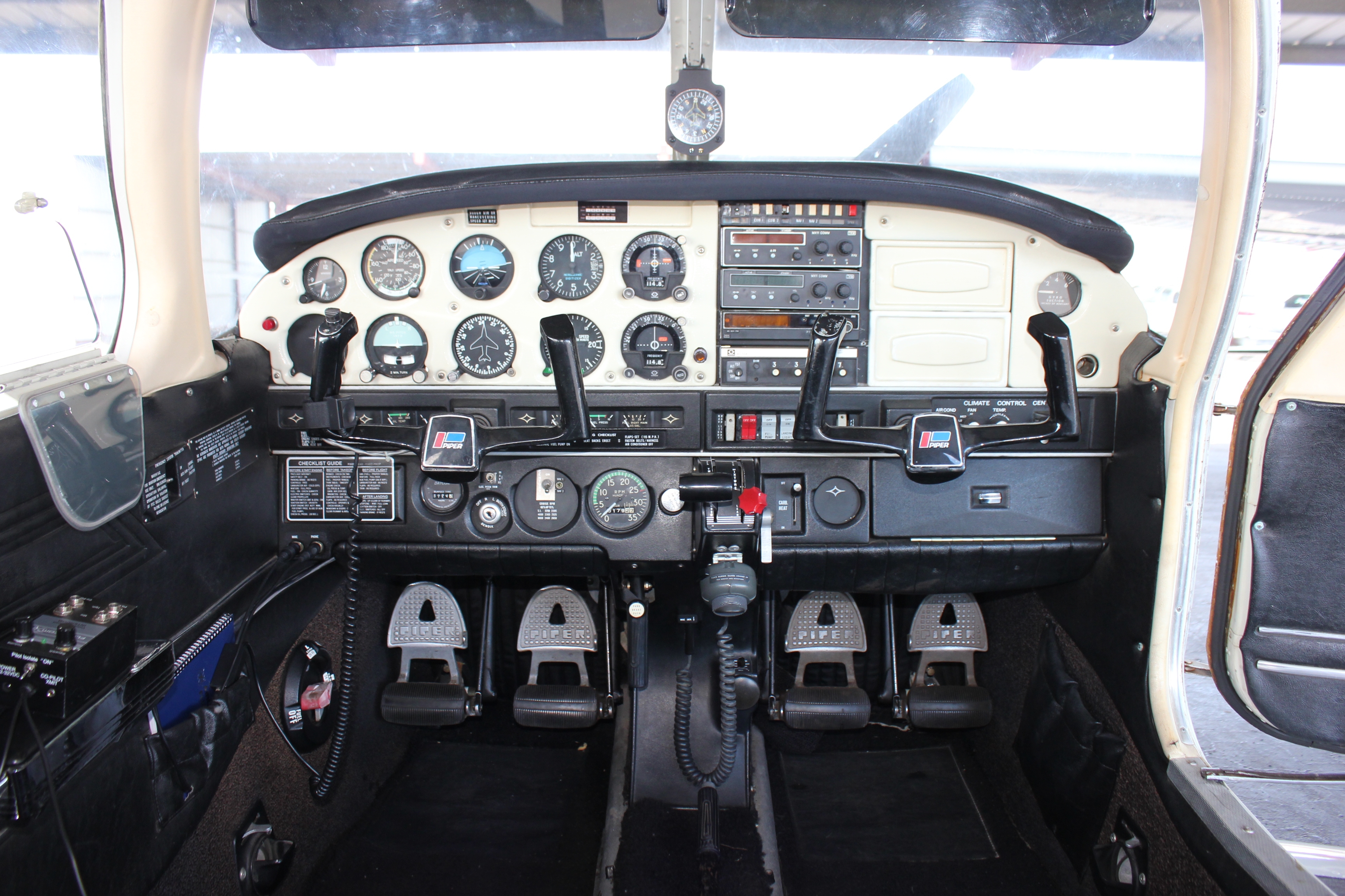

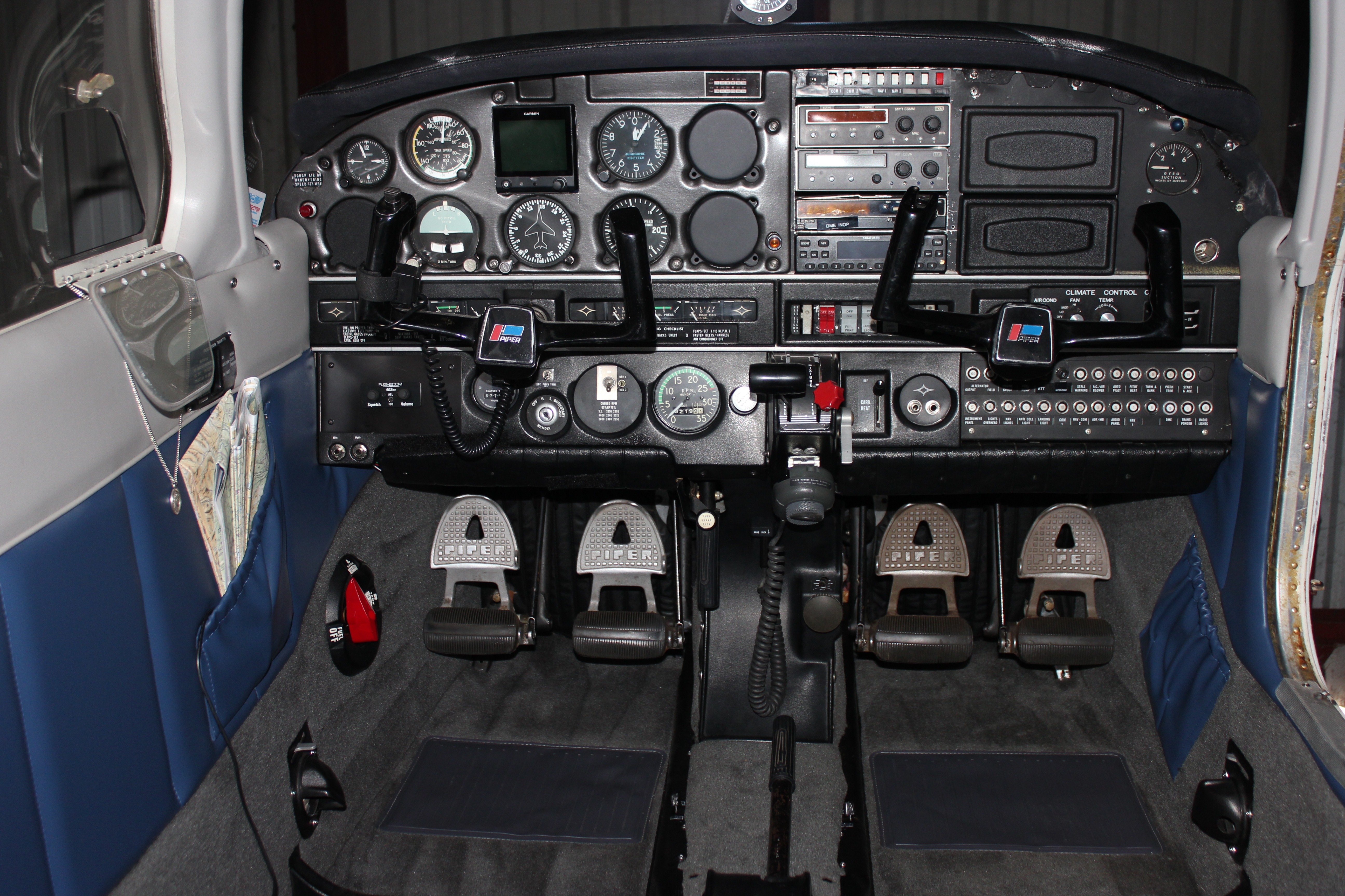

I re-did the interior of my 1974 Archer and concur with others that the Airtex products are great though I had my seats re-done separately by Oregon Aero. As others have already said, it's extremely time-consuming. Don't underestimate how much time it will take (and brain cells you will lose) to get the old glue scum out. It was worth it and I'd do it again. My before and after photos follow. Up next is a panel update to cover my new dual G5 installation (not shown).

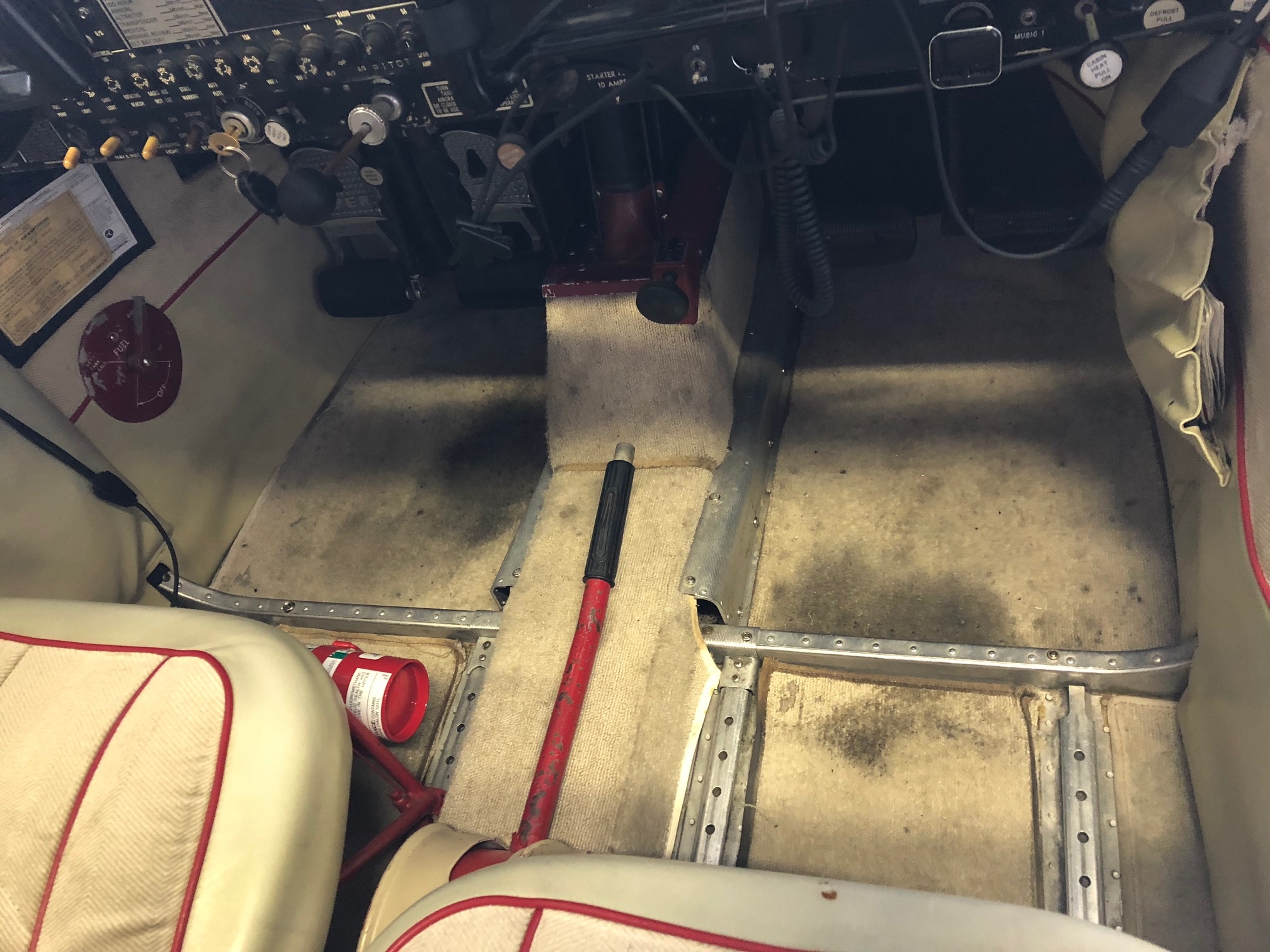

You're probably not going to like this, lol, but about removing the old glue. I brought it to my shop when I had everything out and they cranked up their air pressure driven glue removing device. It's a special power sander that doesn't do any damage to the metal, it just rubs off the glue and polishes the metal. It took 15 minutes and they did it free.
And you'll never read this anywhere either, but do not glue the carpeting to the floor. Rather, get rubber insulation sheets from Airtex and cut them to fit the carpeting. Then attach velcro to the insulation and the floor. Now you have double sound and heat insulation on the floor and your mechanic can remove the carpeting in a minute to inspect for corrosion or make a repair.
Yeah, I agree with that. I had to take the glue out from under the old carpet. The odor was from the solvent. I did NOT use glue for the new carpet. I did need to use some for mounting the headliner velcro strips.

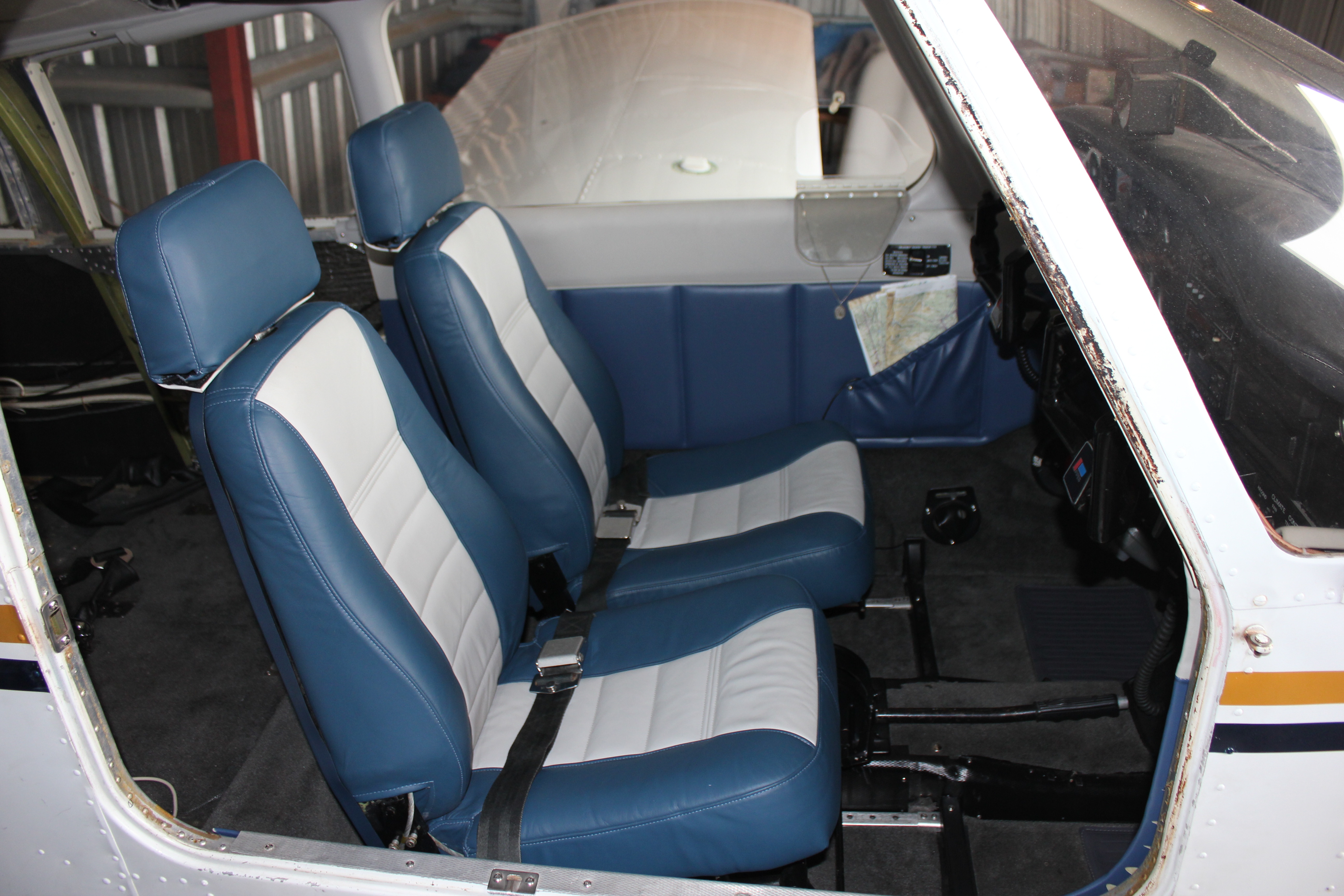

Hi. Assuming you're talking about my seats, here's a better picture of them (note still no rear interior panels at this point). They were done by Oregon Aero in leather to match the Airtex panel colors. They have a special cushioning system that makes a tremendous difference in comfort. It was horrifically expensive but came out great.

Sorry, I just realized you weren't talking about my seats since there weren't any in my first set of pics. Oh, well, there they are anyway.

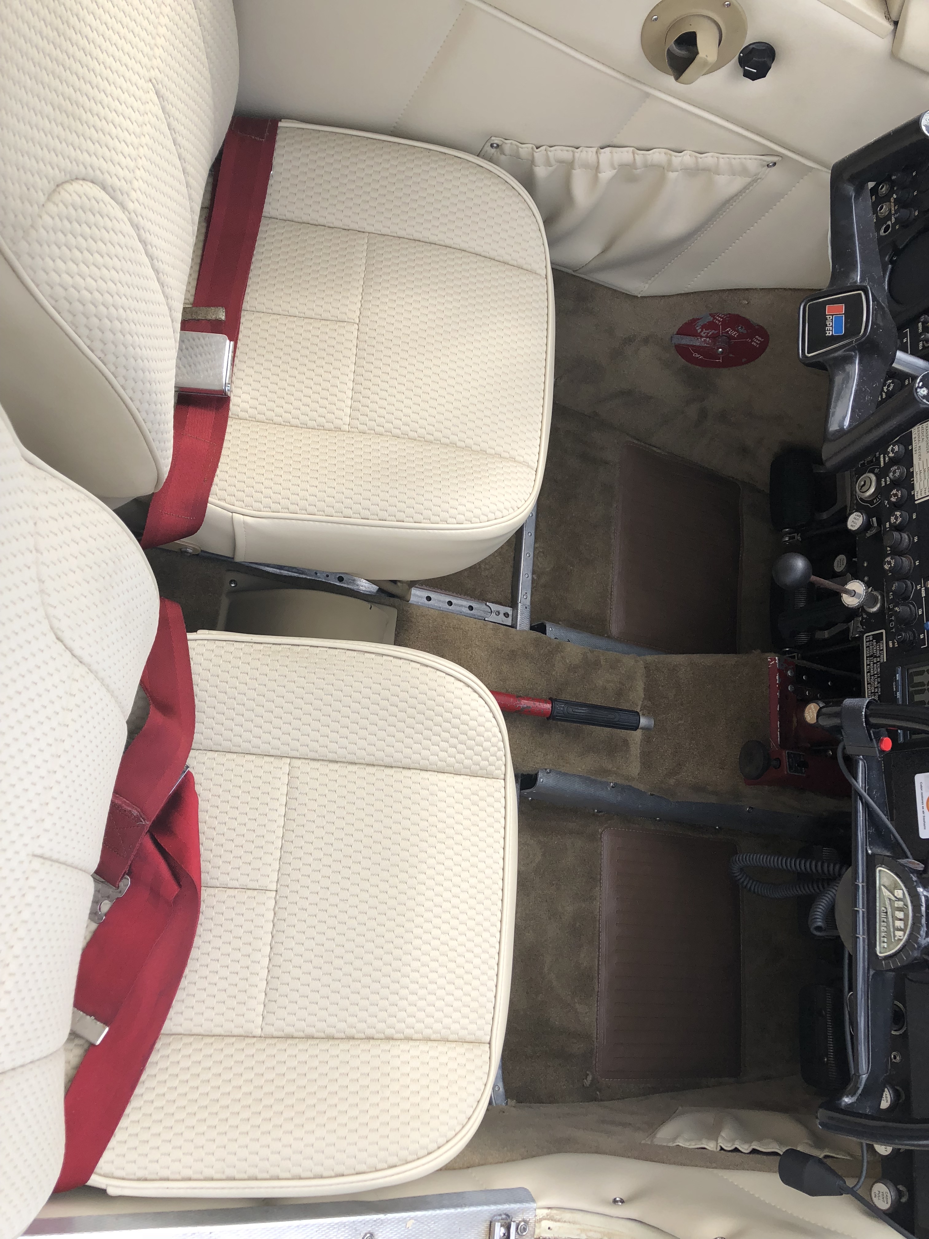

And responding to Kentwkalb, I think you will like the textured cloth inserts that we used in our seats. We have flown them in summer's 90+ degree Fahrenheit weather as well as this winter's 15 degree weather without our butts sweating or freezing like they do on some leather or vinyl seats, lol !!
Thanks. Yes the cloth would be my choice! I have sheepskin covers now...work well. My seat fabric is in great condition, just cushioning flattened.
