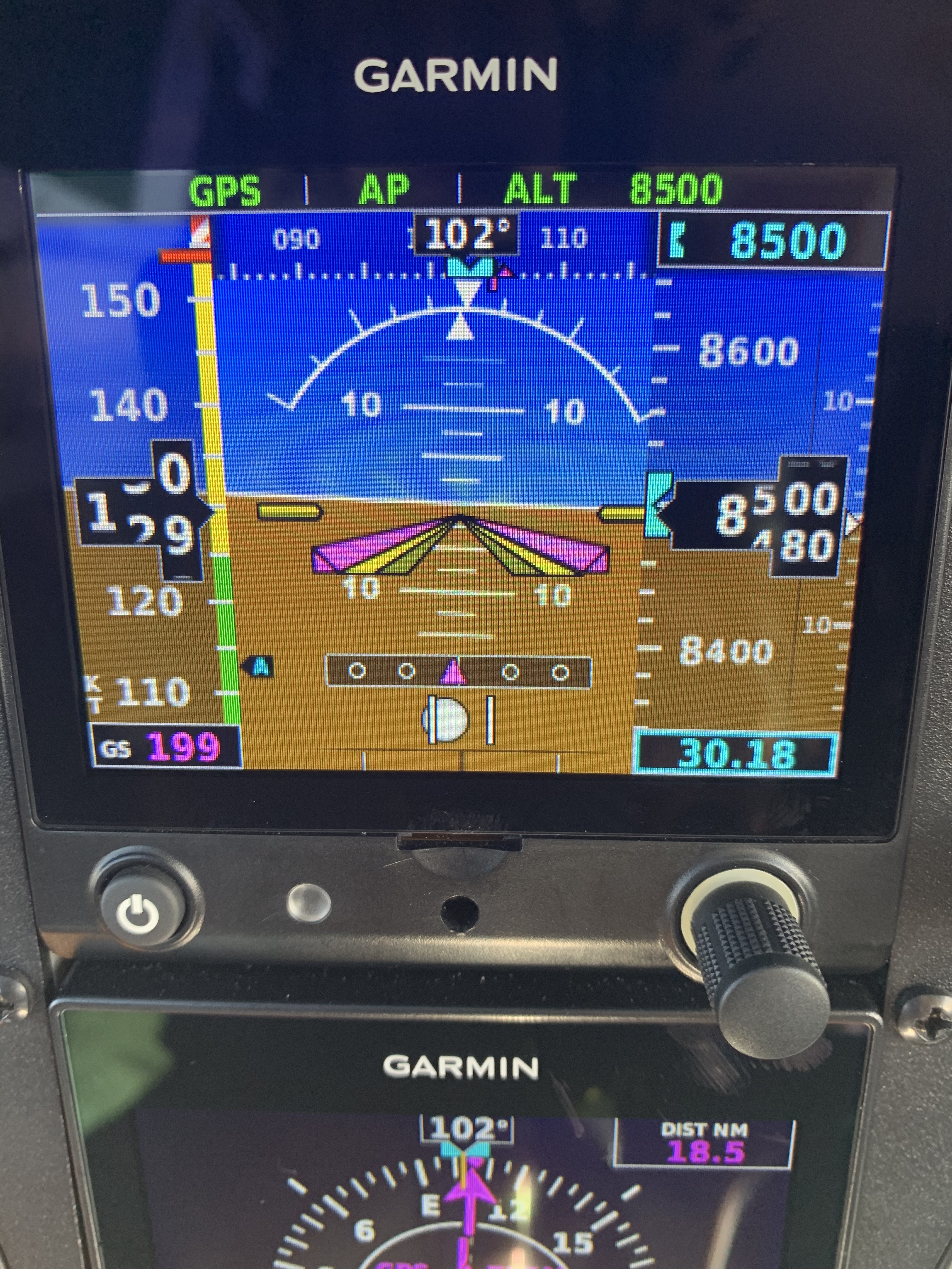

Flew to Virginia two days ago. Had an awesome tailwind resulting the GS indicated in the lower left of the G5.

I would hate to see the ground speed going the other way!

Nice ground speed. Don't look the other way, lol.

That is about 10 knots higher than the fastest I have seen in my Archer. I got about 187 on a flight from KCNM (Carlsbad NM) to KOUN (Norman OK).
Was fun/quick flight!
