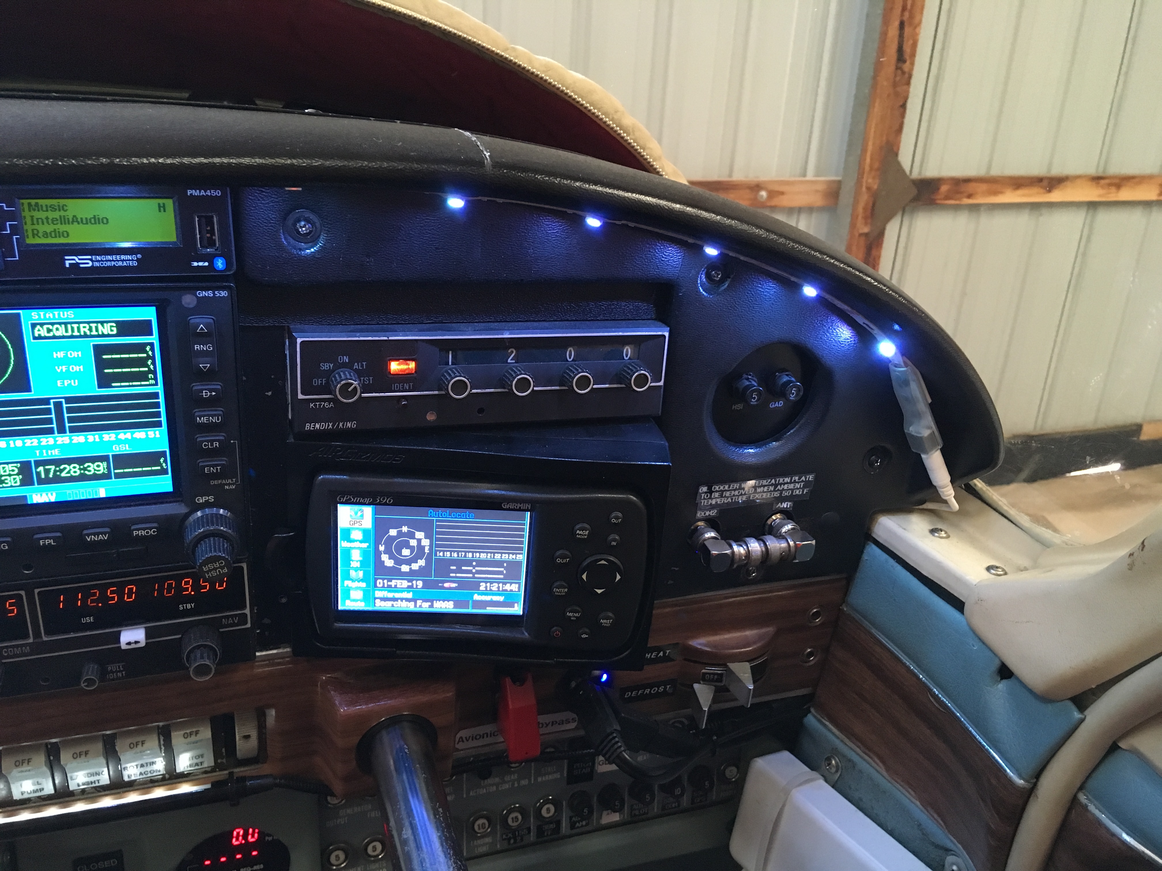

Mike,
You are right on. I had my avionics shop "intercept" the com antenna cable for #2 radio and mount two BNC jacks on the panel which are normally jumpered as you can see in the photo. My hand-held (Sporty's SP-400) has a long BNC cable ready to connect to the external antenna via this panel configuration. A spare headset with a radio adapter is also ready to plug into the SP-400. Spare batteries are in the bag with the radio. The Garmin 396 has its own GPS antenna and new battery so if a total electrical failure occurs my dual G-5s provide attitude info and the SP-400 can quickly provide communications and nav plus the GPS is there for situational awareness.
