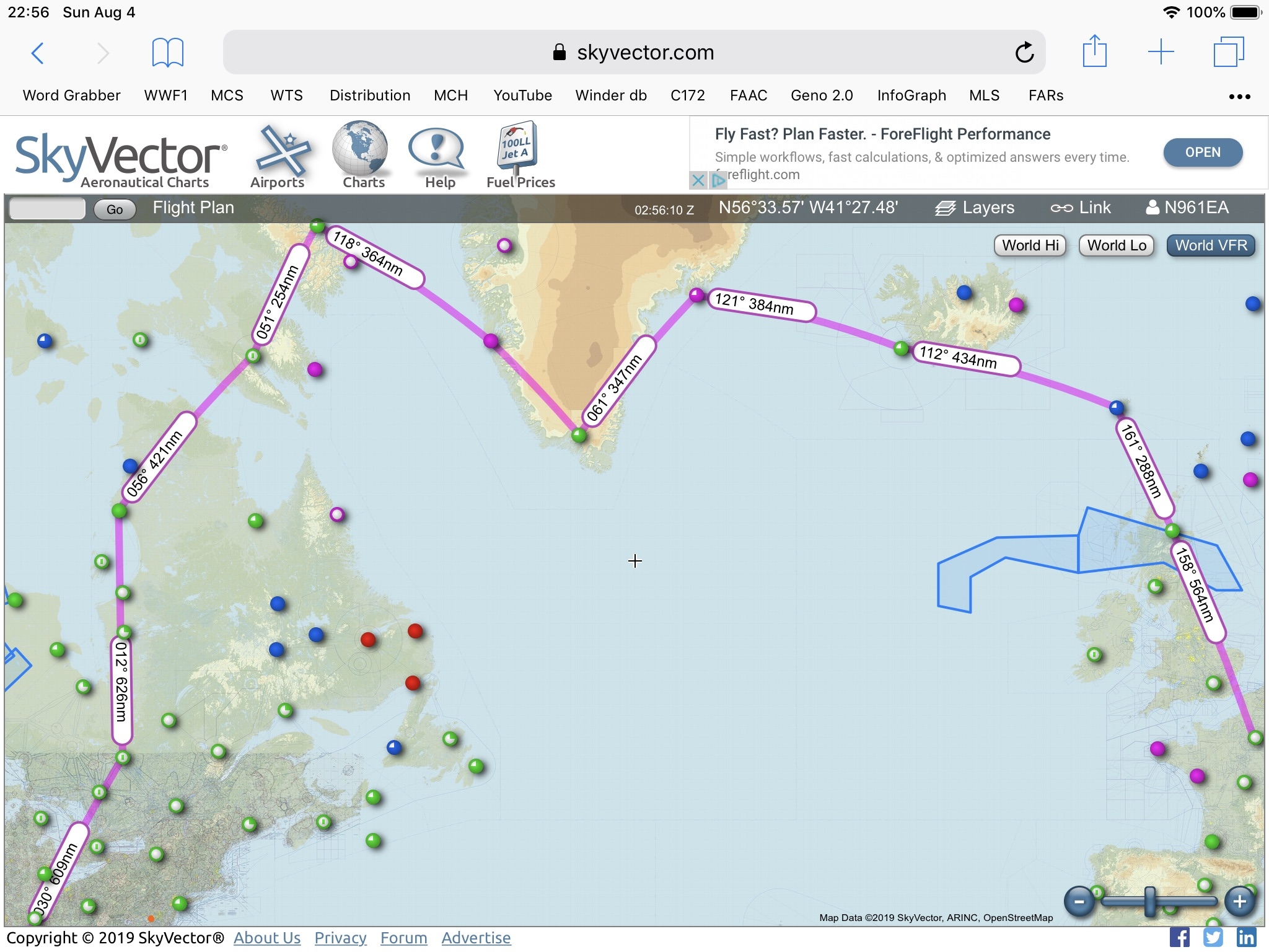

Ok, so I’ve hit the 1000-hour mark on my ATP journey and I’m getting ansty...lol...I’m considering going big and attempting an overseas flight to Europe. I’ve done a lot of reading and it seems that (short of installing HF radio and some survival equipment), the only risk is that my airplane is normally aspirated and does not have the performance to combat 50-100kt headwinds. I don’t mind abandoning (or selling) the plane in Europe if the westbound trip is impossible due to headwinds, but I’m wondering if the eastbound trip is even possible in a non-turbo light piston...
Does anyone have any anecdotal evidence eithet way? I’ve found stories about TBMs, Pilatus, and King Air’s, but nothing about 1967 Arrows lol
There is some routing up though Canada, Iceland, Greenland, maybe the Faroe Islands to the UK that has been done before. Definitely not for me, but I think the combination of anxiety and boredom would be the toughest part of the whole thing to overcome. I’d probably want more than 48 gallons useable, too!

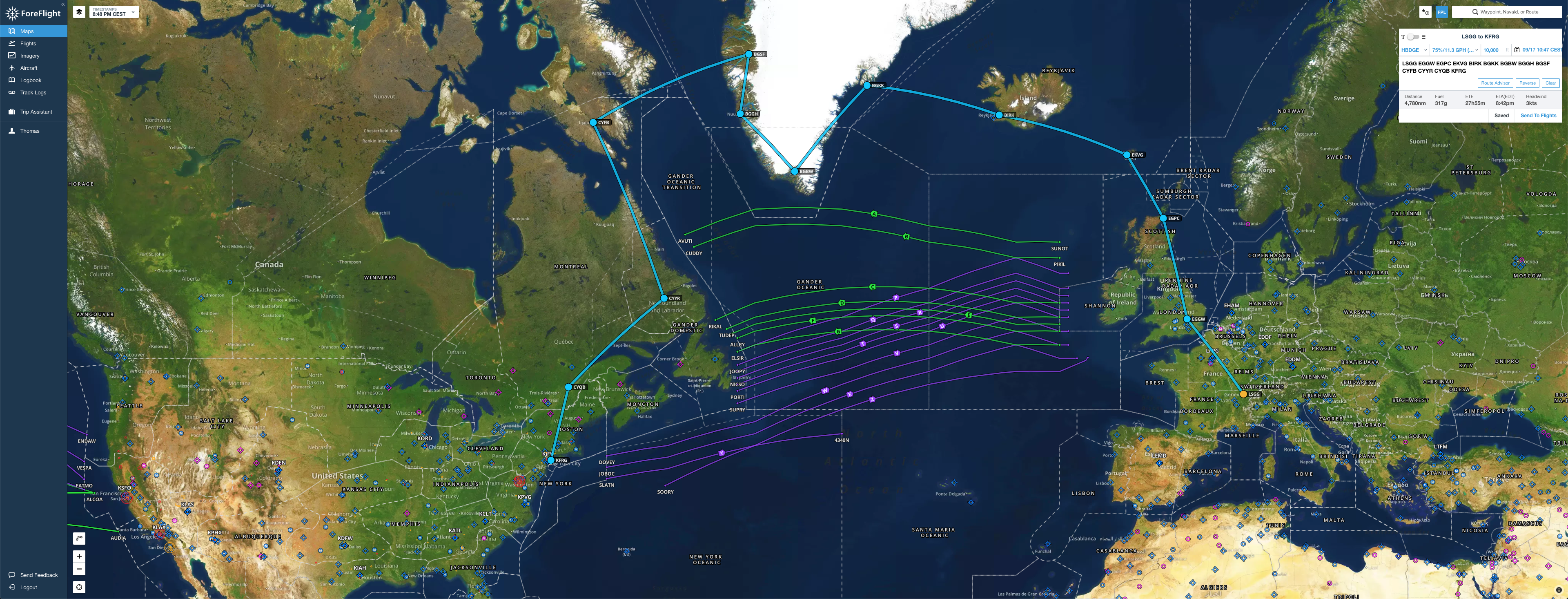

Headwinds, very scary...But @Jmcmanna mentioned Faroe Island...that is a great out...makes my longest leg over water ~250nm... The challenge will be terrain+headwinds on the return flight...will you keep you posted...it’s gonna be uuuuge!!!
That is some major league flying. There is a lot of planning that would go into a flight like that. You will be in a non-radar environment a lot. You also need to do last minute, planning based on winds for “equal time points” and divert windows. Also, a lot of that area of Canada is remote and might as well be water. Are you familiar with reporting requirements, diversion procedures and lost comm procedures? Up north, weather changes quickly and unexpectedly. The worst I’ve seen is OVC 003, 1/2 +RN winds were 45 gusts to 65. All this with a better than 3000/3 forecast on departure and an enroute check on the HF.
There is no way I would do it with an Arrow and I have in King Airs, Metroliners, DC9s and 737s. It your life though...
