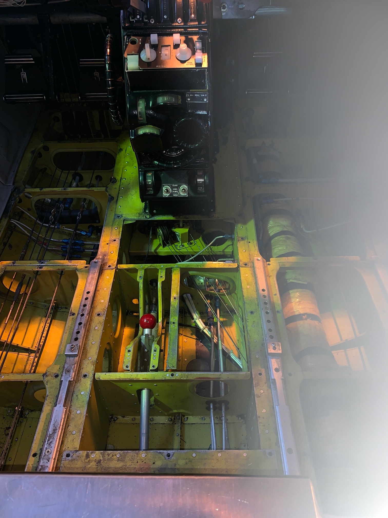

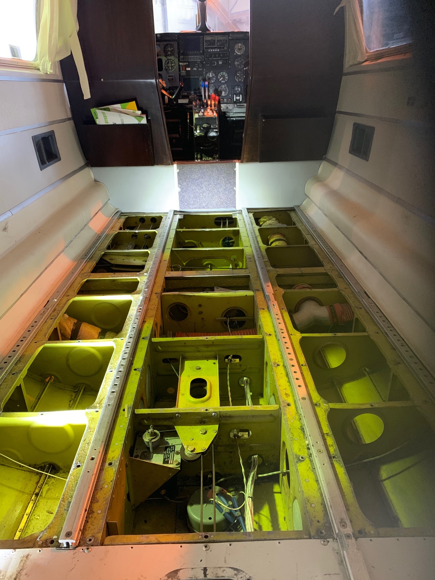

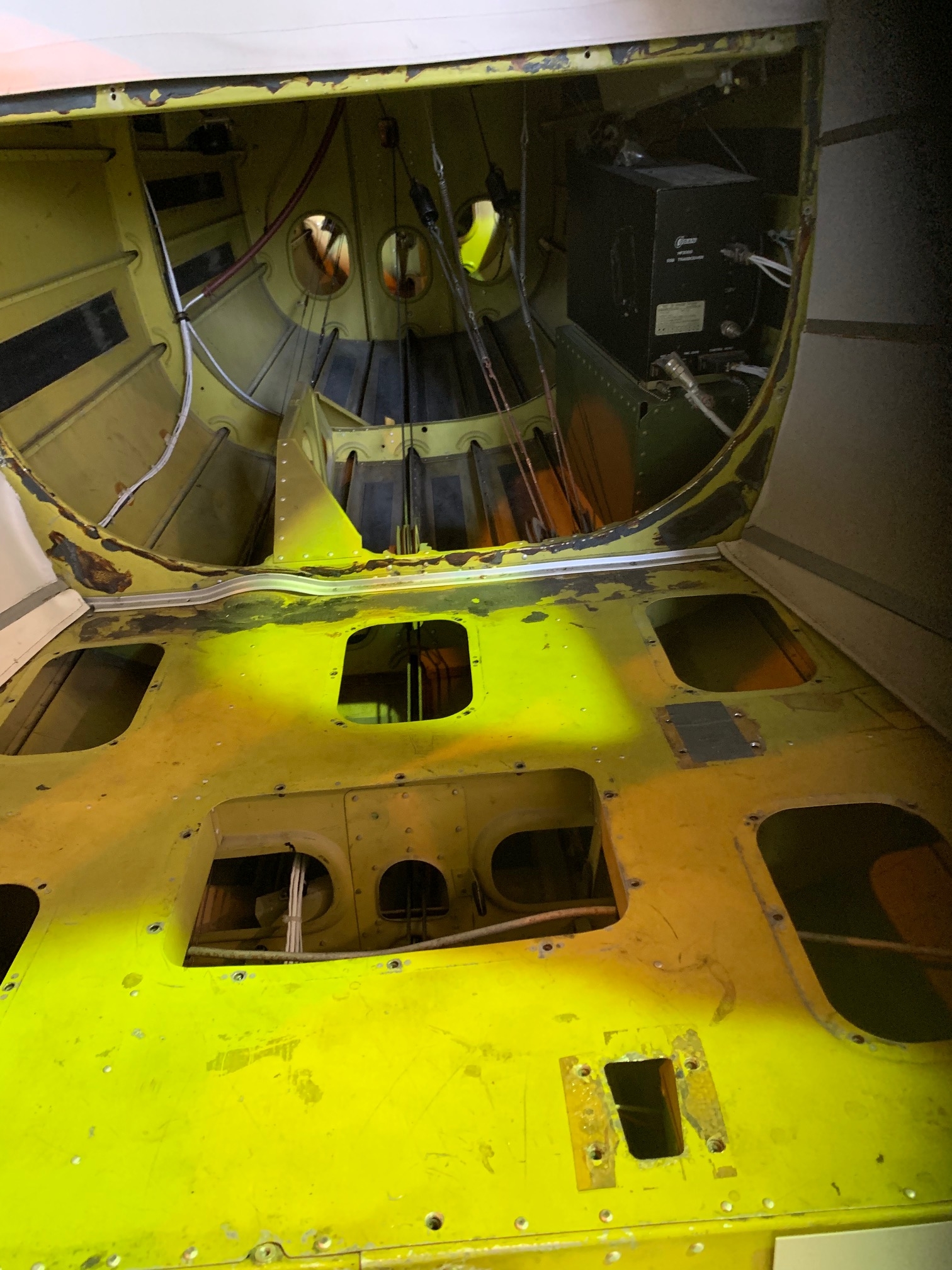

Inspection time over. Compressions ok. Full power run tomorrow or Friday. Required work pretty simple, life the props, 500hr the mags, gaskets for fuel servos, one turbo maintenance, a couple of other smalls things.

So an update, more work to be done but nothing exceptional. Had to do the 500 and 1000 hr check. ELT was missing, some other things have been lifed out. One engines hoses, both engines rubber mounts. Add another USD$10-15T, still pretty happy. The janitrol heater missing so if any one has advice on that. Had to subscribe to Piper's annual maintenance service. Didn't know about that. Another 3 weeks to go, mainly that is getting the props back. Dealt with minor surface corrosion. New tyres for the main, rebuilt all mags and fuel servos
