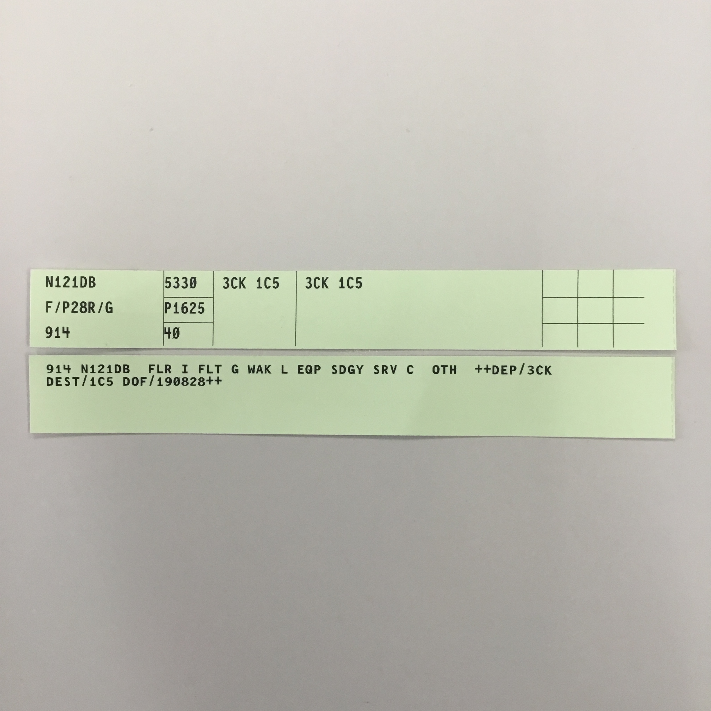

If you have ForeFlight, you can simply switch the flight plan type from FAA to ICAO. The PBN values are easy to modify if the default in ForeFlight aren’t correct. I just filed a flight plan from 3CK to 1C5 from ForeFlight in the break room and will grab the strip in a few mins and show what the ATC side difference is with a picture.

The top picture is what ATC uses at the scope, which is the same regardless of whether the flight plan is domestic ICAO, and the bottom is the extra information that is filed with the ICAO flight plan (equipment, etc...).
