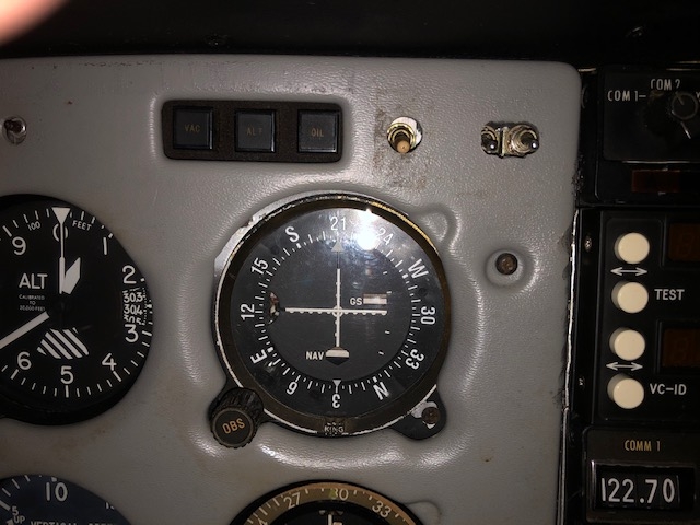

I purchased a 1977 Warrior II with the original panel (still had ADF and Loran). There are two very small switches close together at the top of the panel to the right of the wing-leveler switch. No one around here seems to know what they go to. Anyone on this forum able to give me some ideas?
  • Hi, can you post a photo or two? That's the only way to know for sure.
  • They are the two small toggle switches on the upper right.
  • This wasn't done by the factory, that's for sure. My guess is that an avionics shop did this, perhaps to switch the CDI between Nav 1 and Nav 2. You'll have to trace it back to find out for sure.
  • I think Scott's answer is most reasonable, the photo appears to reveal some adhesive residue on the panel surface, most likely a former label identifying the nature of the switch.
