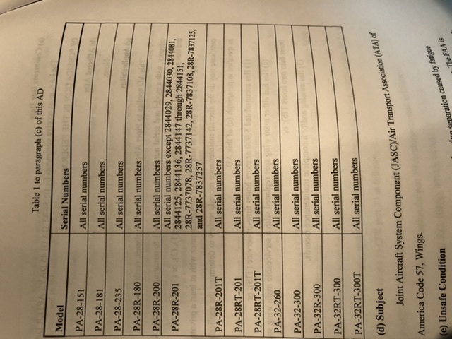

if you look at the formula.... seems it will exclude many aircraft for a long time but seems I want to get it done in the next few months just for piece of mind. So do you think if you get the inspection done under the Service Bulletin, you would be covered under the AD. Using their formula, I don't think my Arrow ever gets to 5000 with me owning it. But thats another story

I own a PA28-151 that would be included, yet the -161 would not. What is the difference besides the additional 10hp? If I were to put a 160hp on my airplane, would that then exclude it? I’m no aeronautical engineer so what do I know.
HI John, I wondered the same thing as I thought most of the fuselages were identical and only the engine was bigger. Other than I thought there was a change in length at some year!

Thanks for posting the affected aircraft list, John. And everyone, take a deep breath and see how this plays out. With the NPRM going through the end of the year it could be yet another year before the AD is actually issued. Then you'll have implementation time after the AD comes out. If it turns out an engine change could exempt you from the AD then you can research that change. Be calm.
I have a pa-28-180.... not included but the 181 is. What’s the big difference. Nobody I have asked really seems to know. It makes me wonder is I should just have the testing done just to be safe. But then all the talk about disturbing the joint and causing damage just to do the testing. It’s a pickle for me.

Angle228 wrote: I have a pa-28-180.... not included but the 181 is. What’s the big difference. Nobody I have asked really seems to know. It makes me wonder is I should just have the testing done just to be safe. But then all the talk about disturbing the joint and causing damage just to do the testing. It’s a pickle for me.
I have a 180 too, and my personal pet theory is this. When stresses are measured, a load moment can be used to calculate stress, similar to a weight and balance computation. The "short wing" 180 I believe has the same spar structure as the "long wing" 181 as everything from the flaps in I think is the same. Factor #2 is the 181's have a bit higher gross weight. Those two things make the load moment greater on the newer model spars. The two factors are likely enough to make the difference. Similarly the Arrow l and ll is our same wing with folding feet, but at a bit higher gross weight and about 20 knots greater speed. Both of those factors create more load. This is my assumption so do not take this to the bank.

Here is the response I received from the FAA when I asked the question about why the PA28-151 was included in the proposed AD and not the -161. This did not completely answer my question. I’m hoping that as this moves along, they will will further analyze the different stc’s and common airframes.
John, Thank you for your question. Variations in maximum weight and certified V-speeds among the various models may affect the flight loads. During the proposal comment period we are continuing to evaluate the effectivities based on computed loads along with voluntary inspection reports from the field. Keep in mind that most aircraft will not be affected by the NPRM based on the factored hours formula.
