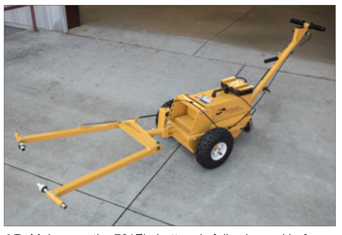

Here is a photo of the tug that I use. It lifts the nosewheel off the ground while moving the plane.
https://www.pricelessaviation.com/wp-content/uploads/2017/03/701E_Quick_Set-up_Inst.pdf
This one works great on a Saratoga:
https://redlineaviation.com/sidewinder-for-piper/
Good luck.
I second the sidewinder...I've had one for a few years and works great...it's also portable enough to put in the rear cargo to provide "ballast" if needed and move your bird at the destination.
I second the sidewinder also
