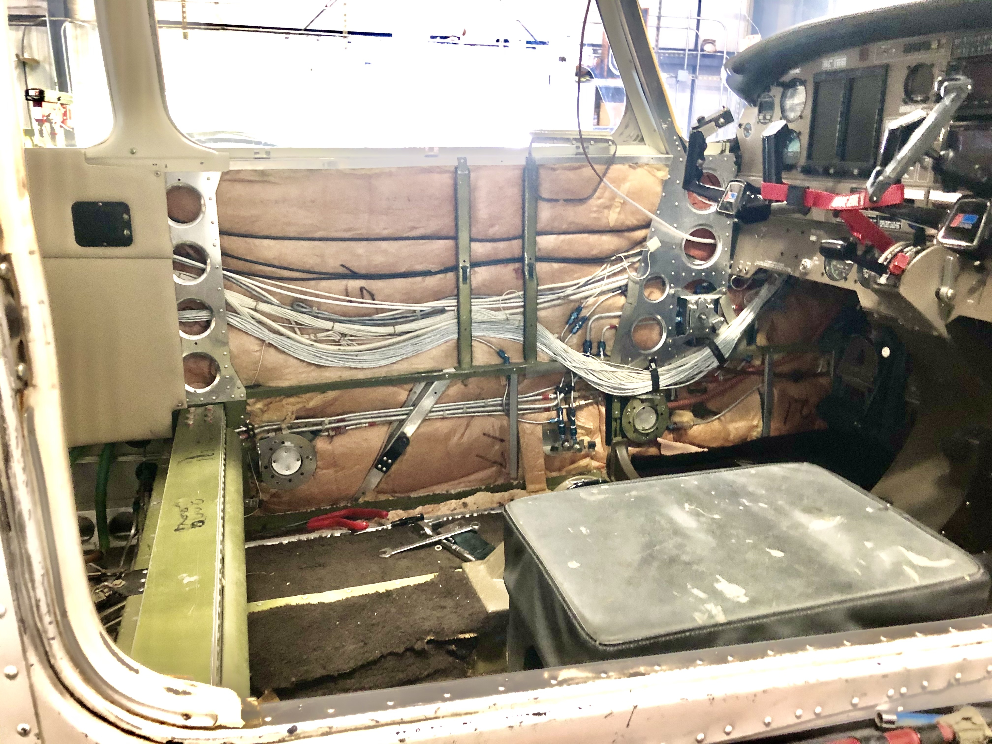

Adding to Jim's comments, it is also where all the wiring crosses (and sometimes breaker panels) up and over the spar carry thru.

Here’s what’s behind the side wall.

Also FYI my new single piece windshield requires a lot more work installing that I had thought. The plane had to be up on Jack’s as if in flight to get the correct placement and torque for the new windshield and center post that was removed, replaced with another structure supported post. Albeit smaller but required![](https://www.piperowner.org/talk/uploads/editor/bf/mp7yshfood10.jpeg)
![](https://www.piperowner.org/talk/uploads/editor/pu/obt0o0fi3sk7.jpeg)
![](https://www.piperowner.org/talk/uploads/editor/7g/fw1rjrcbopno.jpeg)
for structural.
KPJS.llc
N6399C
AZ
That center post is structural and if you remove it without supporting the airframe, you'll bend it. I'm glad your team actually read the directions before starting. I know of one airframe that was totaled this way. It's looking good, keep up the great work!
