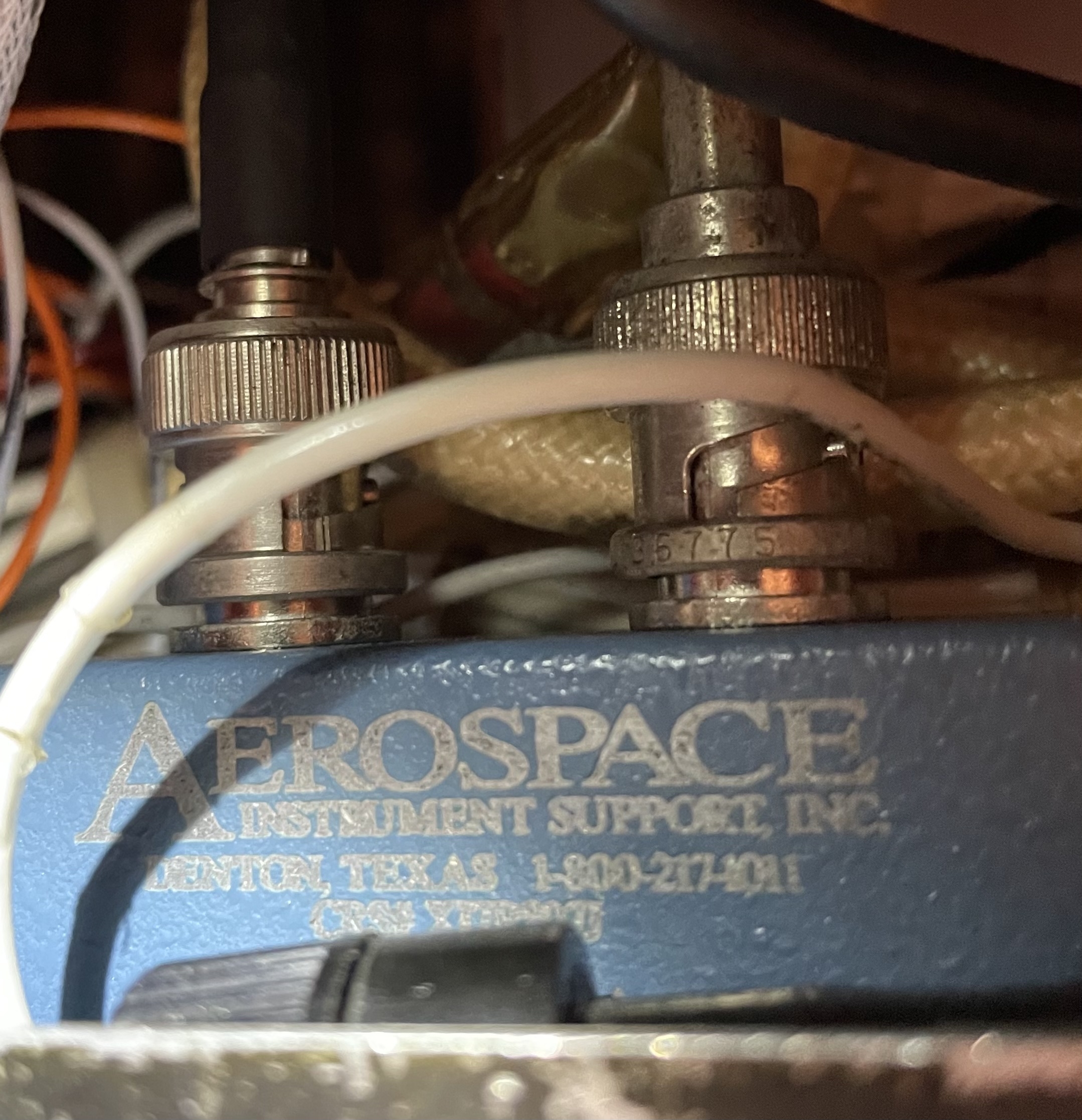

The company that made this device years ago is Aerospace Instrument Support, Inc. in Denton, Texas. They are still in business, but I called them and they no longer manufacture this unit. They told me Bendix King made something similar. See photo attached. I did not use the phone number on the device but looked them up online.

My avionics shop installed a 3mm jack setup exactly like MikeJJ's - When I plug the BNC/3mm antenna cable into the panel, it connects to my #2 Comm antenna and disconnects the Garmin 255. No idea what device they used to make the connection.

MikeJJ writes " The cable to my hand held radio has a BNC connector for the antenna on one end and a 3mm phone Plug on the other..." (Also Ken)
I gather your photo shows the back side of the connector box, with one BNC cable coming from the radio and the other going to the antenna. The 3mm phone socket is a common audio component, often used to disconnect an internal speaker when you plug in headphones. It has 3 terminals on the back - one goes to the ground sleeve on the plug, the second goes to the tip of the plug, and the third is connected to the second as long as there isn't a plug in the socket. Buying the box from Aerospace would be a convenience, but it's easy enough to make one up if you're handy with a soldering iron. It's still a good idea to enclose the wiring in a box to shield the transmitter signal.
Scott writes "https://www.aircraftspruce.com/catalog/avpages/rami-dplx-av590.php".
Careful. The description of this box says it uses the voltage from each comm radio's PTT switch to connect that radio to the antenna exclusively. With neither PTT pressed, it connects both radios allowing both of them to receive. Problem is getting the PTT signal from the handheld to the box, and you absolutely positively need this. The headset adaptor of my Icom A-24 has a jack for an external PTT switch, so maybe it's possible to get a usable PTT signal out of there as well. It all depends on how the PTT circuit of a particular radio is wired, and at least in my case, it's not something the manufacturer intended.
The device that Andy is referring to is the Icom Antenna Switchbox. It shares an external antenna with a simple device that detaches the panel radio while connecting the portable. The portable must use a BNC connector. The device is a box mounted behind the panel with a small hole in the panel that exposes a standard mini female plug. The unit comes with a 4' cable with the male sub-miniature plug on one end and the BNC on the other. The aircraft antenna plugs into the box and you need a short cable from the box to the panel mount radio. Now, you remove the rubber ducky and attach the BNC end to the portable.
Now, when you plug the 4' cable into the panel, the external antenna is disconnected from the panel radio and connected to the portable but ... unfortunately, ICOM may has discontinued this? I can't see anyone selling them. My other advice is to keep the radio very simple and as mentioned, use only store bought batteries, forget rechargeables in the back-up role. They lose their juice and can't be depended on in an emergency. Forget all the bells and whistles that are available in these portables today. You will use the portable to talk your way down. If you're thinking your going to fly an ILS with a handheld ... forget about it. The basic Sporty's SPA with com only and alkaline batteries gets my vote!
