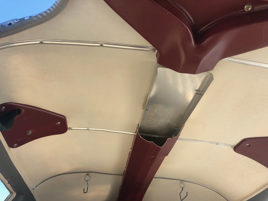

The air duct on a 1973 Piper Arrow that moves air from the tail vent to the distribution ducts is trashed on my plane. I don’t know what it is called to look it up to but it on line.
Here is what it looks like. It runs on the ceiling.
How do I look this up?

I cannot get the photo to attach. It is not known as an ac duct. How do I look it up?
The ducts or plenums are available from Knots2U at https://www.knots2u.net/categories/piper-single-engine-models/pa-28r-180-pa-28r-200-models/interior-parts.html?sort=featured&page=2 . Check out this link.
I would say almost all of them are trashed - just some are more obvious than others. www.planeparts.com also has them. They get very brittle when old and how they were attached in the first place is not ideal.
The other challenge is it is not a proper plenum as too many turns, too rough, and not enough pressure from the vent fan. Should have either boost fans, or dedicated hose to vent outlets. I only care when it is hot and it is cooling off around here now...![;) ;)](https://piperowner.org/talk/resources/emoji/wink.png)
