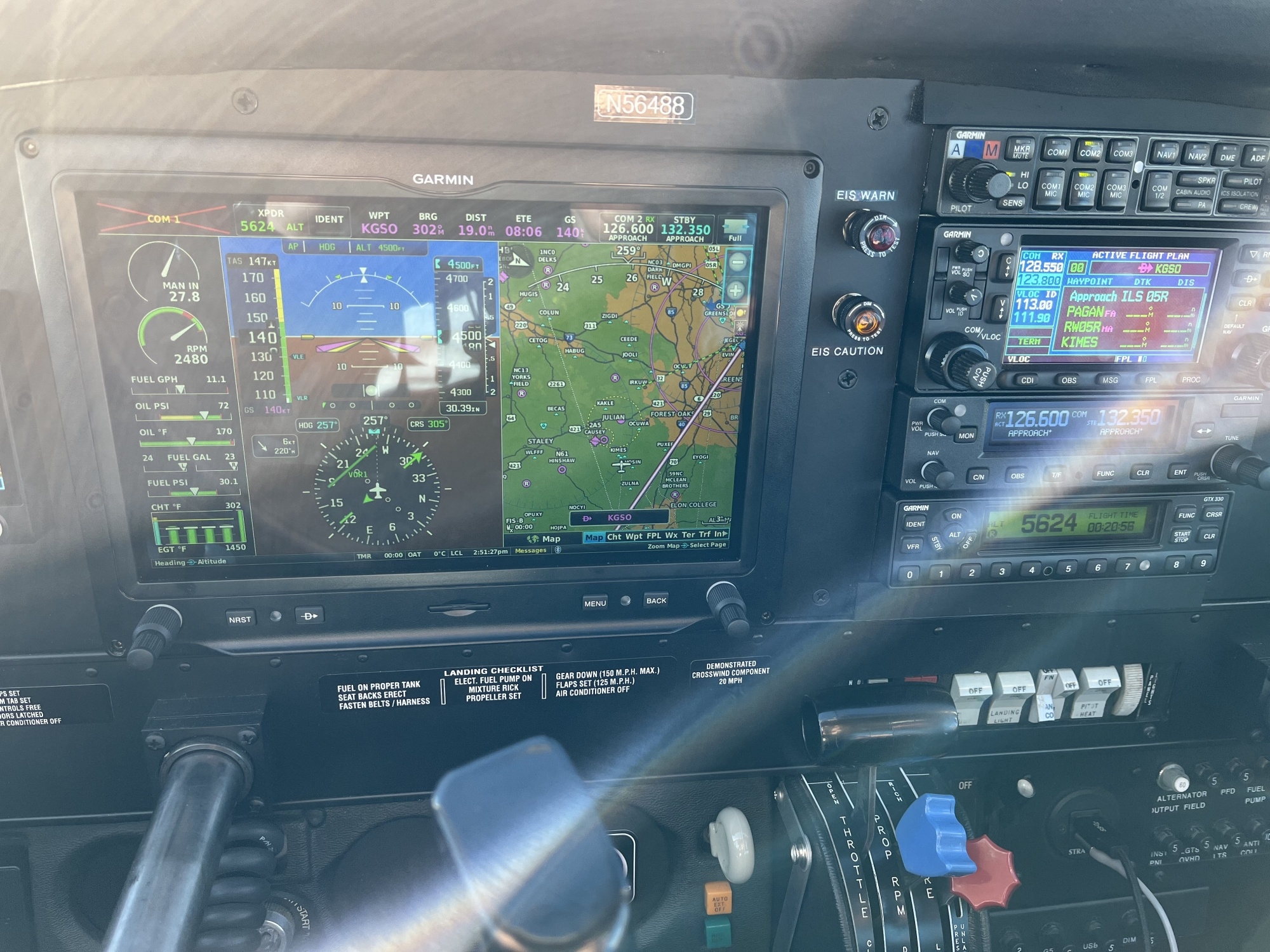

Hello, I have a normally aspirated piper arrow with IO-360 200hp engine. After a good wash and wax I was registering 147Kts TAS at 4,500ft with a 6knot quartering headwind. My wish list is to find the Lo-Presti howl cowl. Has anyone seen speed numbers like this?
I have most of the available speed mods that I am aware of. Would love to streamline the cowling, and also would like to get rid of the temp probe pilot side window.
Wish I knew how to get my hands on the Lo-Presti cowl. Throughout Covid, flying has been what I look forward to!
Notes: I had my MP corrected on the G3X as it was showing about 3inch above book values. My #1 comm is out bc contrary to what I was told by the AV guy at time of purchase the 430W doesn't completely work. On the waiting list with Sarasota for a GTN 650xi.

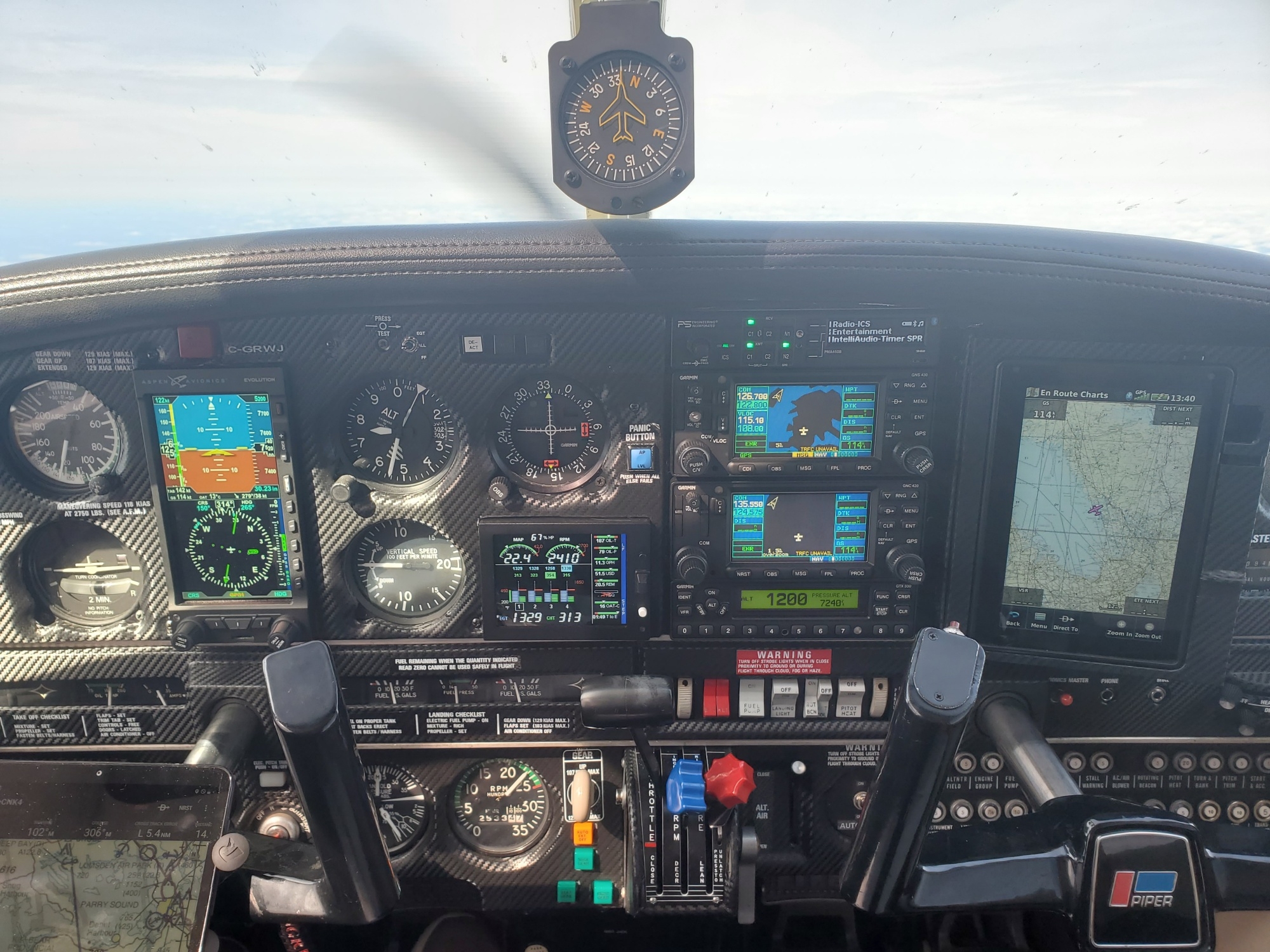

My "Hershey Bar" wing Arrow I (200) regularly cruises at 140+ KTAS with a 2 blade prop. Photo was taken today just "warming up the oil"
! (G5 airspeeds are in knots) I don't fly at low altitudes often so I don't know what it would do down there. Be an interesting thing to try. !

I would be curious to see if your temperatures would come down and better fuel economy?
Bill...No, I haven't tried running "over squared". My throttle is always wide open at this altitude. The red arc is for prop vibration according to the placard. According to this I would need to be less than 2100 rpm but even then it wouldn't be "over squared" at 9500 MSL!

Thanks! Next time I fly to lower country I will give it a try!!
