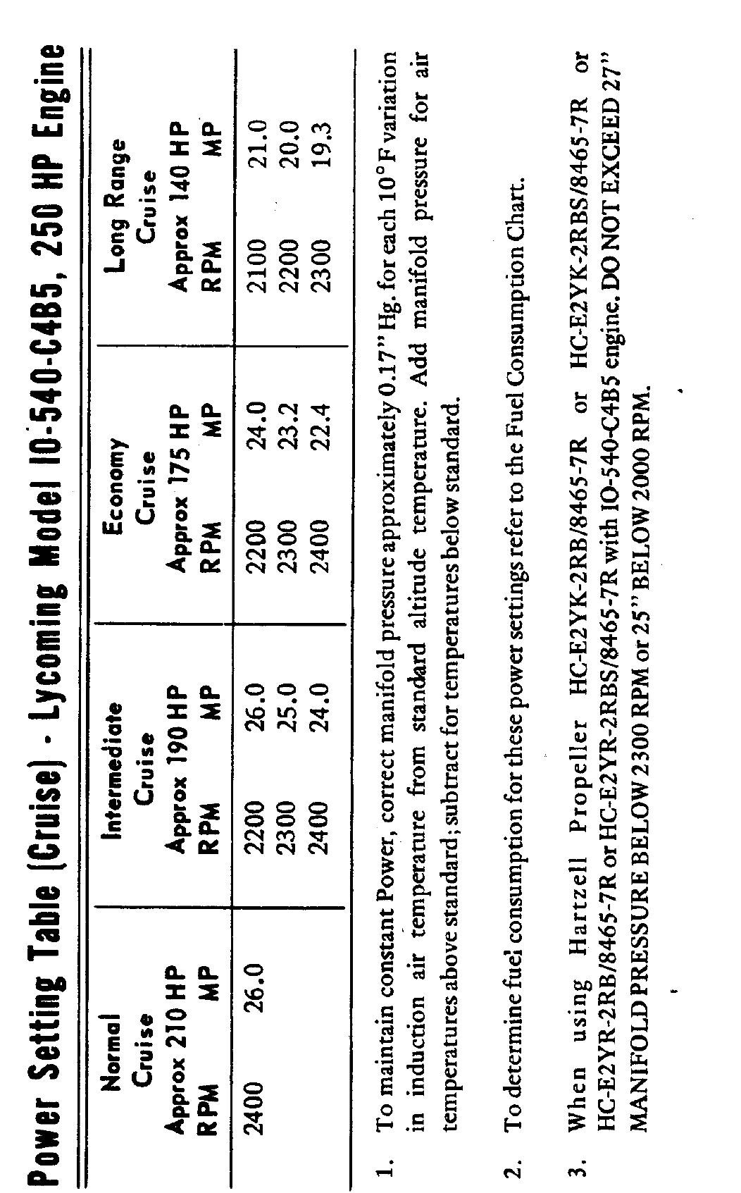

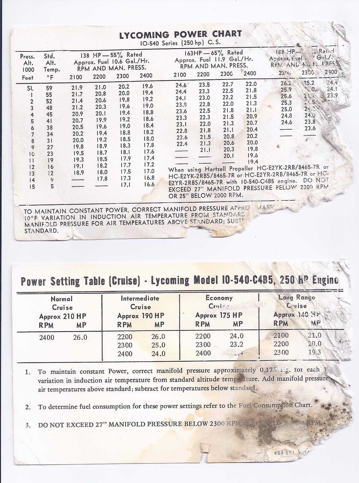

IO-540 C4B5 engines overhauled and was wondering if anyone has a copy of the Lycoming power chart IO-540 series (250hp) C.S. chart and the Power setting table (Cruise) - Lycoming model IO-540-C4B5 250HP Engine. As over the years the original ones we were given are becoming partially unreadable. Regards Mike Cromati.
Attached might be a little better if you play with the print contrast settings...
Here's the other version from the POH...
