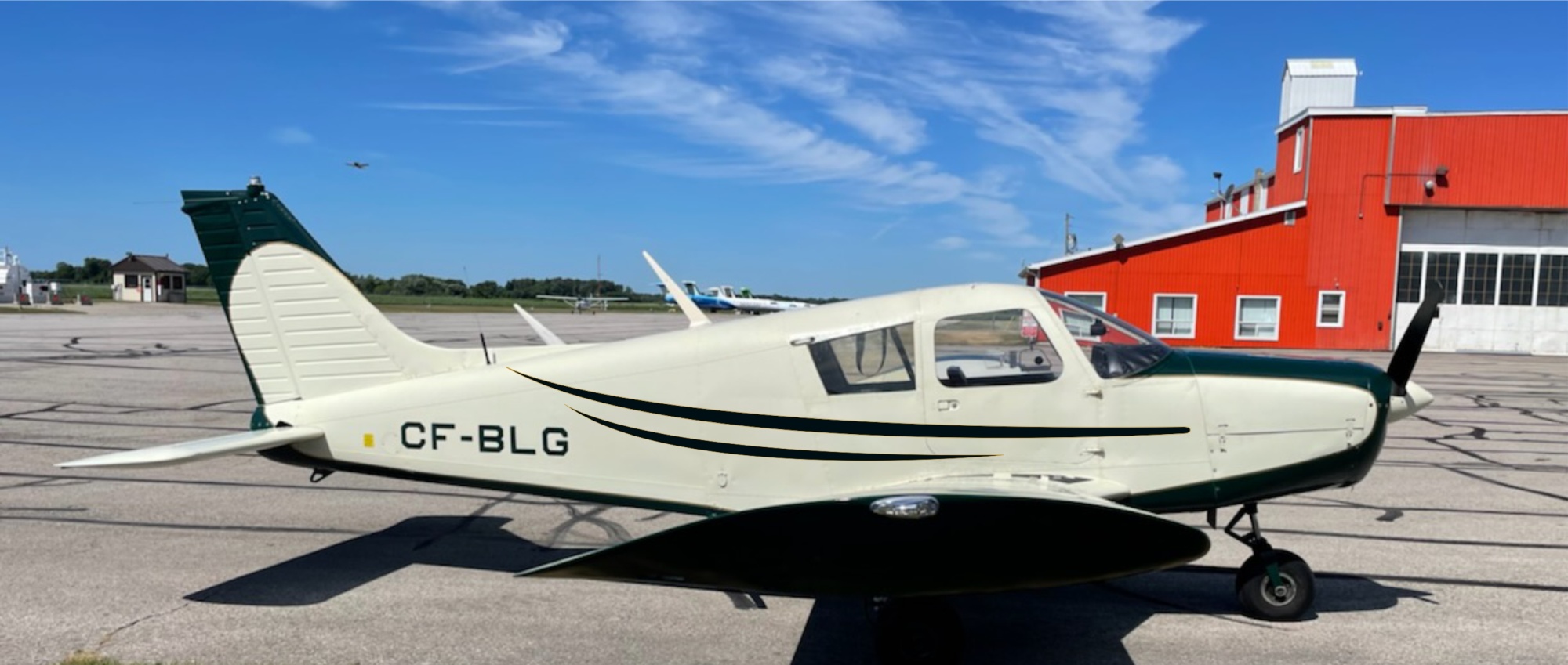

I own a 69' 140 that I'm restoring. Check out my posts on tbe saga so far. Remove the stabilator and vertical stab.! They are never looked at! Also look at the firewall! When the airplane is stripped you'll probably find a lot of corrosion.
I bought a 1972 PA28-140E with 5600 hr TT and 2400 hrs TT engine. Sitting abandoned in a dry hangar 13 years. I paid salvage price for the airframe after a very careful spar inspection. I went into the purchase / rebuild knowing it needed a new zero time 160 hp engine & prop. Lots of TLC and AME time has it back flying for lower than market resale. Engine was $35,000 (CDN). alone. New 406 ELT, Whelan LED lights / strobes, new Horner wing tips, Art Mattson VG, lots of misc. pulleys and bushings. Having built 3 airplane kits I knew where the big money goes in aircraft. Radios are old but work great, transponder mode C works.... no ADS-B needed yet here in Canada but its coming soon. New complete Airtex interior installation will be completed by weeks end. Happy with my purchase / project. But it has to be purchased at the right price to be restored.
