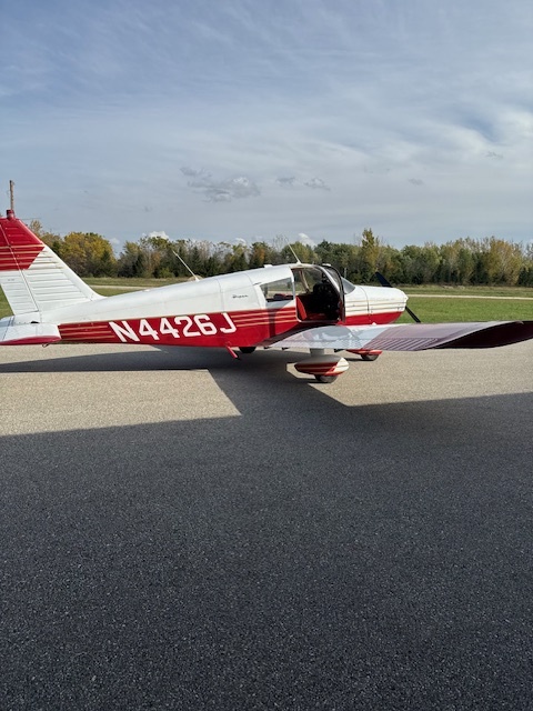

Hi Scott welcome to the forum. Looks like another nice cruiser. It's almost comical it looks like all the very early 140s are coming out of the woodwork. I didn't think you were that many still for sale. Look forward to seeing more Carl
Beautiful 140! Tell us more! Don't be a stranger. Where are you based? What type of flying do you do? How is it equipped? Any plans for upgrades or just enjoying the view out the window?

Based out of Marion , Iowa. Currently in training, plan on updating the flight deck when funds and schedule allow. Flys real nice ,very responsive compared to the Cessna i started in. Low airframe hours .
Thanks for the update Scott! Enjoy the training, and don't be in a hurry to make major changes. Those dollars go a long way toward fuel and long cross country adventures. Even after spending large sums on panel upgrades, the view out the window never changes 😉
