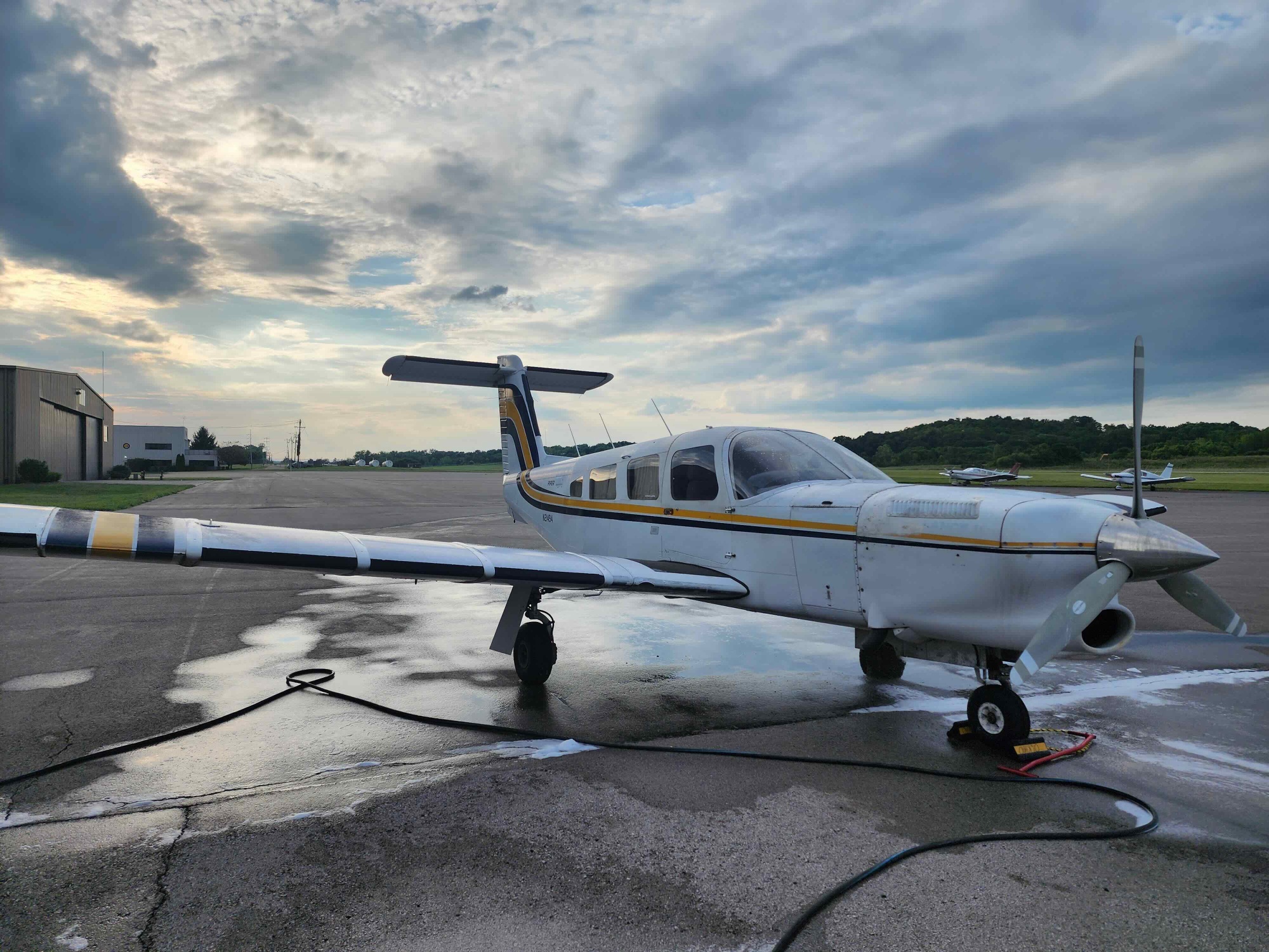

I just bought a 78 Turbo Lance II - T-tail. I'm working on my PPL, and saw this beautiful aircraft abandoned at my airport. I had no choice but to rescue it. Pre-purchase inspection seemed good enough - I saw an opportunity, so I took it.

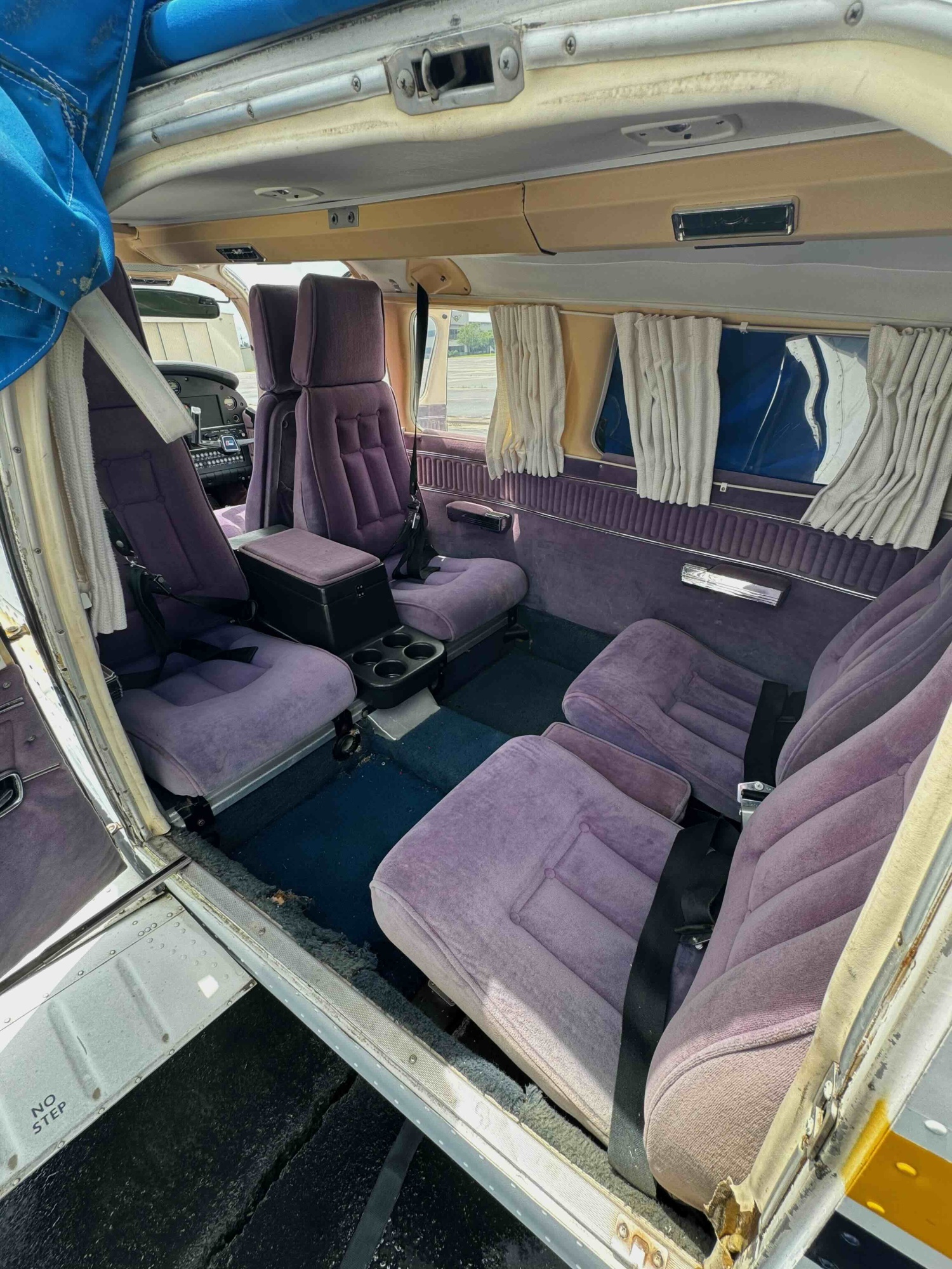

Currently going through annual to make it airworthy again. I'm waiting on an Airtex interior to come, though I'll miss the plush purple. Maybe getting it painted, and avionics TBD. I'm sure I'll have a lot of questions.

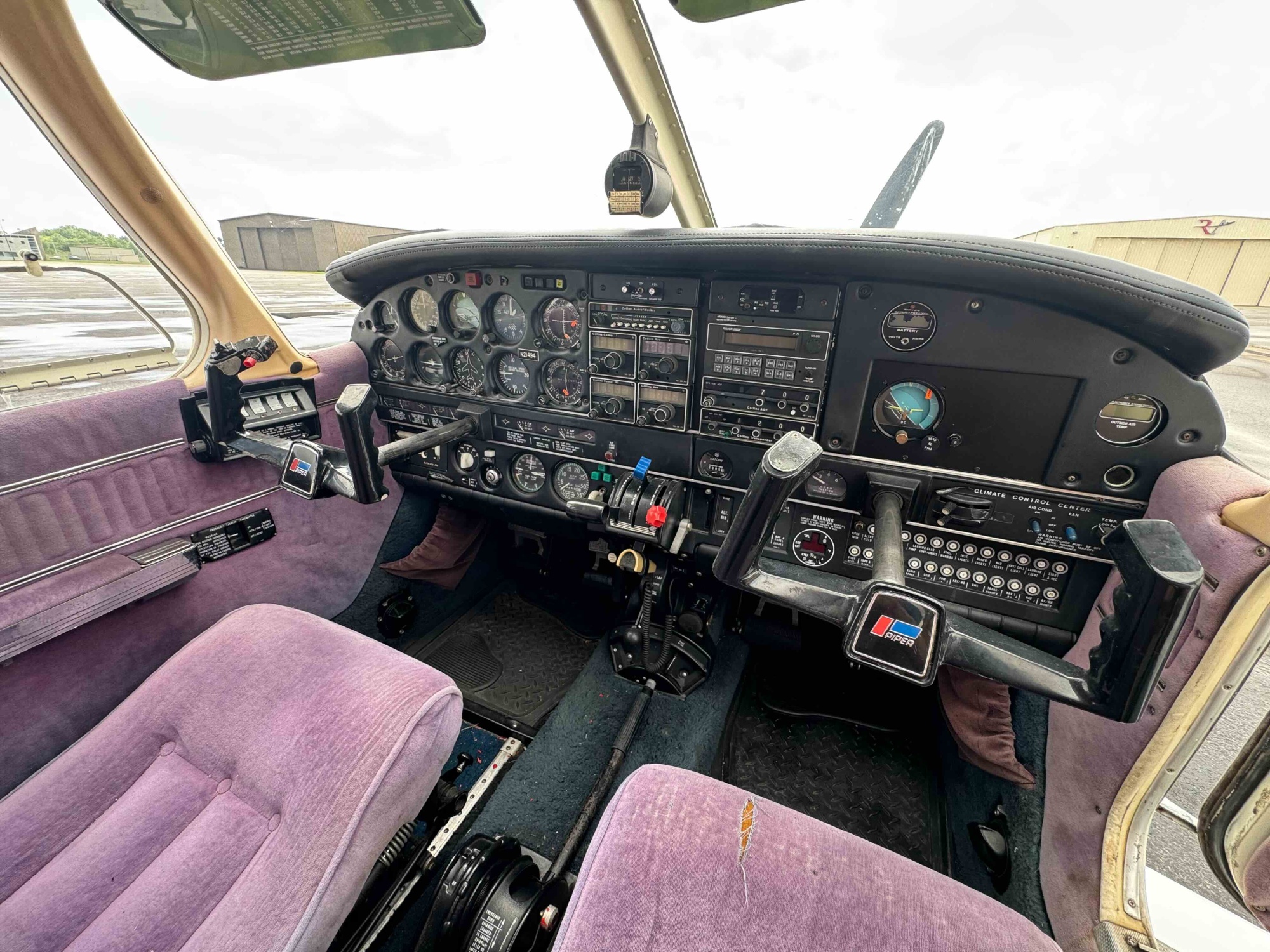

  • Wow! Nice purple seats! What kind of engine it has?

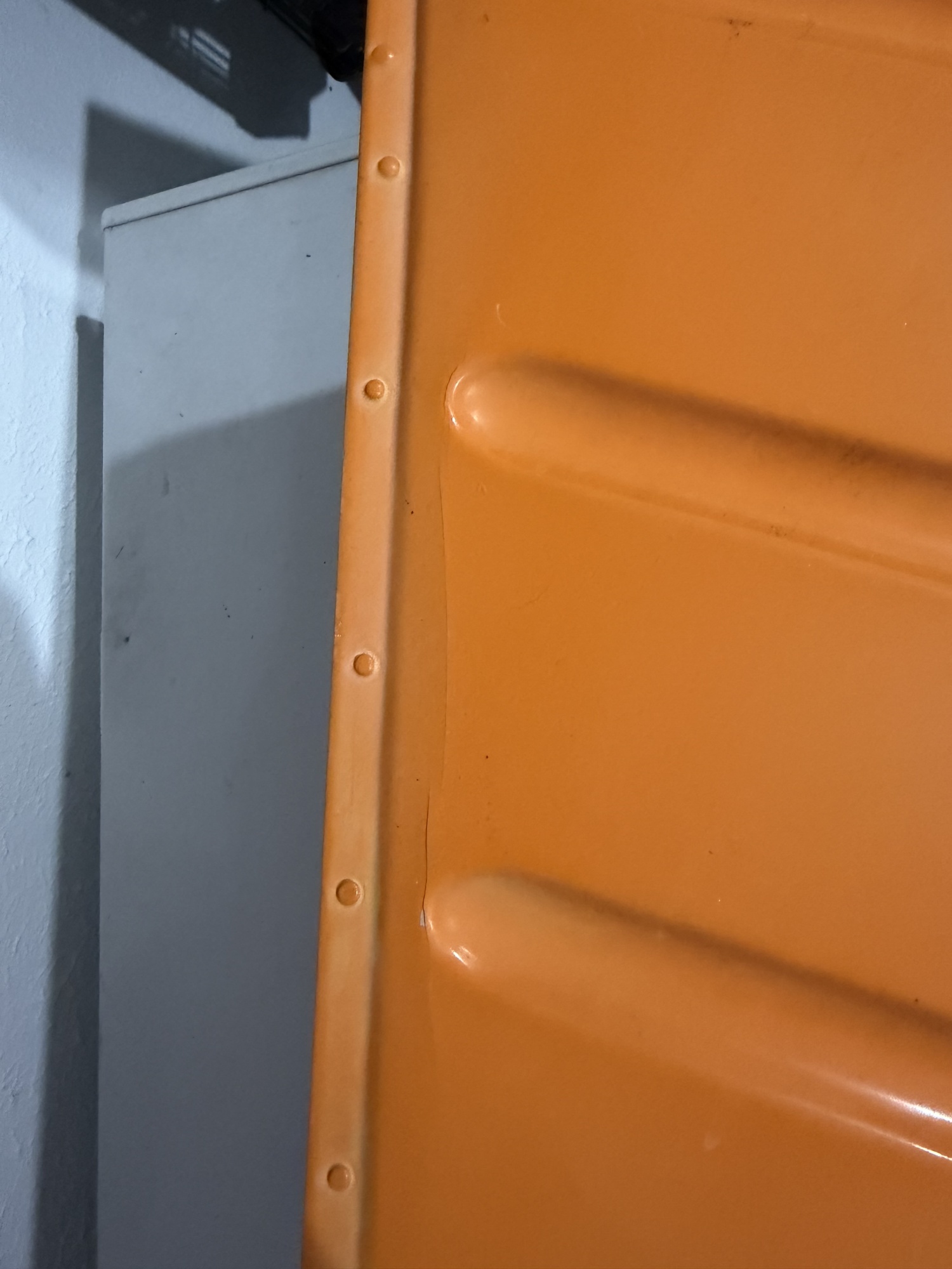

    One question - I have cracking on my rudder so I bought a used one. I see so many different part numbers for the rudders and rudder skins regarding the AD. The one I bought has a support strip and rivets at the trailing edge. My understanding is that this is the most recent upgrade Piper made to correct the issue. Is that correct?
    This picture is of the new part I bought. The cracking shown is only in the paint. The metal is ok. All other rudders I've seen have folded skin on the trailing edge. Anyone know the story?
  • YouTube answered my question. What a great video by Airframe Components! This orange rudder was the most recent design change by Piper to address cracking.
    https://www.youtube.com/watch?v=GF5jtn-ajyA
  • Glad you found that Dave I was going to recommend airframe components. They really are one-stop shop for flight controls especially for Piper aircraft. Thanks for the link, Carl
