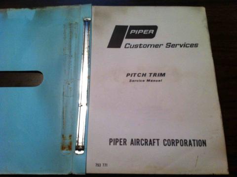

  • Looking for one of these?

  • Hi ch67guy1
    Well, that is the manual I am looking for! That would make my life a lot easier and would answer some questions. How can I get a copy? Do you want to sell it, make copies, what??

  • If ch67guy1 is up for it, I would happily scan (free) to PDF this hard copy for archival usage and post.

  • PLEASE STAND BY! YOU ALL WILL SOON HAVE ACCESS TO MY PITCH TRIM SERVICE MANUAL!
    I'm sorry folks! I haven't been on this website in several days. I was under the impression that if someone added to a thread that I had written to, that I would get an EMAIL in my regular email, letting me know that someone had added to the thread.
    So I'm sorry it has seemingly taken so long to get back with you all, as it seems at least a few of you are anxious to get your hands on this service manual that I have. I'm planning on keeping it, but you all can have PDF copies of it.
    I am planning on scanning the "Pitch Trim Service Manual" as a PDF file this weekend.
    I actually found the manual at the "Fly Market" at Oshkosh last year, and SIMPLY KNEW it would come in handy someday!
    Once I scan it, then I could place it in Dropbox and provide a download link for anyone who wants a copy, free of any cost.
    I have to add the disclaimer that this manual is dated 1970, so it is for ENTERTAINMENT PURPOSES ONLY <wink wink>.
    The manual has several pages that fold out, so I need to go to Staples and shrink those down to fit the bed on my scanner.
    The whole operation shouldn't take very long to do. I'm good at scanning. Thank you for the offer from the person to scan this manual for me. I appreciate it.
    Let's say that I hope to post to this forum tomorrow with a download link for the scanned Pitch Trim manual.

  • Click HERE
    for your very own copy of the Piper Pitch Trim Service Manual.
    Be patient as this document downloads to your computer. It is 130 pages, and the file size is 42.9 MB.
    Once it is completely downloaded, you can print as many copies as you like on 8.5" x 11" paper. Don't try to print this on an ink jet printer. I'd strongly recommend using a laser printer on at least 20# paper.
    KEEP IN MIND THAT THIS SERVICE MANUAL IS MARCH 1970 ISSUE, AND HAS NEVER BEEN UPDATED!
    If someone out there absolutely positively wants my original copy of this manual, send me $50 and I'll be happy to send it to you. But you won't be getting anything that is not included in the above download.
    If for whatever reason, you'd like this manual printed out on nice clean white heavyweight paper, I can provide that for $25. This is simply for my time and materials in printing the manual. I'll even punch holes for a 3 ring binder, and when you receive it you can place the pages in your own 3 ring binder.
    I scour the "Fly Market" at Oshkosh every year for these sort of manuals to help keep us all flying. Your best bet is to just use the above download link and print it on your own.
    You all take care.
    Charley

  • To be fair, this manual is NOT a overhaul/adj manual, just covers installs and check outs in various pipers. I'v had this manual for years, really not too helpful in tryng to make a sticky and stiff Pa28 series pitch trim do anything better.
