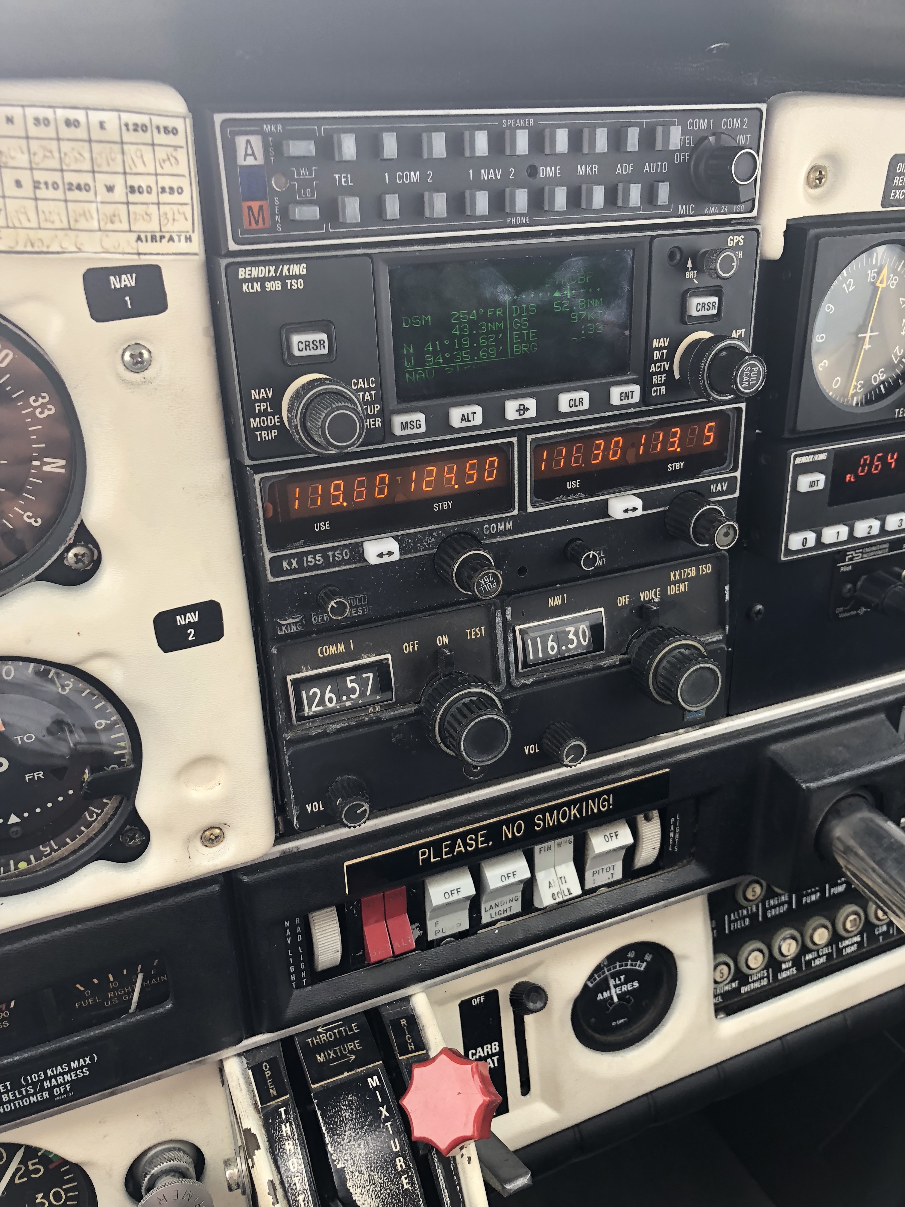

I would like an entry level IFR GPS, currently I just have an older VFR GPS which is really just a back up to my iPad / Stratus 2S. I also have been trying to figure out how people afford avionics, I see folks getting full stacks of Garmin gear and it is twice the cost of the plane itself. I plan on pulling out the ADF as well, it is INOP and I don't see much fo a future for it anyway. Just trying to figure out what I need to save for while I am also working on getting 25 more hours of Cross Country...
Hi, so let's get you started with some ideas. First, as you surmise, there is no place on your panel for an ADF anymore, or for that matter, a DME, if you have one. Second, get rid of the KX170 and replace it with a TKM MX-170. They are $3k new and about $1,500 used. They slide in and you don't need any shop time. Your audio panel is okay in the short term but a used Garmin 340 audio panel is about $800 used and is outstanding. It will cost you about $1k to install it and it will last forever. Finally, throw out the kx-155 and kln-90 and replace with a used Garmin 430 for about $6k and $2k to install. You'll have a pretty modern panel for under $11k, complete. Now you can fly IFR when you need to and get home safely.

I am impressed, I like it but where does one purchase used avionics? I was looking at the Garmin 430 but I wasn't sure if that was the only option for an entry level GPS, not that I think it is bad just not a huge Garmin fan.

Scott is the “go to” source on this site for info, but I will chip in...I don’t know your thoughts on Avidyne products, and I don’t suspect many used IFD440’s on the market, may be worth a look? I am, and I know Scott is, a fan of Avidyne’s user interface.

Yes, indeed. If I recall, they have a 30 day guarantee on everything. But 30 days isn't alot of time to get a shop appointment. If you buy from there, and can afford it, have it sent to an avionics shop right away and tested thoroughly. JA Aero in Illinois is one such place that will test and yellow tag for $100 if my memory serves. Anyway, yes, Wentworth is good.
Regarding Garmin versus Avidyne. You can't go wrong with either. I've had a Garmin panel since 1992 in many airplanes. My last Seneca had a Garmin 530 for a dozen years and I loved it. I replaced it with an Avidyne 540 three years ago and have really loved that. Both functionally and cost. It slid right into the Garmin 530 slot with almost no wiring. When I got my Arrow last March, replaced the Garmin 650, which worked well but I didn't like touch screen very much with another Avidyne 540. But it connects perfectly with a Garmin 345 transponder. You won't go wrong with either. Avidyne is like Avis Rentacar, they try harder, lol.![:) :)](https://piperowner.org/talk/resources/emoji/smile.png)

Well I am going to start with the Transponder, I will see if my local avionics shop has any 430's laying around, they are a Garmin dealer / installer.
