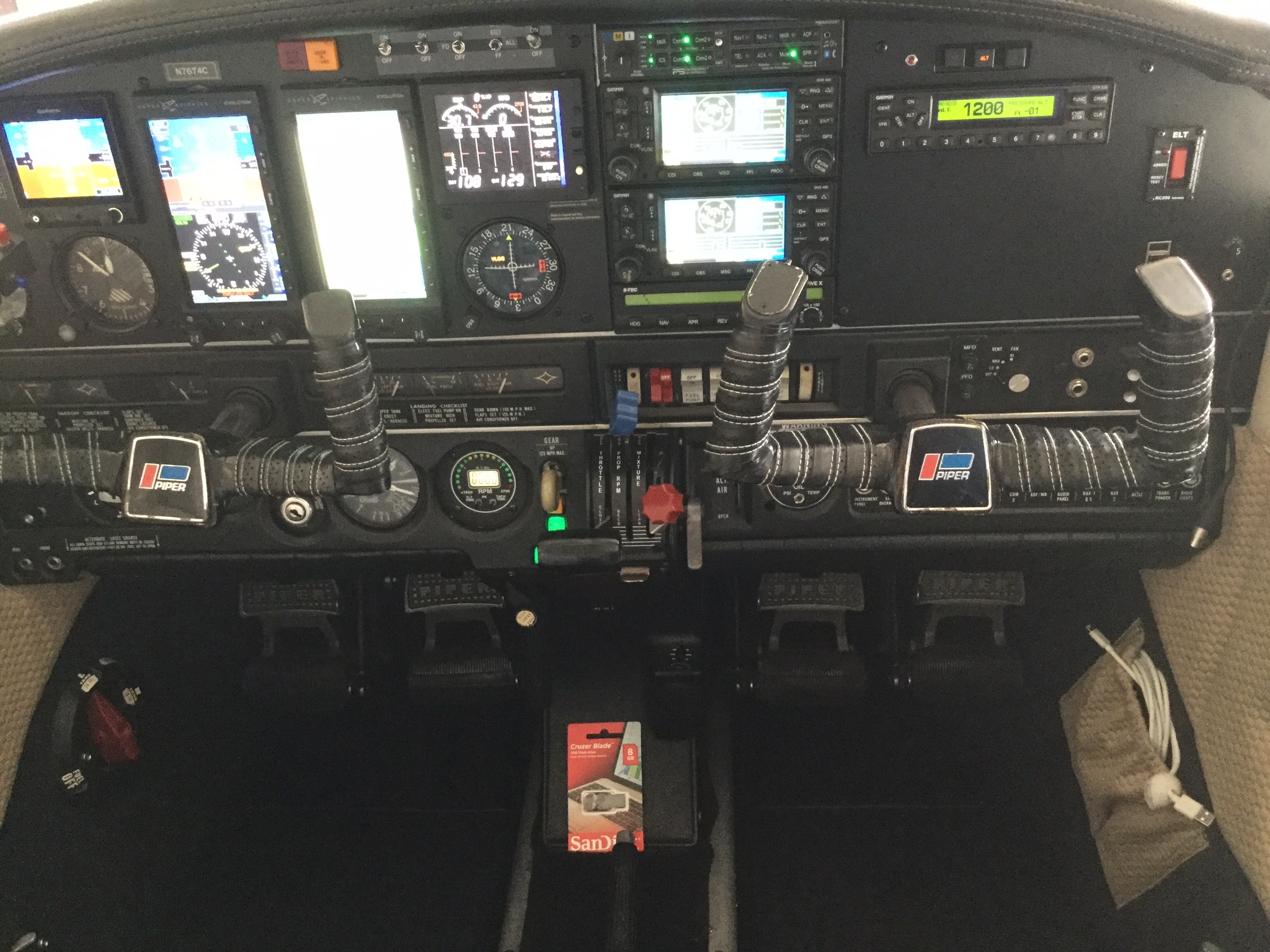

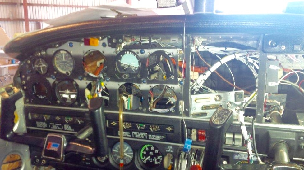

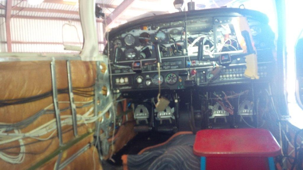

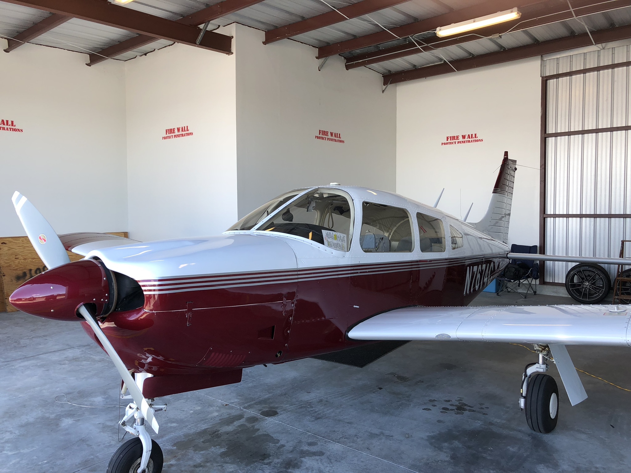

My mistress, a 1976 Arrow II
My project is 1976 Arrow II, w Knots 2u speed mods, dual GNS 430W, G5, GTX 330EX, Flight Stream 210, JPI 830, Aspen Evolution Pro 1000 w PDF w/synthetic vision & angle of attack (Pro 1000 w be update in July w Max) Genesis 55X, PS engineering PMA8000
Though you like the project!
She cleaned up pretty good didn't she. She's the kind you'd like to flaunt and take to dinner, she's a lady.
Super panel. Really like the Aspens
Excellent job
Great job and a lot of work. I have the Apsen system also in my 76 Arrow. Spoils me for sure. Can't quite figure out what you put in place of the old Altimatic IIIB autopilot.
Wow...looks sick... do you mind my asking how much the yokes cost you? And are they easy to install DIY?
I replaced the old piper Altimatic which was only a two axis autopilot with S-TEC 55X three axis autopilot with preselect alt and alt hold.
The yoke grips are DIY, actually a bicycle leather grips, very easy to install, not approved. Cost is about $6.00

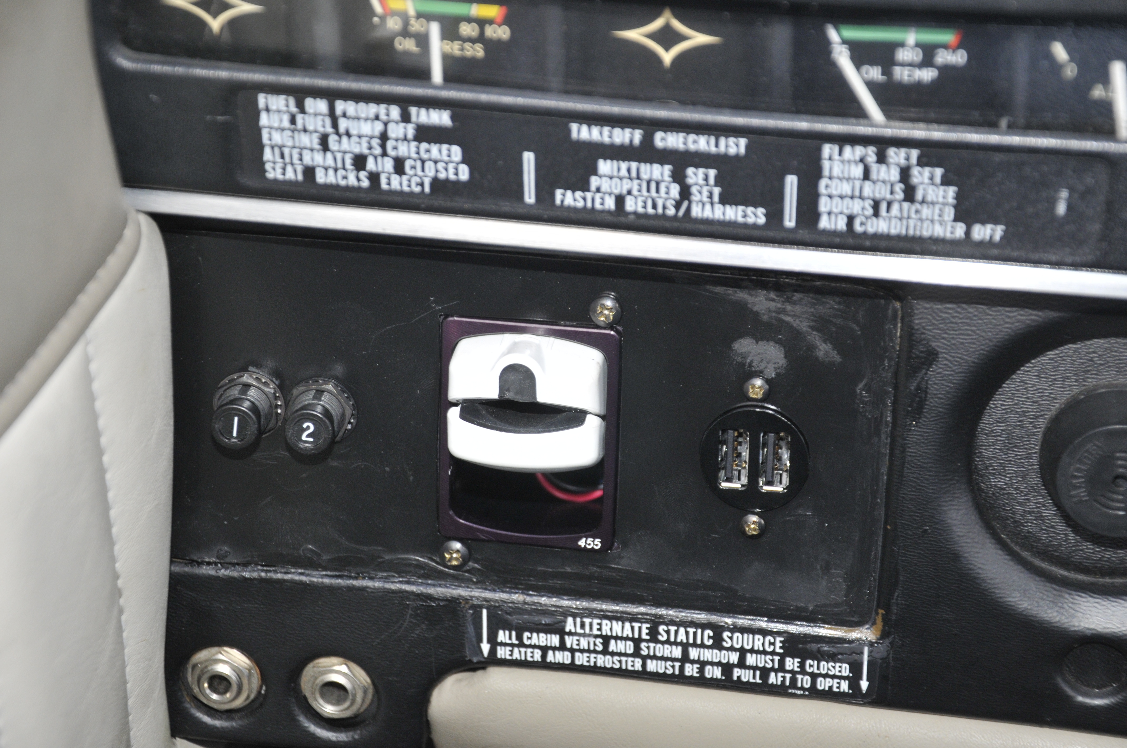

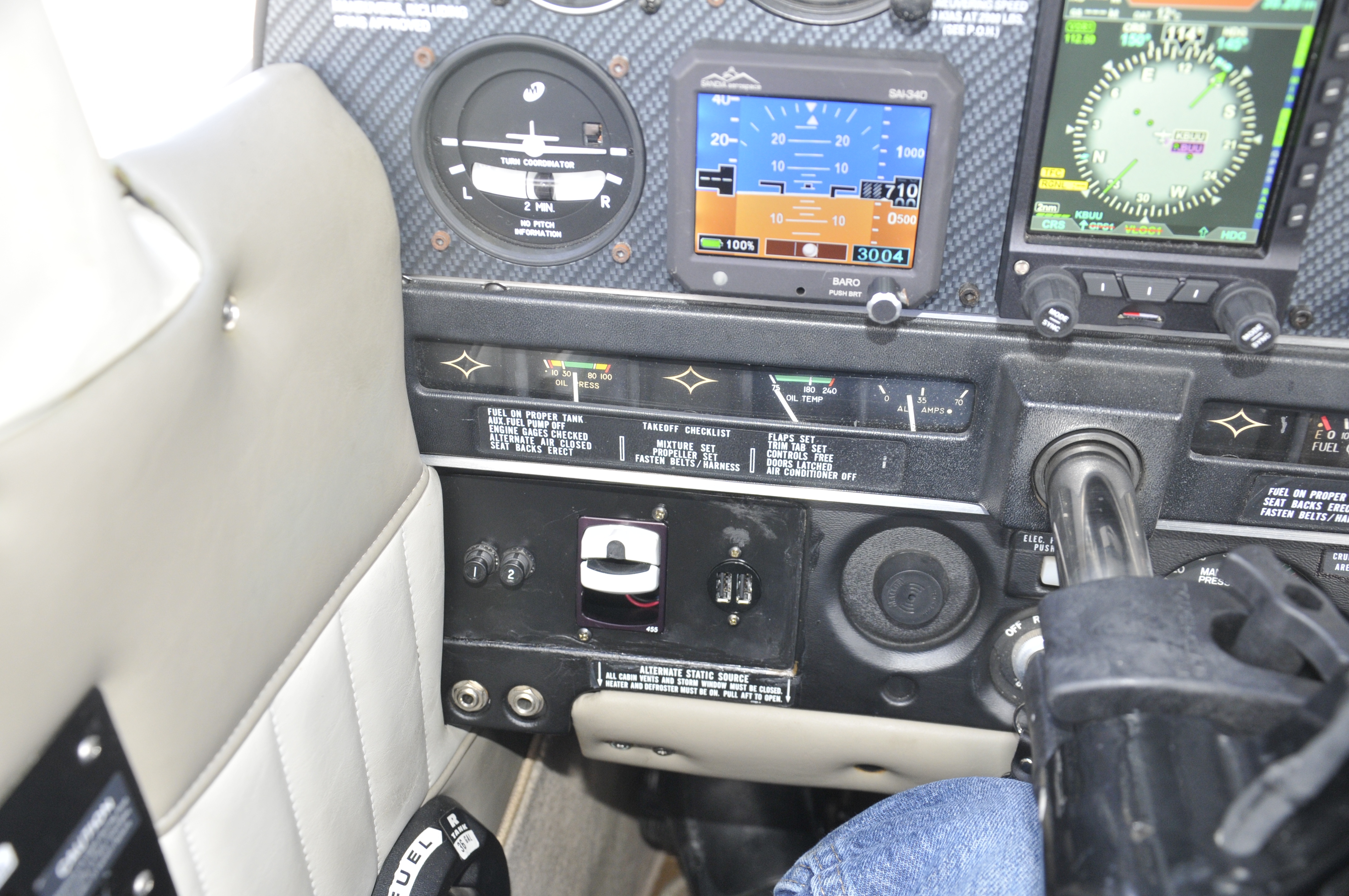

Austin, regarding your old autopilot hole on the lower left side of your panel. I just had that filled in last week. Here's a pic.

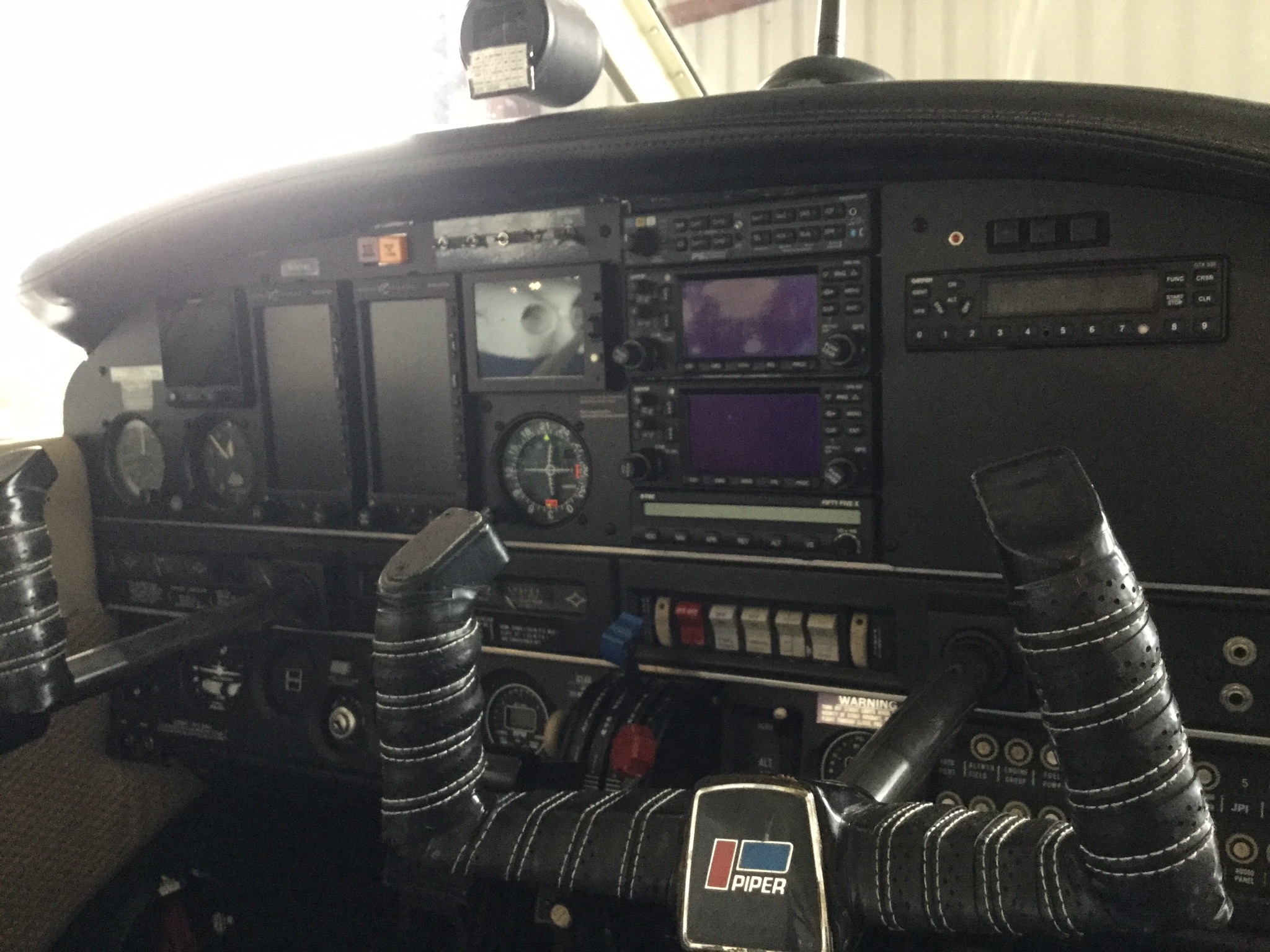

Totally cool. Attached is photo of my panel w power.!(http://piperowner.org/talk/uploads/editor/fd/wqfn5dgypazw.jpeg "")
Very nice!
What is that thing to the right of the two CB's?
I think your referring to JPI 830
Nope Brand spanking new Guardian Carbon Monoxide detector with Pulse Oximiter. It displays on the 830 engine monitor. And next to that is USB power for my Ipad.
