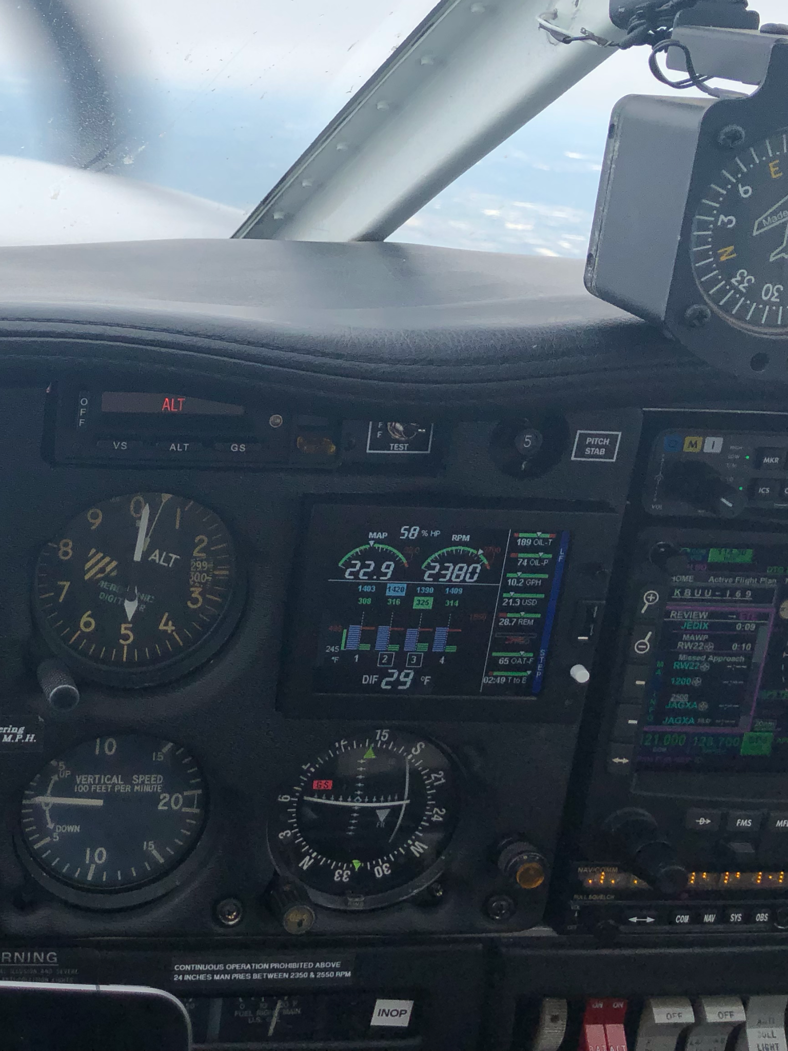

For what it’s worth, I just installed the 830 in my Arrow. The RPM on the JPI is pretty significantly different than the RPM on the mechanical tach. Where I had it mounted, it is easier to see as well. However you decide to do it, you’ll love this engine monitor.

It is perfectly in my line-of-sight and part of my instrument scan now. Although it isn’t technically the primary instrument for my MP and Tach, I use it almost exclusively after I get the engine fired up and appreciate not having to look down at every power adjustment, especially in IMC.

Same here, Jim. I have mine vertically and yours in horizontal, if memory serves.
