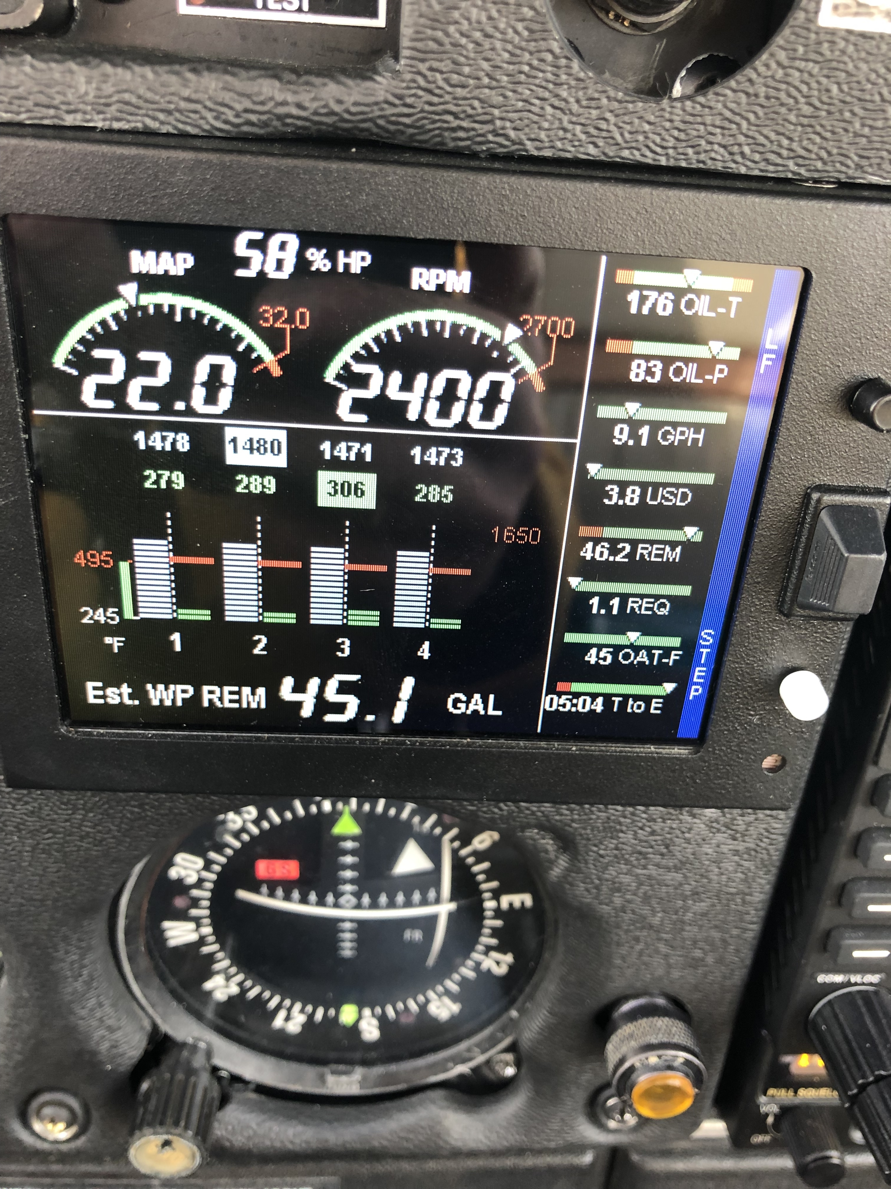

New engine...flew for the first time just now. Holding pattern over my home base with MP and ROM varied. Some observations: Fuel pressure gauge NO LONGER flutters! (?); Cyl head temps all in low 300's with EGT mid 1400's. Oil temp 175 (OAT +10). Oil pressure 88...Is that too high? Using Phillips XC mineral oil. Mech adjusted check valve but pressure only went down a little. Flew for about one hour...no leaks and "new engine smell"!! Seems to me (!) that engine runs smoother and is quieter that the old one. Maybe the "roller tappets" help it to be quiet?? Tomorrow I will head for low country (4500 MSL) where I can get higher manifold pressure. Now to get the old engine shipped to Lycoming so I can get my $17,400 core charge back!!!

Congrats on the new engine! Your numbers are identical to mine. My CHTs have actually dropped into the 275-295 range in cruise now. Also, my oil pressure is also at the high end of the green arc. I have noticed that when I have more than 6 quarts it runs a little higher than when I have right at 6.
I am curious to hear what you get for speed and fuel consumption with the new engine. I have been running 22” and 2400rpm at 9.2 GPH and seeing about 140 MPH true airspeed...and, like I said, CHTs all under 300.

Thanks, Bill. And for Jim M, The head temps were about 305 or so but I will keep track of those parameters on my JPI data recording. I was running 2400 RPM at 23 " MP (max I can get here) at 8500' MSL and had TAS of 143 kts. Fuel burn was about 8.7 minimum...my typical burn rate at that altitude. I am glad to hear your oil pressure was high too! My analog gauge also showed the top end of the green band. I was a bit concerned but then checked the Lycoming site and see that the IO-360 oil pressure range is 60-90 with a max of 115 for short periods. With a new, tight engine I think 88 (what I saw on the JPI) is okay. My mech put Phillips XC 20-50 mineral oil in so I will watch the oil consumption closely. I had a new oil cooler installed to eliminate any possible metal contamination plus had the prop governor flushed and inspected as well as had the prop hub flushed. So now it's break-in time before summer flying weather comes around! OSH 2020 too, I hope!

Thanks, Mike. I have perused Lycoming's recommendations and will stick to them for sure! Today I flew down to lower altitudes, 3700 MSL, to get the MP up to 25". Did a touch and go and saw a 1200 FPM climb back to 6500! It isn't very often that I go to low altitude airports so it's always a thrill to see such climb rates!! Cyl head temps got to about 350 in the climb but at cruise they were just over and just under 300F. Oil temp got to 180 in the climb (OAT+6) then back to 170 in cruise with oil pressure running 85 +/-, this was after we adjusted it down a bit yesterday after the first flight. Camguard is a definite possibility although I read that the IO-360 isn't as susceptible to cam problems as the O-320 although I don't know why. I fly frequently and the environment here is very dry on average so that is beneficial, I think.
