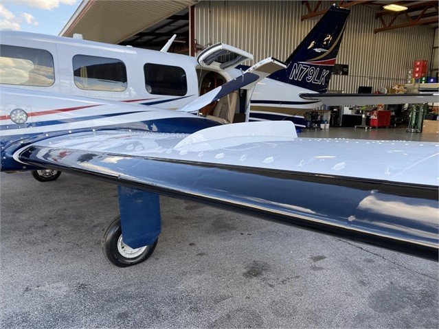

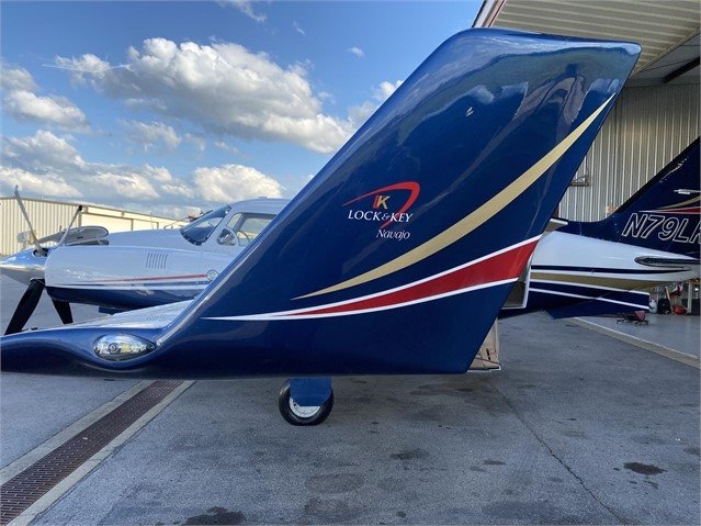

The BLR STC for a PA-31 increases the gross weight but does not lower the stall speed.
John, the "Panther Conversion" STC includes both winglets and vortex generators (with stall fences). Each individual STC for winglets and vortex generators states that the installer has to determine whether or not they are compatible.
Mike Jones will only put winglets on a aircraft that does not have vortex generators unless he does the full Panther conversion STC.
