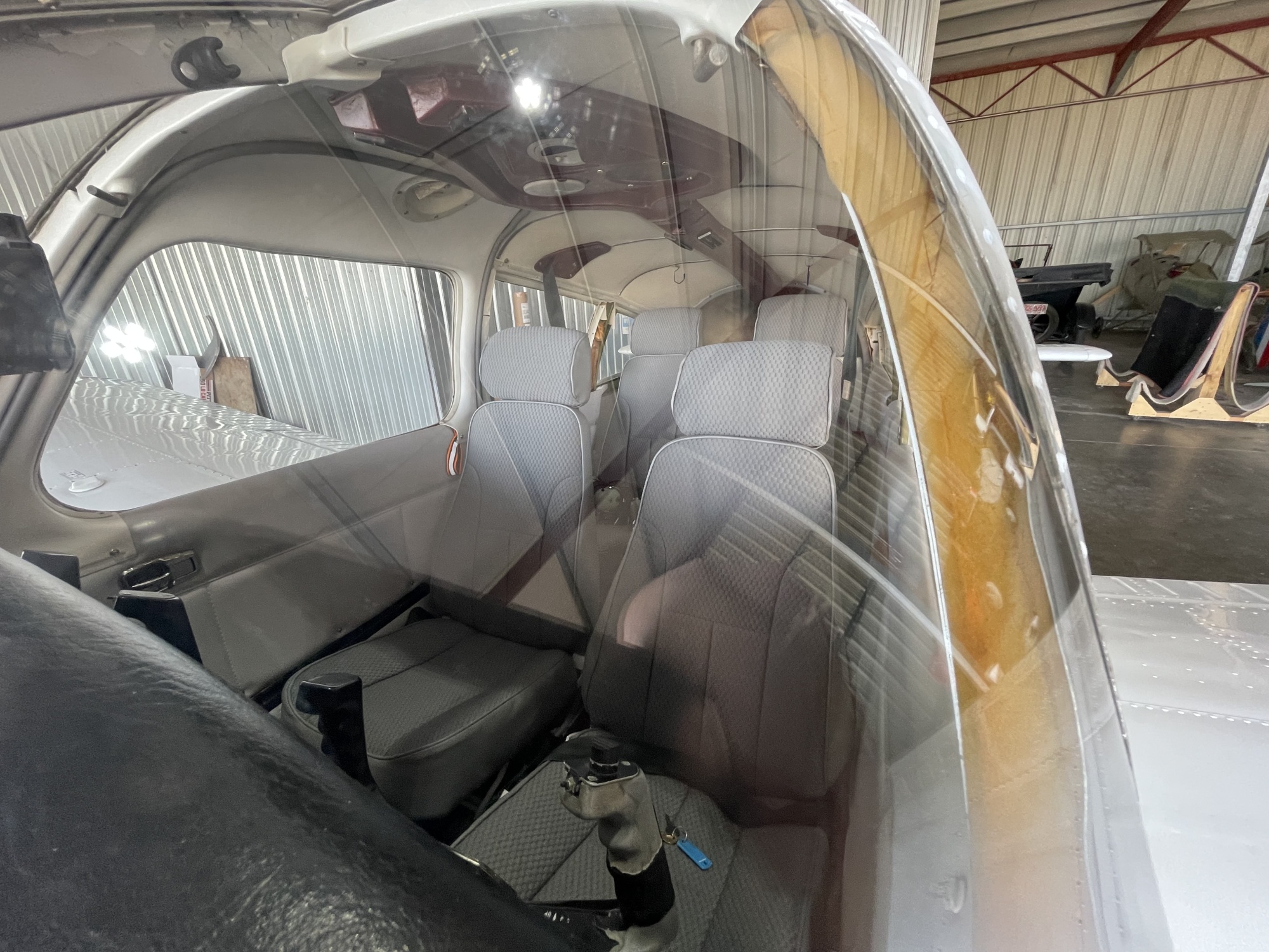

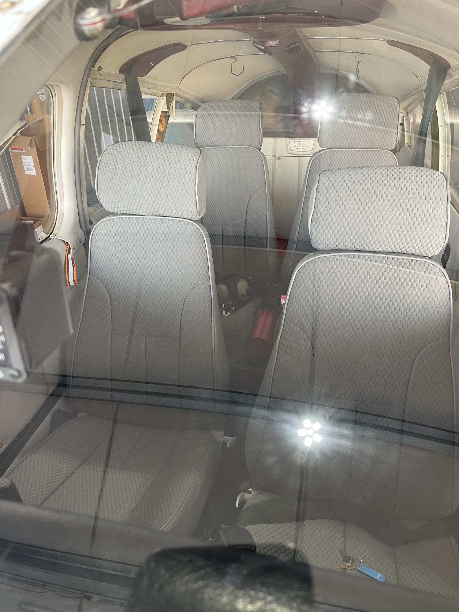

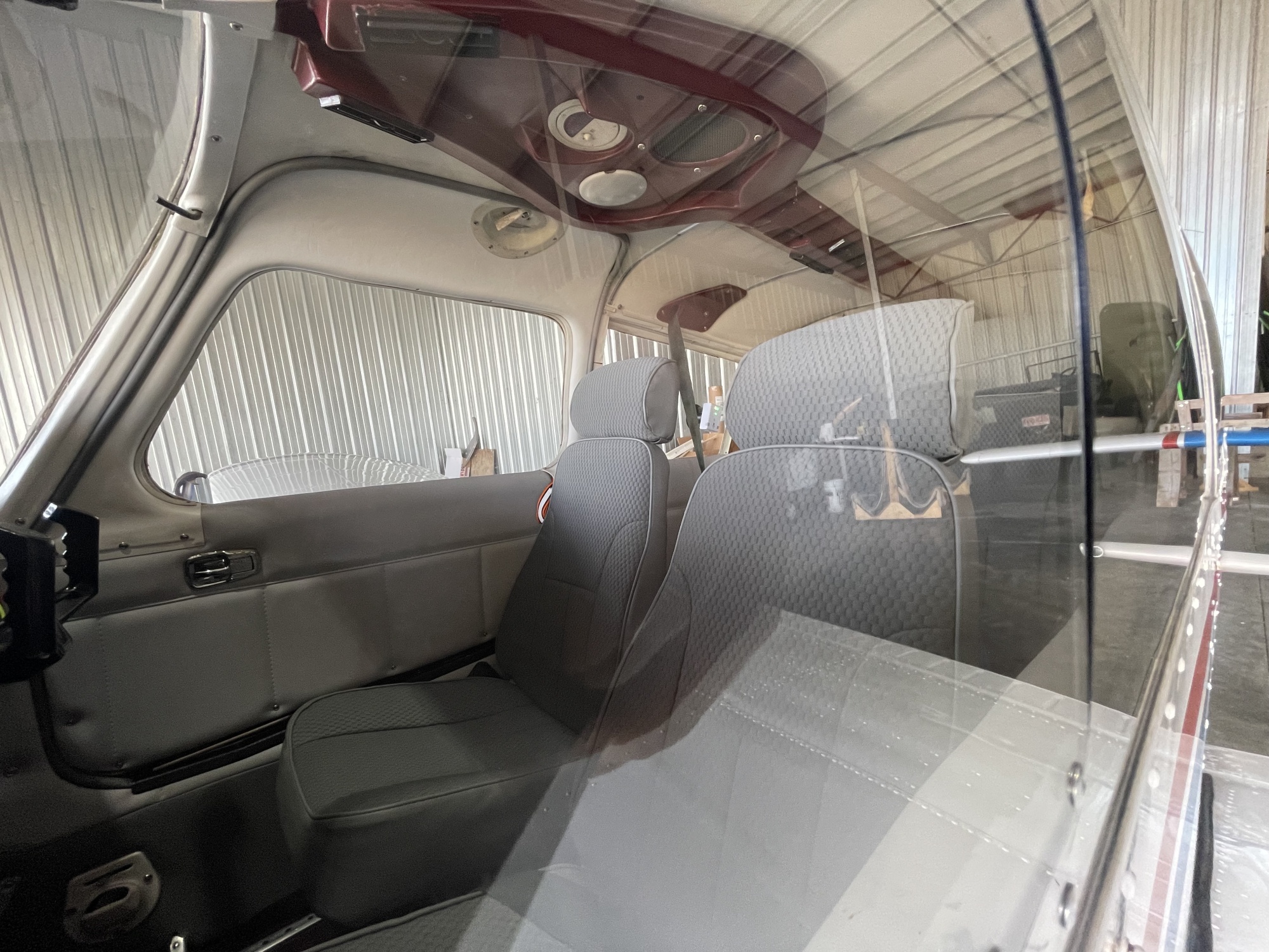

    I am just finishing up the interior. Somethings went perfect and some things were a little more difficult. But I am posting a few before pics (you can see the cushions we were sitting on as the webbing gave way and we were sitting on the frame). And the new interior with just a few shots I took today. Still a few more minor things to finish up. But it looks a bit better that the 50 year old interior that was there. See pics in the next post, I messed up the upload!
