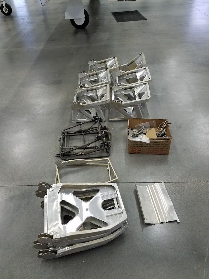

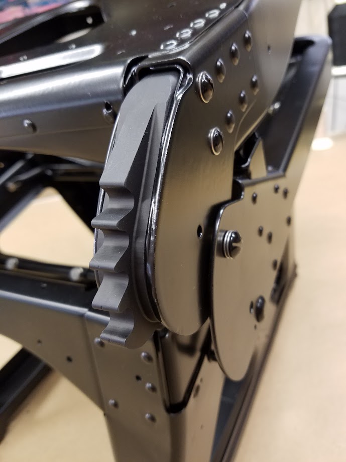

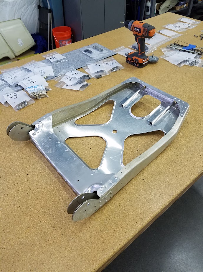

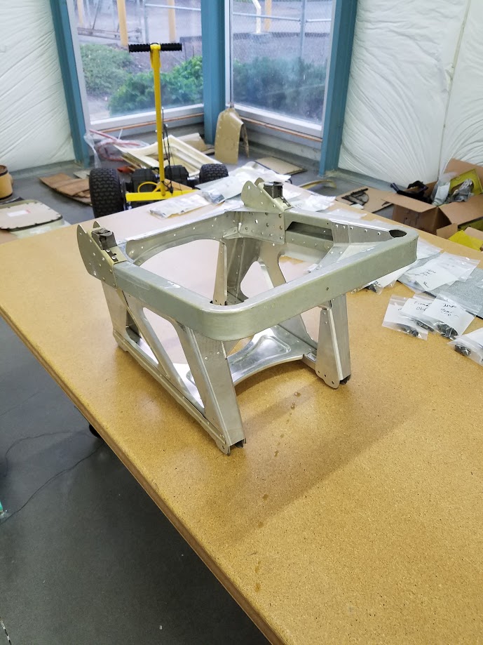

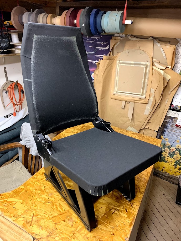

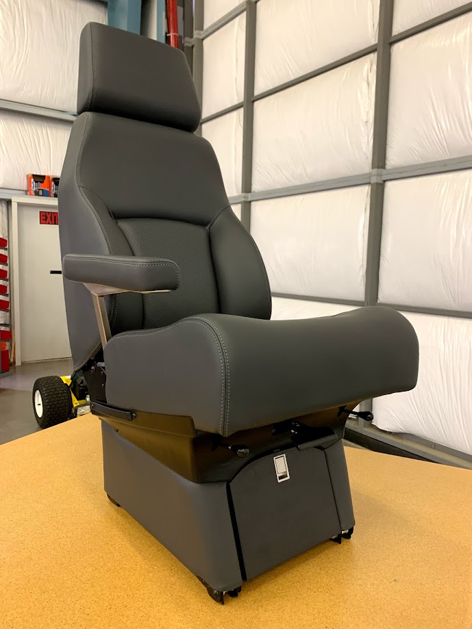

VFRs,

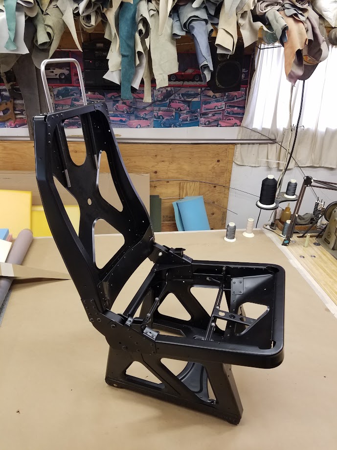

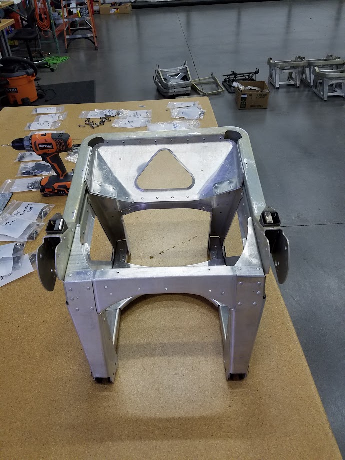

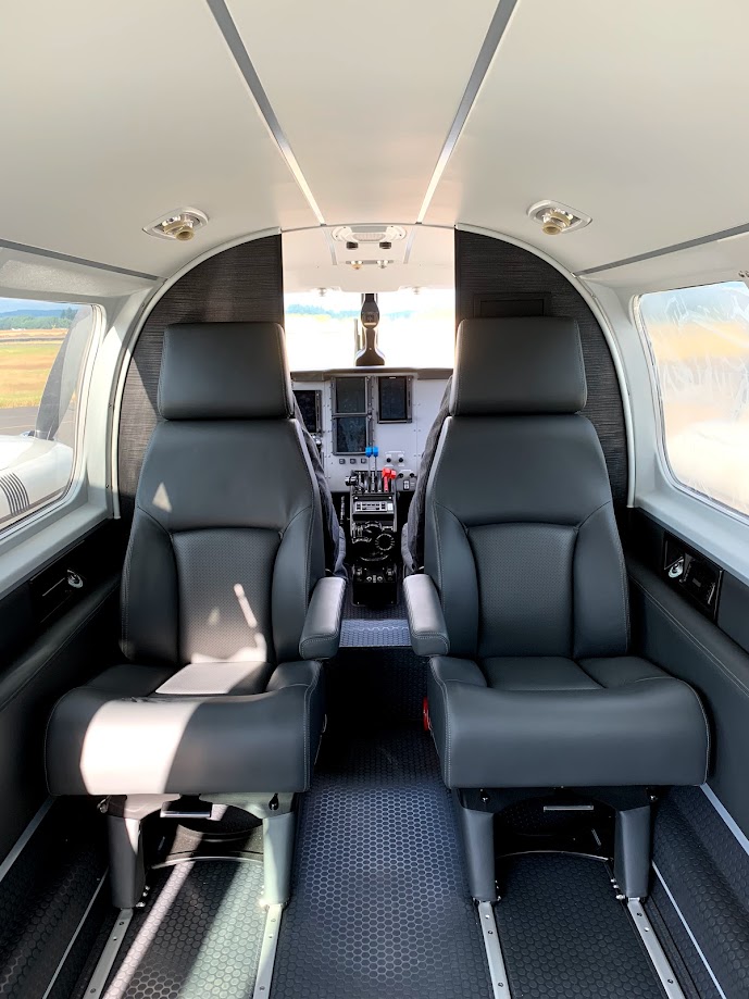

I decided to go with powder coating for my project. Professionally stripped all components, powder coated, new hardware and plastic, then covered. Tedious but the result is very nice.

Wow, beautiful job!
Absolutely gorgeous!
