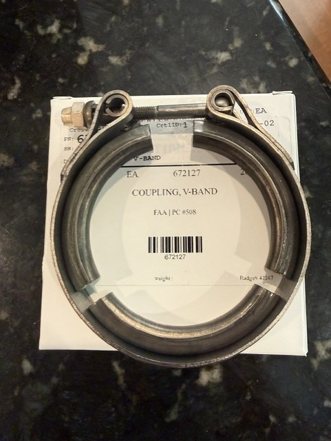

Found clamps, this place had 48 of them in stock as of a few days ago but I know many have been buying them up. They are not 8130, but a Form 1 from Canada. According to everything I've researched a Form 1 & 8130 are reciprocal. This is for the Turbo arrow clamp.

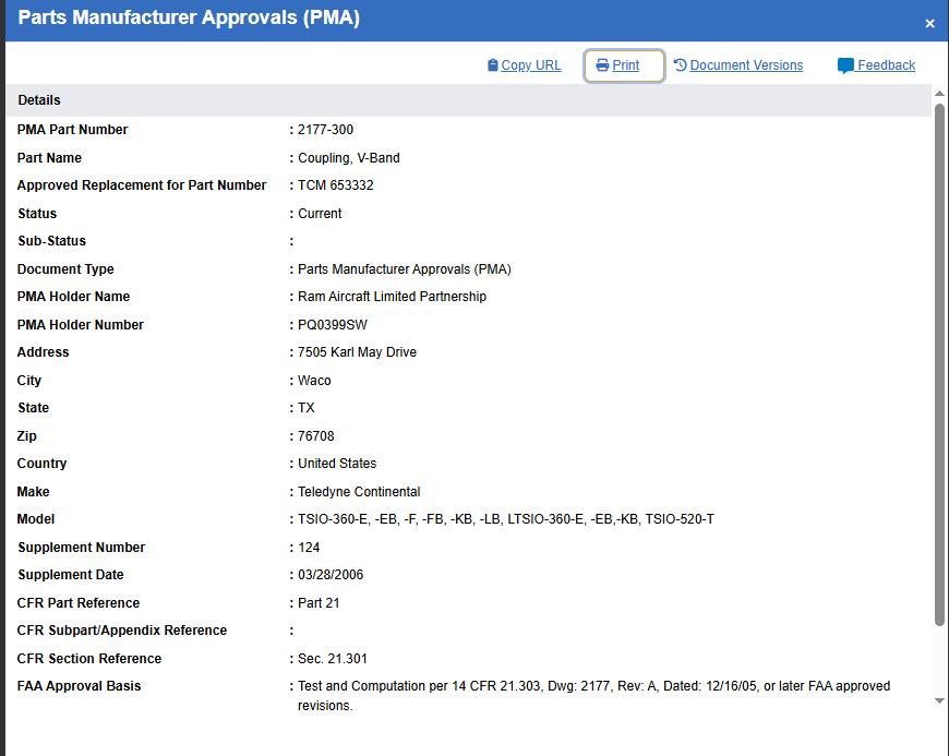

Some of us will be coming up on the 500 hr TIS, me included on my Seneca. So I called the Aero Mach Company AZ was kind enough to post the other day. Thank You AZ!
I spoke with Mr Marvin and have 2 headed my way via UPS.
I asked Marvin about the Backorder issue many Piper Owners are having with this part. He mentioned there is some confusion on this part based on a different, but suitable sub, PN. He has had this part in stock for awhile now.
RAM published a SB stating that PN 24540-300 is approved to replace PN 653332.
My IA looked all this over and concurred, ordering some for his Shop.
Marvin says he has over 100 in Stock. They do run $510 each. He says they are New and are the “Spot Welded” type.
Attached is the supporting RAM document.
I’ll update when the parts come in…
I know this has been an issue for Piper Pilots for awhile now, hope this helps! Thanks again AZ! 👍

If we use the RAM 2177-300 as a replacement per the SB, do we have to file an AMOC document? Or does a simple log entry suffice?
Submitting an amoc to the FAa is not automatic approval. While it's possible for your local FAA office may be able to approve it within a reasonable amount of time most likely they would have to send it through their engineering groups. And you can imagine how much time that's going to take. More than likely they going to look at it ( your submission) from the point that parts have started coming into the pipeline so they're not going to stick their neck out and do a additional paperwork for a one-off deal. Carl
So does that mean the 24540-300 clamp above can’t be used without AMOC approval? And your comment about parts in the pipeline is incorrect- I ordered mine July 2023. Last weeks discussion with Boeing and they are nowhere near shipping. They have hundreds of back orders on those.
Well rayjay has the clamps that we need for the turbo Saratoga with the Ray J's on it so parts are in the pipeline and some people are getting clamp's apparently from RAM as a approved replacement.. so in a nutshell any clamp you get needs to be the OEM part or the approved substitute for the OEM part. As mentioned you might get your local FAA office to approve it but I would definitely not count on that and you can't ask your mechanic to put on a non-approved part while you're waiting for an amoc which could take quite a while. Carl
