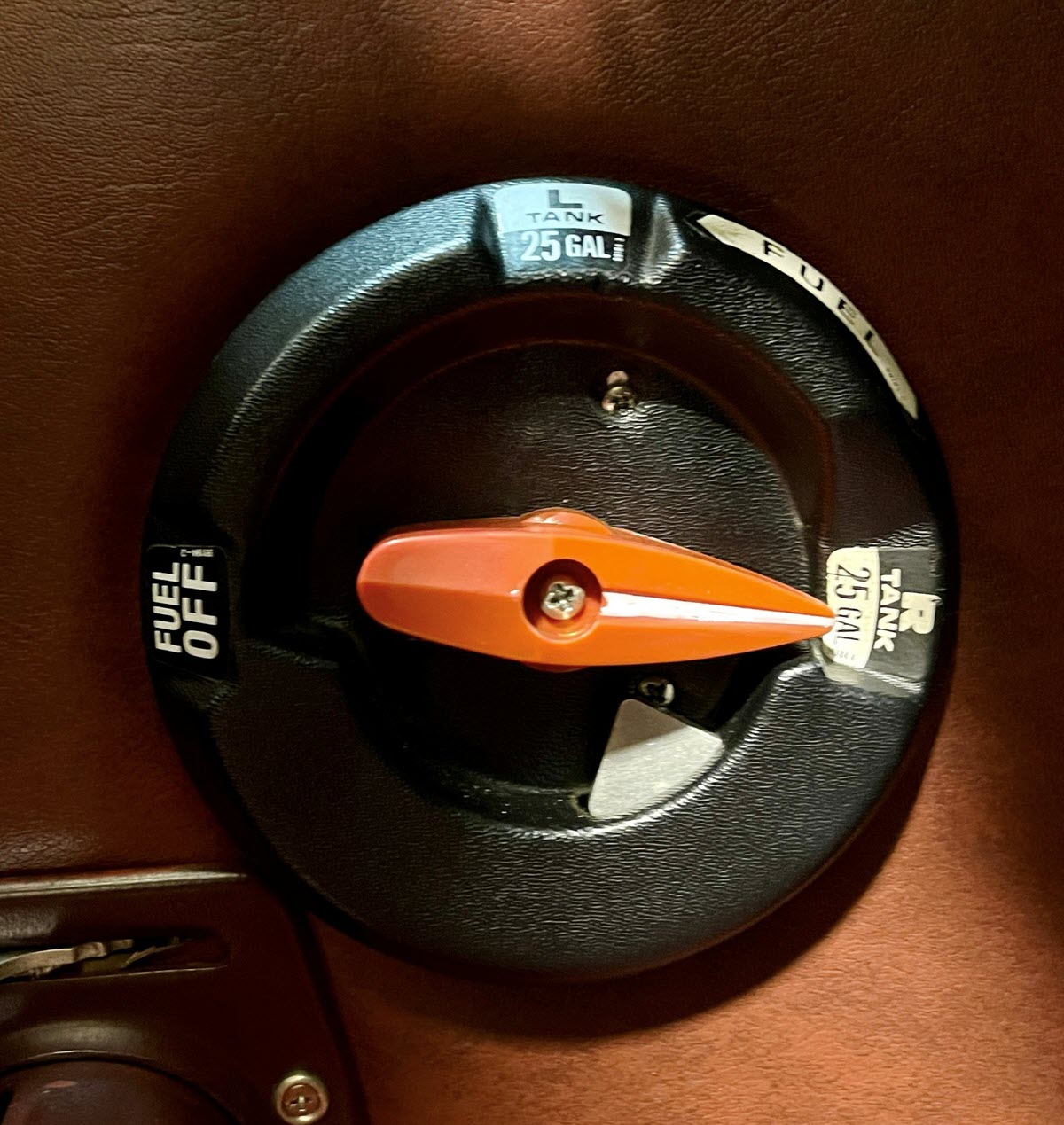

Some minutes into the flight you release the controls, just for a moment, to check the trim. Altitude is right on and that brings a smile to your face but wait… What?… The aircraft is in a gentle (or not so gentle) left hand turn and, of course, hands-off you are now losing altitude! A quick glance across the panel shows part of the problem. You have a quarter tank less fuel on the right side than the left, and fuel weighs about six pounds per gallon! You also remind yourself that you are the only occu­pant in the airplane, on the left side. You quickly bring the wings level again realizing you must have been holding them level for a good portion of your flight; extra work for you and not fuel efficient. Okay, so you switch tanks knowing the situation will improve as the fuel quantity and weight left and right equalize but what about that empty right seat?
This situation is par for the course for most Piper Cherokees and other aircraft that do not have a BOTH position on the fuel selector! Even if there is one, as in most Cessna aircraft, lateral loading is still an issue. Do you have a passenger? Maybe they weigh more than you? Do you have baggage favoring the left or right side of the compartment? Do you have a back seat pas­senger and, if so, which side are they sitting on? Is your aircraft rigged to fly straight and level in calm air? This issue is not re­served to hand-flying the aircraft. If you are using an autopilot, in out-of-trim conditions, it will be working overtime as well!
