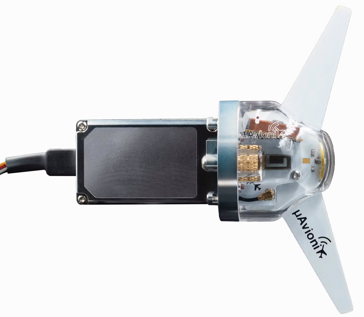

uAvionix skyBeacon
The skyBeacon uses UAT (User Acceptance Testing) technology and works with a standard Mode A/C transponder to meet the ADS-B mandate. Priced today at $2,199, it mounts on your port wingtip and simply replaces your existing red position light and includes a strobe light. It utilizes the original wiring (in most cases) and installs quickly, often in just two to four hours.

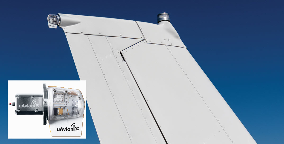

tailBeacon
The tailBeacon was certified in 2019 and simply replaces your white tail-position light, again, using the aircraft’s original wiring. Like the skyBeacon, the tailBeacon has an internal WAAS GPS, encoder and position light (no strobe) and provides ADS-B Out via UAT on 978 MHz. It is also priced at $2,199 and is even easier to install.

tailBeaconX
The skyBeacon and tailBeacon were created for the U.S. market where a UAT solution is legal. Everywhere else in the world, the Mode S transponder with ES (extended squitter) is required. In addition, some countries (like Canada) have decided that an ADS-B solution must have diversity with dual (top and bottom) antennas. uAvionix again came up with a solution in 2021 that meets these requirements and is easier and less expensive to install. The tailBeaconX replaces the aircraft’s rear position light and can be controlled through an EFIS unit or from the uAvionix AV-30-C, AV-30-E or AV-20-E electronic flight instruments. The tailBeacon X is $2,499 for interface to a compatible EFIS or available in a bundle with the AV-30-C for $4,798. Installation is simple and fast and saves literally thousands of dollars versus alternative Mode S systems with diversity.
