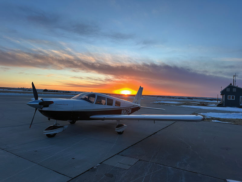

The mystery of why the Cherokee Six I was flying that night had accumulated so much static electricity was solved when I returned to the Vichy airport a few days after the snow storm had abated. I was supposed to ferry the Cherokee Six back to Fort Leonard Wood solo as a positioning flight.
While doing my preflight inspection in bright sunshine, I discovered that both of the bonding straps that connected wings to the the ailerons were broken. These ¾ inch wide braided steel straps were designed to bleed static electricity from the wing to the ailerons and then to their sharp trailing edges where it would be disapated into the slipstream. This setup was used in lieu of static wicks, which did the same thing, only more efficiently.
With the straps no longer connected to the ailerons, static electricity on the wings could not be bled off. This is what caused the giant spark that leapt from the windscreen to the top of the instrument panel, causing the Saint Elmo’s Fire to occur.
