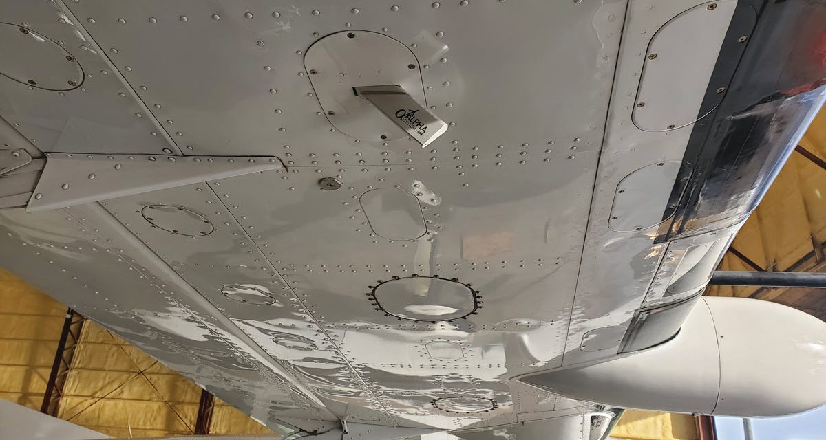

This is the more common approach to AOA/reserve lift that we see today. AOA/lift reserve systems that operate this way use a single probe, mounted in clean air – typically under the wing on single-engine aircraft or on the nose of a twin.
The probe has two ports and measures differential pressure. It then reports it to the IM (interface module) and to the indicator. The DP approach requires plastic pressure lines to be run between the probe and the processor. A number of manufacturers are now offering DP AOA/Lift Reserve systems for installation in certified aircraft.

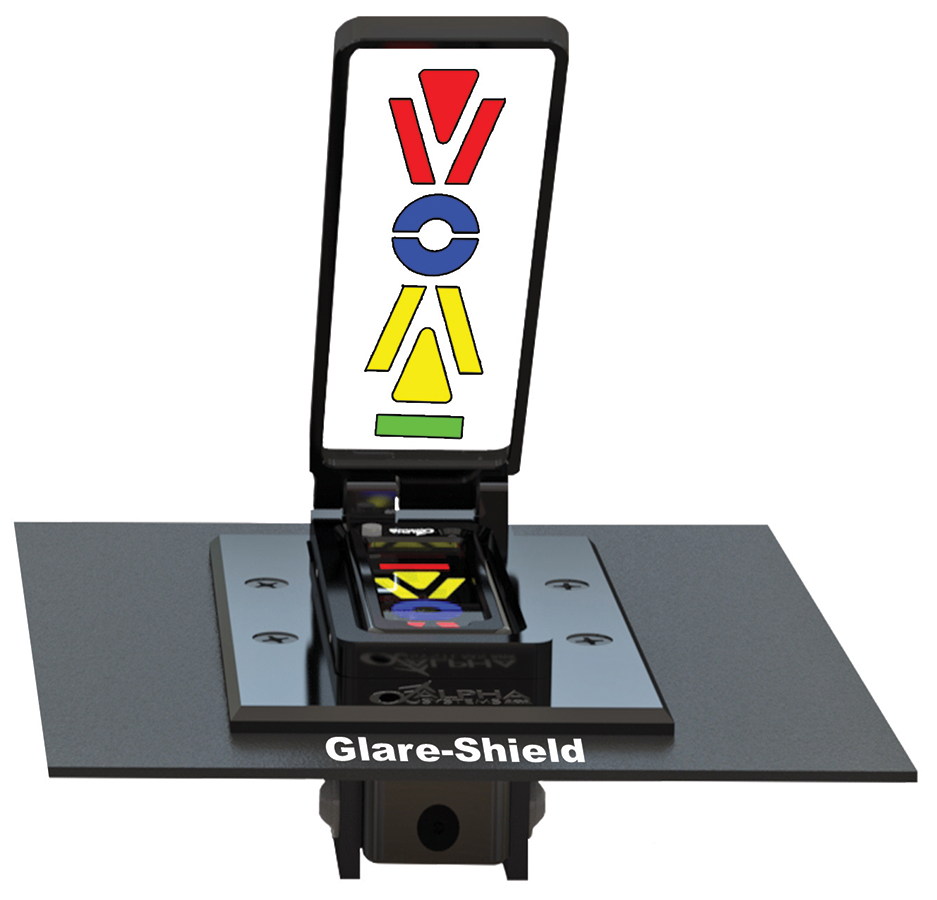

Alpha Systems AOA starting at $2,550
Alpha Systems (www.alphasystemsAOA.com) offers DP AOA systems for certified aircraft. They have a system for non-pressurized and pressurized aircraft and a wide variety of display options including a heads-up display (HUD) option. In fact, Alpha Systems has played a significant role in developing display options for AOA. An optional heated probe is also available. Their AOA systems start at $2,550 with three display options and they have a system for two-pilot applications. Alpha sells direct, so you can order from their website.

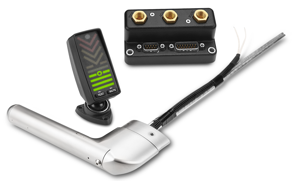

Garmin GI-260 Angle of Attack at $1,595
Garmin’s GI-260 AOA system (www.garmin.com/en-US/p/149850) uses their GSU-25 Air Data Computer (also used with their G3X EFIS system) and a DP probe like the other systems above. The standard GI-260 system is $1,595 ($1,695 with heated probe). One display is available with different mounting options. Sold only through Garmin dealers.
