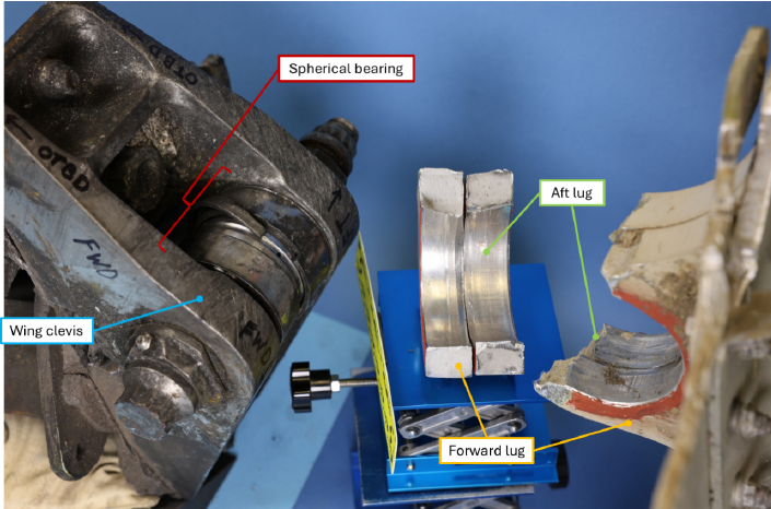

Based on the NTSB report (which you can find here: piperowner.org/MD-11), examination of the fractured left pylon aft mount lug, demonstrated evidence of fatigue cracks in addition to areas of overstress failure. A fatigue crack was also found where the aft lug bore meets the aft lug forward face (see page 9 of the report).
There is detailed information regarding the maintenance and inspections of this plane in the NTSB report as well. This is a preliminary report and subject to change as more findings surface.
