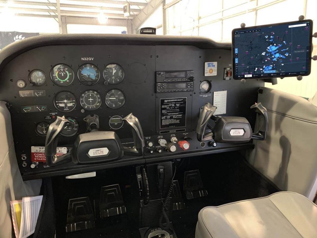

IPad mounts
Let’s face it, the iPad or smart tablet is practically standard equipment in most legacy aircraft. If you’re still using it as a kneeboard or mounted on the yoke, maybe it’s time to come up with a mounting option that makes better sense. We know that looking down at a kneeboard and back up can be a prescription for spatial disorientation so it’s not a great option in IFR. For me, something heavy on the yoke took some feel away. Many aircraft have enough room on the right side of the panel that a creative mount option may be a good place to secure the iPad. I think one of the best sources for this information is Sporty’s iPad News, a website dedicated to using a smart tablet in the cockpit. Here’s the link: ipadpilotnews.com. Click on Shop, then Mounts and you’ll see a ton of mounting options for your iPad or smart tablet.
