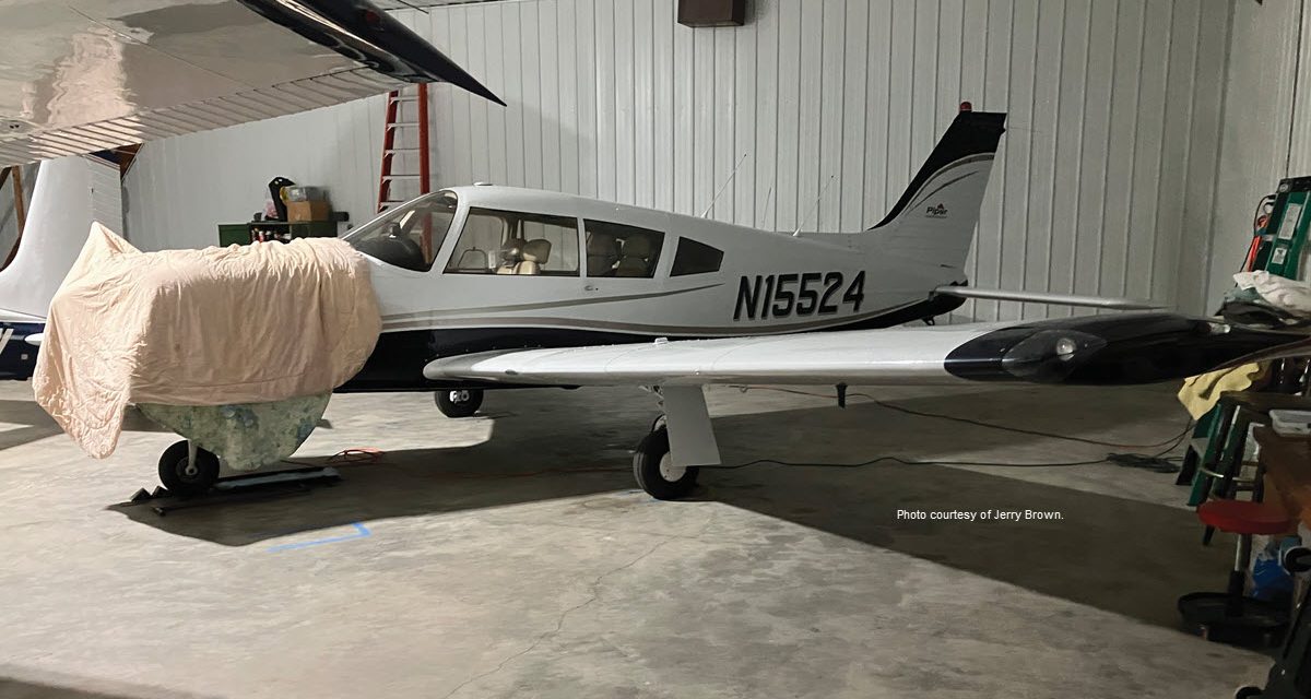

Talking About Storage
If you are going to make your plane into a Kakapo (which is a large, nocturnal, flightless, lek-breeding parrot from Australia and considered a real oddity) you need to make plans to “pickle” your plane. And if you are wondering what “lek” means, the Australian male parrot hangs back and lets the mate make the advances. Which is kind of what your aircraft is doing, waiting for someone to get it out of the hangar and take it for a “dance.”
Anyway, being in a “storage state of mind” means parking your aircraft for anything over 30 days. Now you might be saying, I do that right now and I’m not in a “storage state of mind”, well maybe we need to talk about that. Many people feel they can just let their aircraft stay in the hanger for days on end and not have any issues. The thought is “no fly, no problem”.
Personally, I think that is a problem. An aircraft that has been parked and has not had a few minor things done deteriorates quickly. Cables get stiff, rubber parts dry out and then the whole neighborhood goes to heck. Mice move in quickly, in a matter of days. Wasps and mud daubers start colonizing in hours and before you know it there’s no room left for the pilot.
What Should You Do?
Plan ahead for long-term storage by starting with the engine. You need to treat the fuel to prevent it from breaking down. You also need to protect the internal parts of the engine to prevent corrosion during the extended vacation from flying. You could add corrosion protection to the oil, run briefly, and then spray the inside of the cylinders with a good fogging oil. Reminder here, I am not a mechanic, so make sure you talk to your mechanic and either follow their recommendations or have them get the plane ready for storage.
The risk of mice and bugs is where the repellent packages (or moth balls) come into play. Again, some people (my spouse) do not like the moth ball smells and I have been told they may be carcinogenic, so, use at your own risk. You do need something to help keep bugs and small vermin at bay. I have used scented dryer sheets, but I did run into a mouse that used one for a nest once, so I am not convinced they work for all mice.
You might also make sure you have shields on your gear legs to prevent mice from climbing into the aircraft. The shields I’m thinking of are like those metal cones used to keep squirrels out of bird feeders.
Also, block any openings in the exhaust, intakes and cowls. Not only do you block critters, but if you can block the air from getting into the exhaust and intake it helps reduce corrosion.
