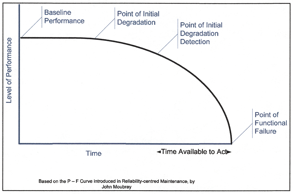

Examine Figure 1. Are you able to apply it to the landing gear hydraulic power pack situation? This chart can be used as a performance/failure analysis tool. Note that our landing gear issue is well along the curve to the point of functional failure. Using this chart, I’d suggest that the shop was trying to get the owner to act while there is still time available to act. Would you concur?

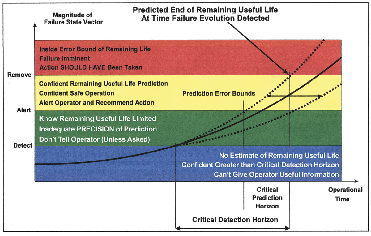

The color chart (Figure 2 above) is a very good, expanded tool to help you visualize the WHEN and IF questions of component degradation analysis. Got a vacuum pump that needs constant “tweaking”? How about that alternator voltage that needs adjustment every year, a noisy gear pump, or “I’m only .5 off” on the localizer when I am centered on the ILS. Plug these into the chart and see how close you are to a “critical horizon.” Make a copy of this chart and keep it with you as an aid in maintenance decision making.
